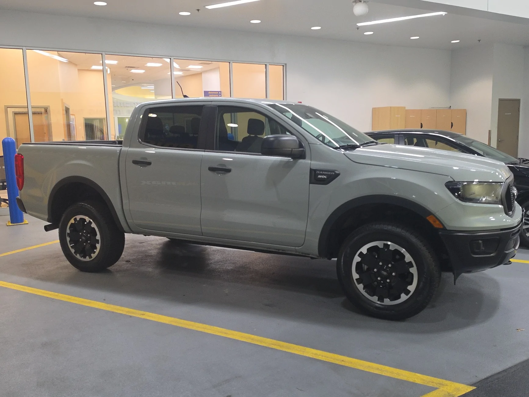

Saturday I purchased my first Ranger .. first ford really , it's a 2021 4WD Super Cew 4Door .. the truck is great , 37k miles new tires and the beautiful cactus gray color .
After driving about 60 miles I tried to use the 4wd just to make sure all was all , and after about few trys in park and neutral it wouldn't do anything , just blinked the 4H & 4L at me . I took it back to the dealer and after about half a day they called and said it had a B1402-67 code and they will have to order and replace the MSS Selector ? I also told them about the clunk on stop and go from what seems like the slip yoke needing greesed .. has anyone experienced this in a End of April to early July 5G ? (My built date is 04/30/2021)
After this is taking care of .. do I look forward to good times with the truck or continued problems ?
Thanks for having me & please don't hesitate to share similar story's or tips and tricks about the 5G .. thanks ,

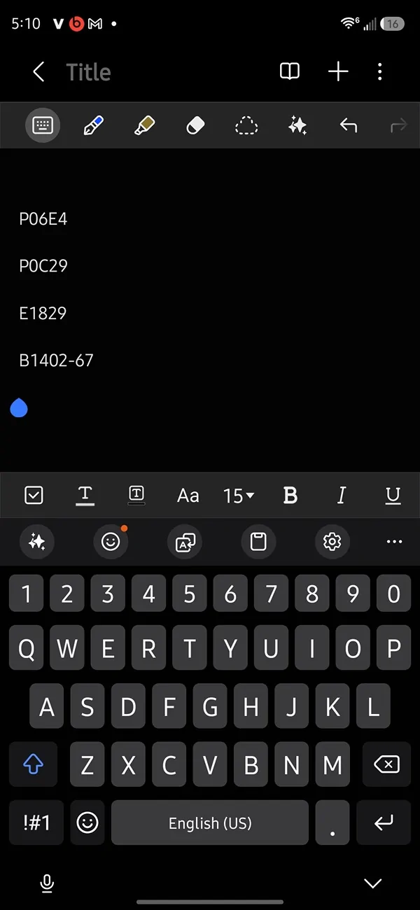

Dealer came back and said my truck had these fault codes .. do you guys think this is from a battery going bad and causing the CANbus to not work properly ? Makings the 4wd selector (MCC) blink or could this be the TSB21-2412 ? They keep telling me I can have they're loaner car till they figure it out .. I just want the truck back .. so lost
