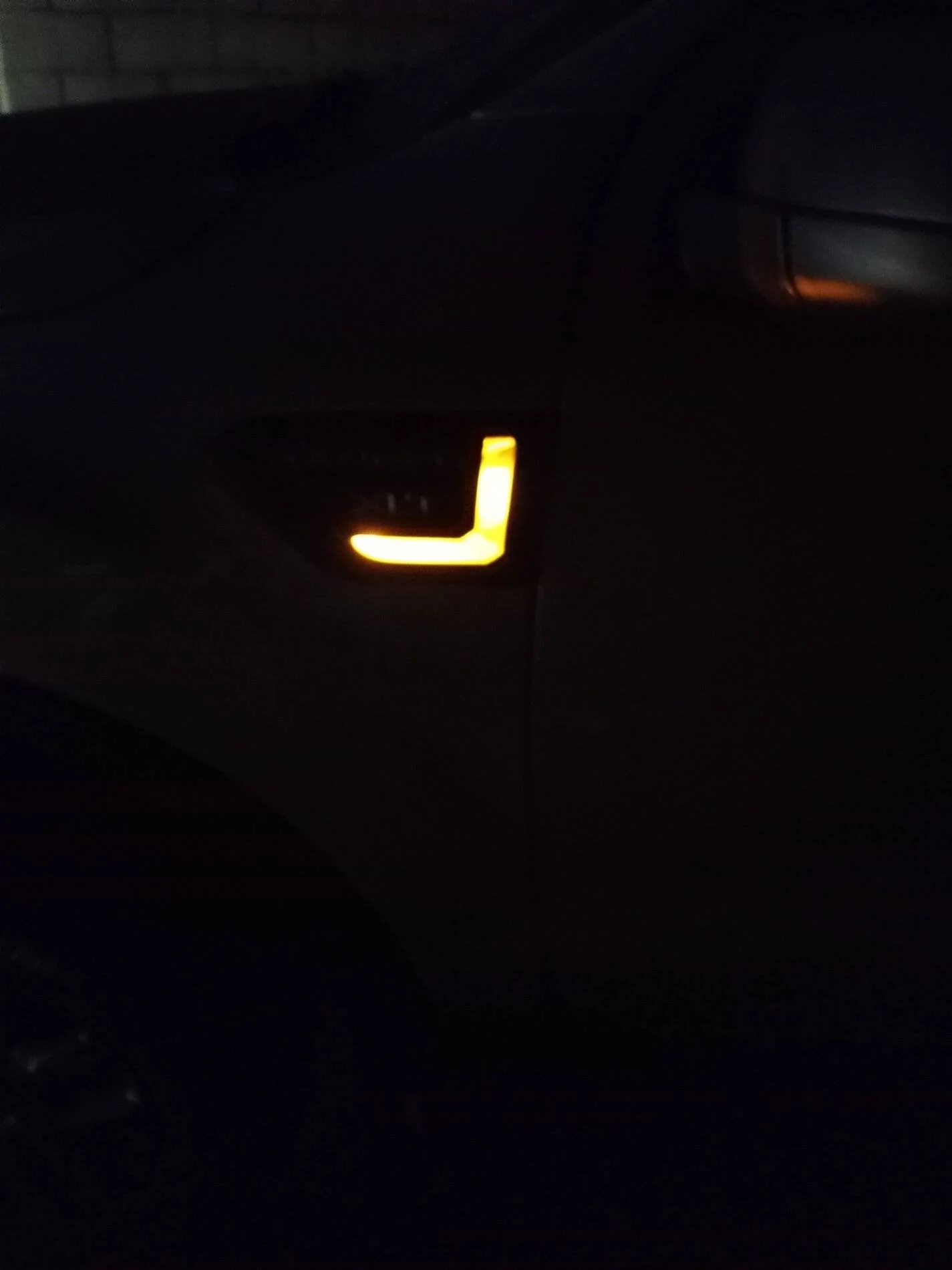

The leds are from aspect led. 36 leds per foot, had to buy a whole reel. They are wired to the headlight turn signal/ marker light. I bought a 10 pack of water proof connectors from Amazon so I could keep everything separate. The light genie reduces the power 30 percent when the turn signal is on. I originally bought a set of black fender vents but the magnetic metallic diffuses the light better than the gloss black. The vents pop off pretty easy. They can be taken apart with a small flat head screw driver by popping off the melted over plastic tabs on the back of the vent. I had to drill a small hole in the corner of the vent you cant see it once everything is together. Once the leds were installed I soldered a connector to the wires, put the outer cover back on and used a drop of supper glue on each of the tabs. Routed the wiring harness I made over the wheel well liner, tapped the light genie into the turn signal and parking light wires plugged all the connectors together and made sure everything worked.
Want to sell me some of that reel? Sounds like you might have some extra. This scratches my itch for turn signals in the mirrors and looks dope. I think I have the magnetic gray vents because of the Tremor. I'm running out of projects, this would be perfect!

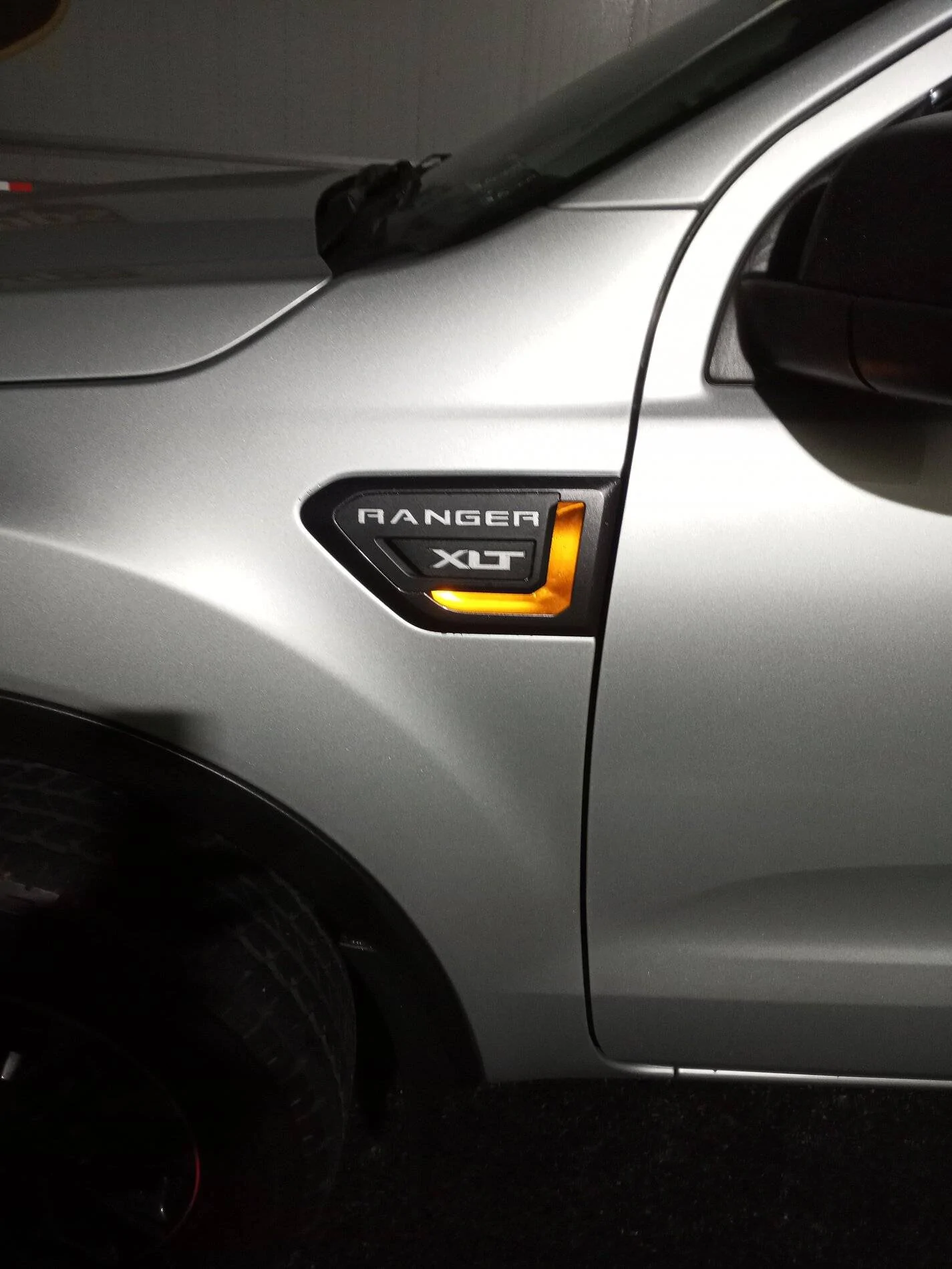

Popped off fender vents and installed some amber led's. Used some light genies found on ebay so they flash with the turn signals.
