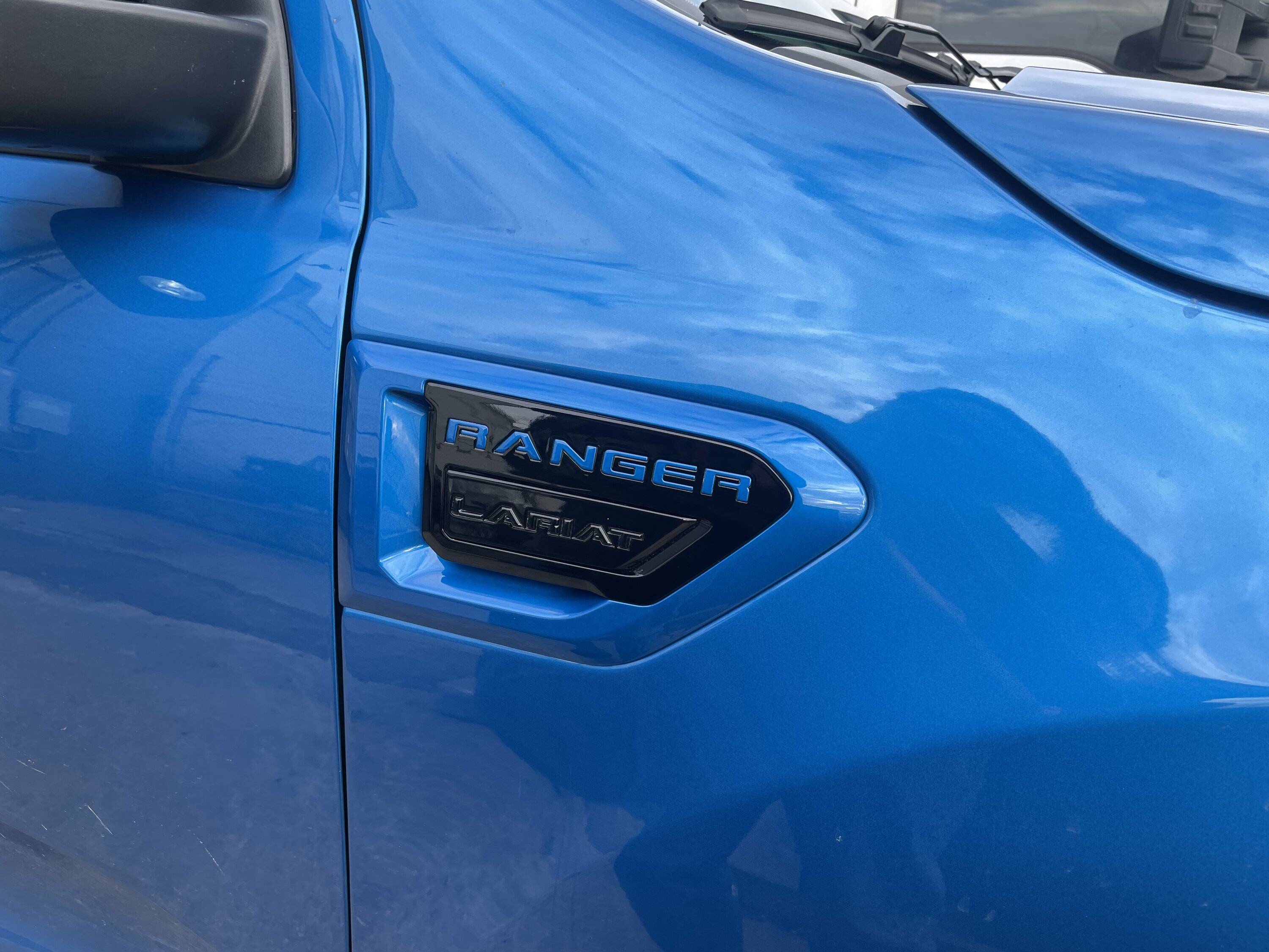

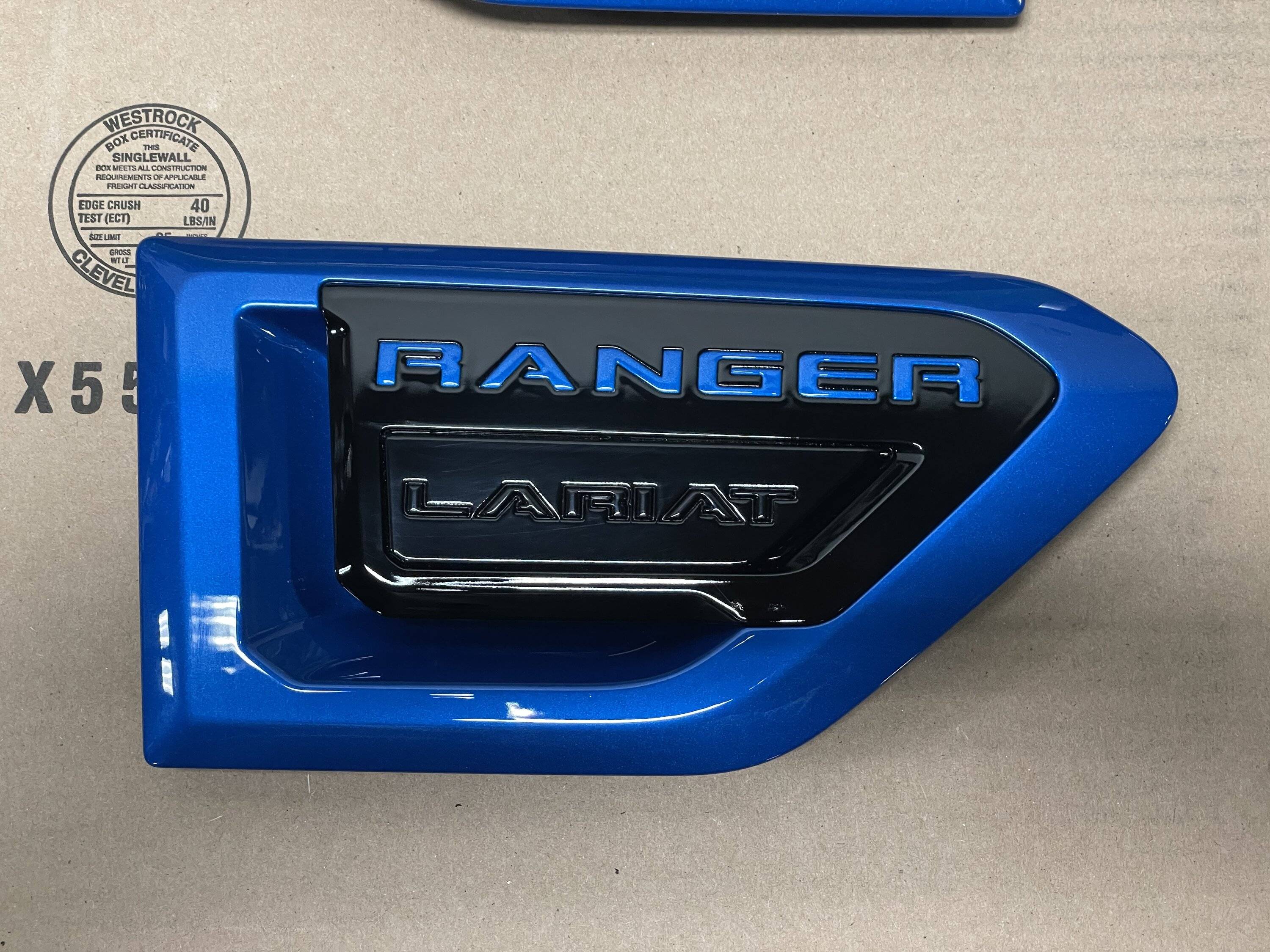

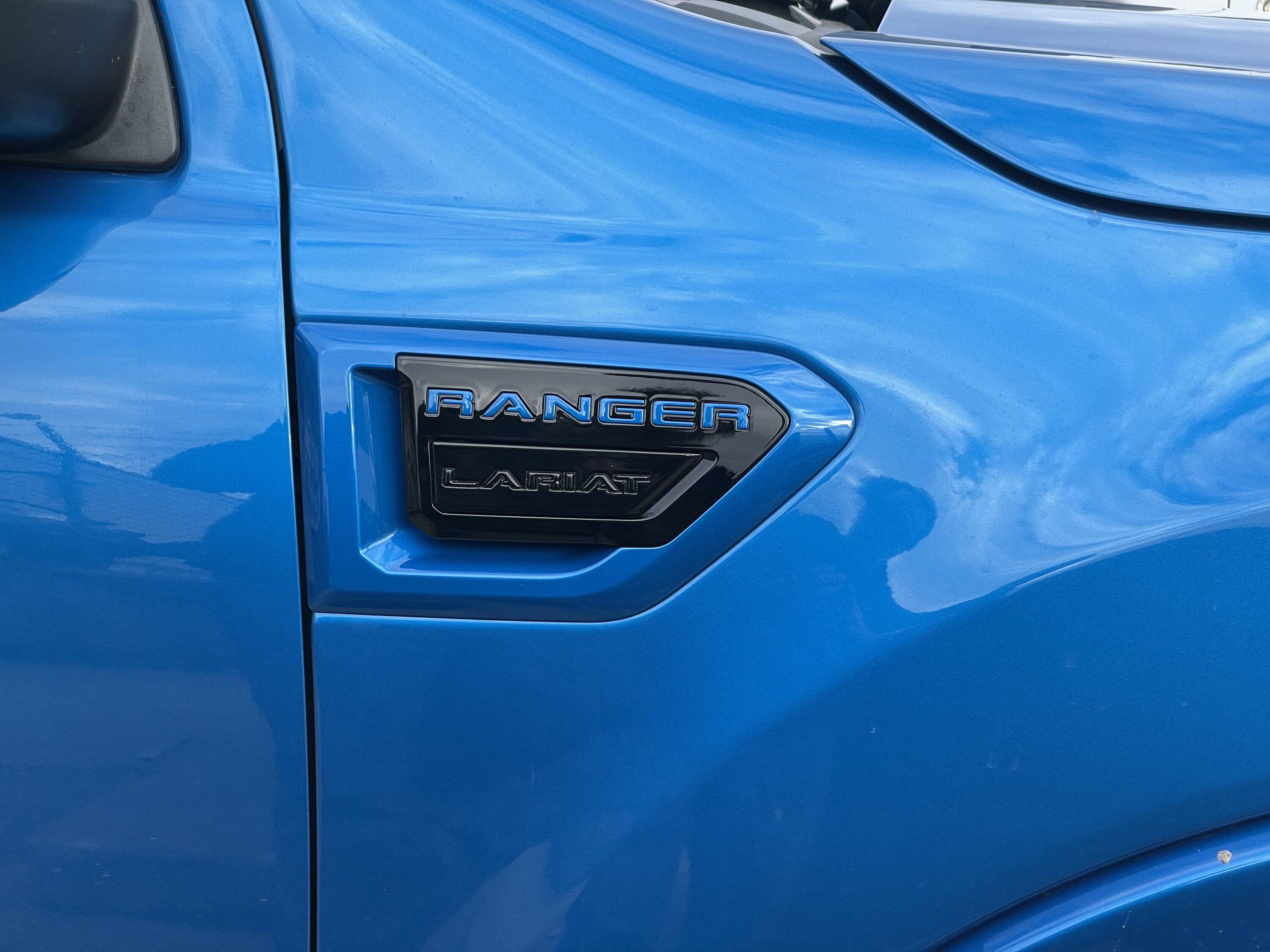

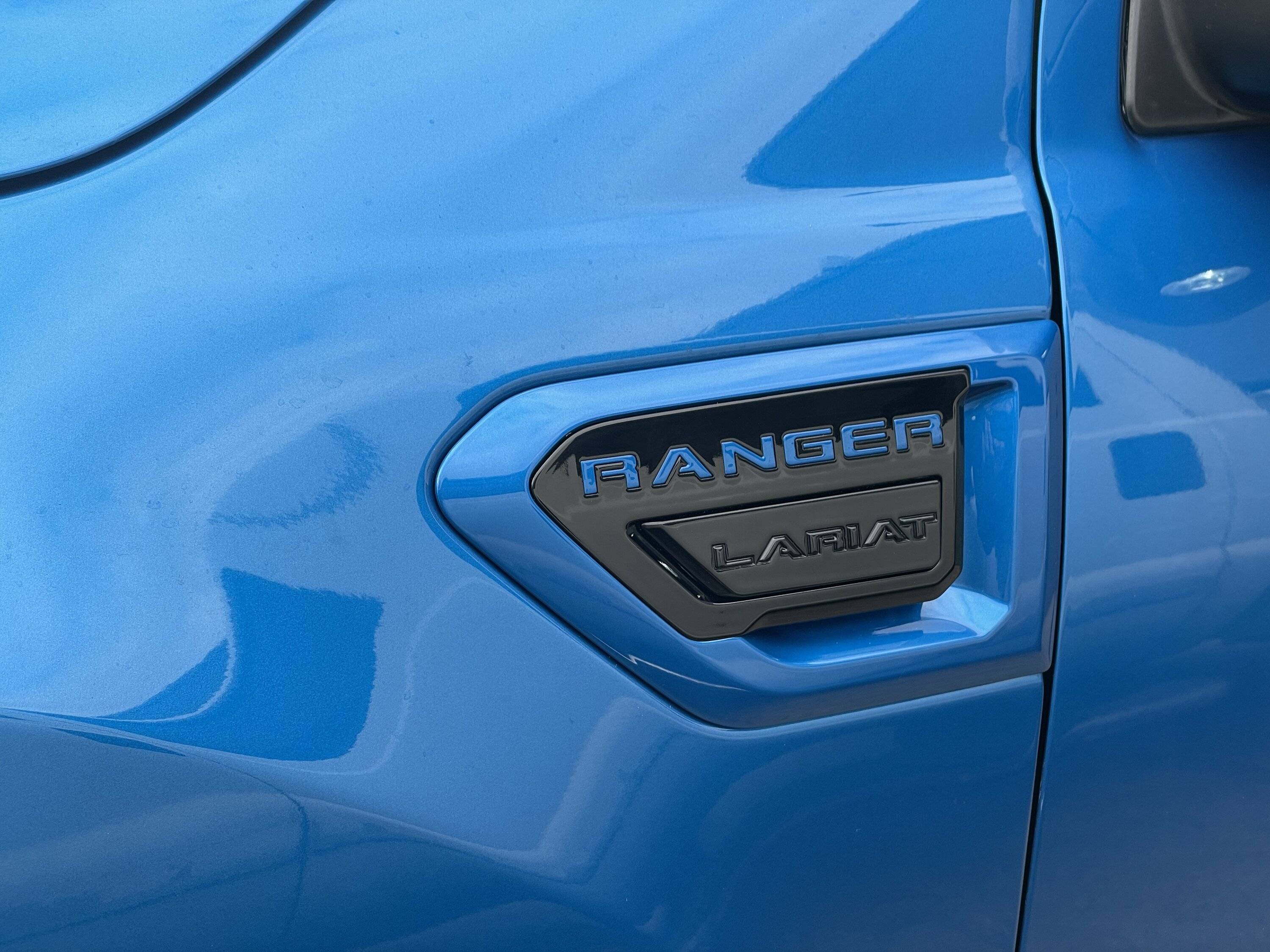

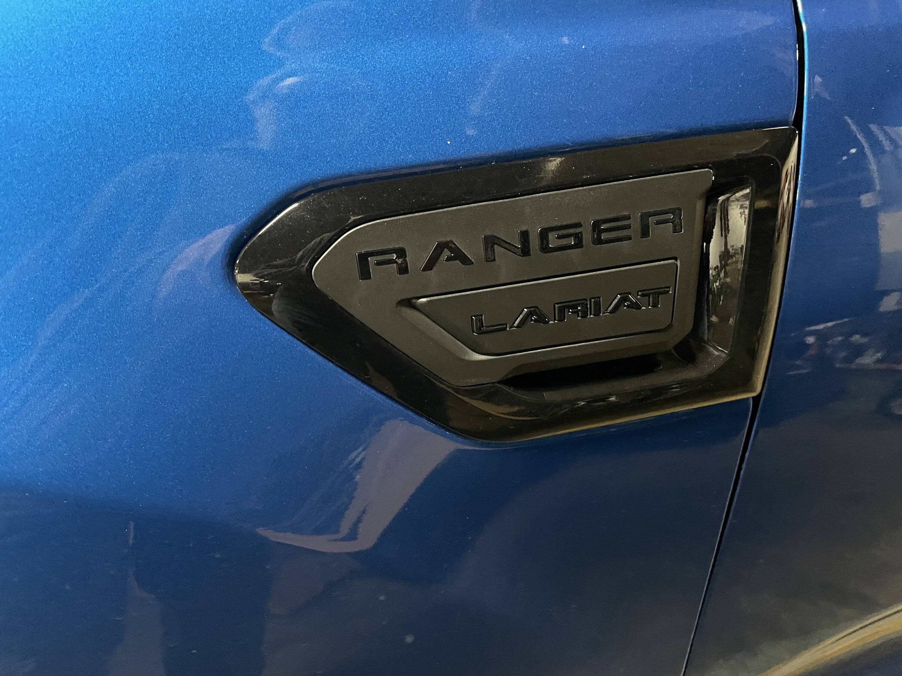

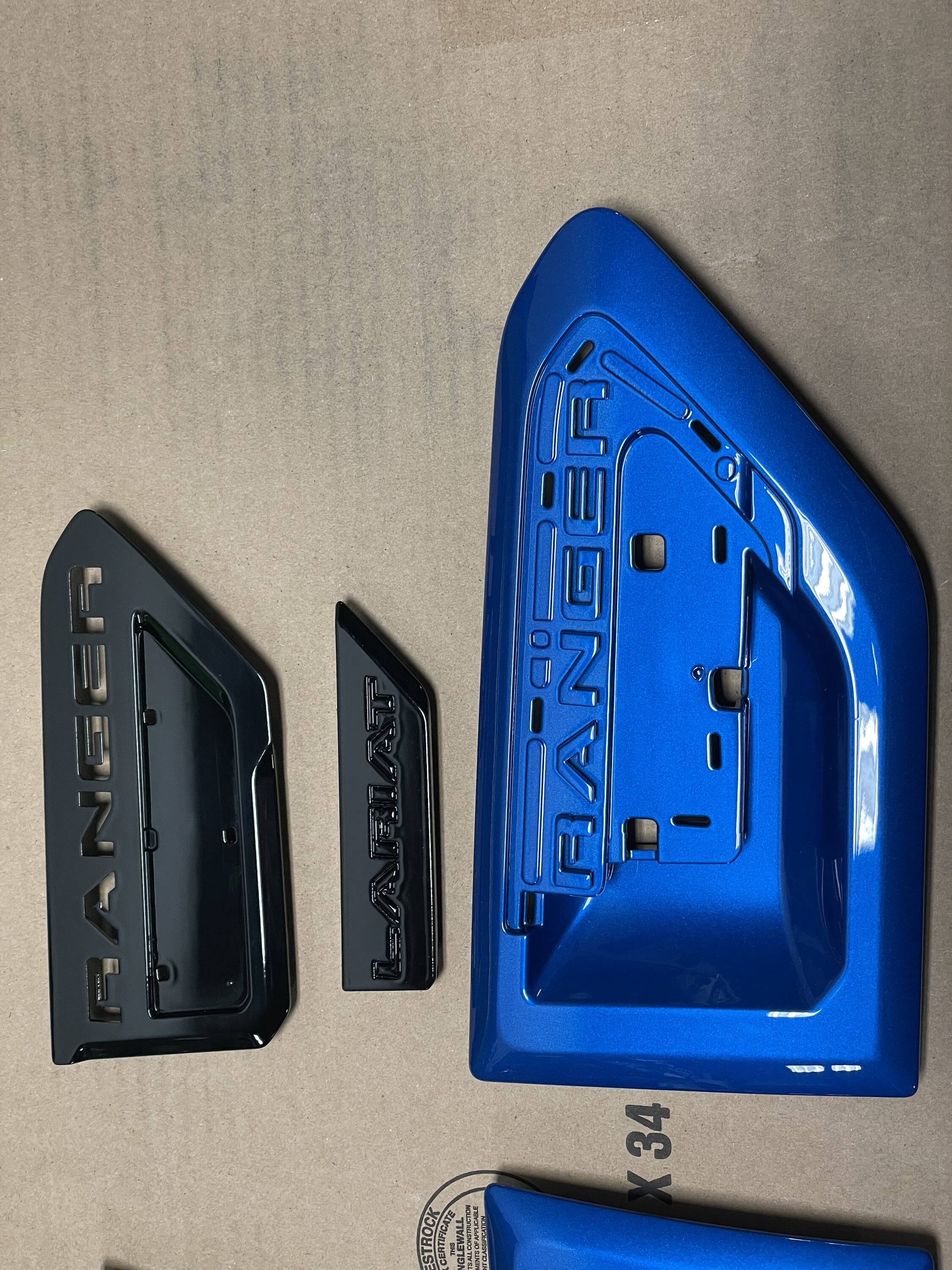

I disassembled my vents and had them repainted. I’m pretty happy with how they turned out.

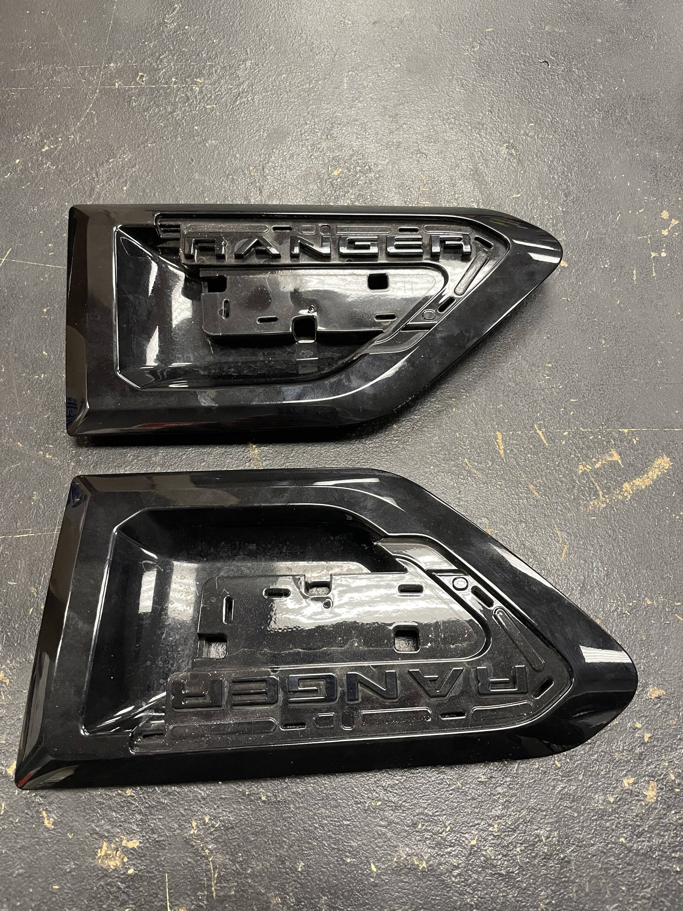

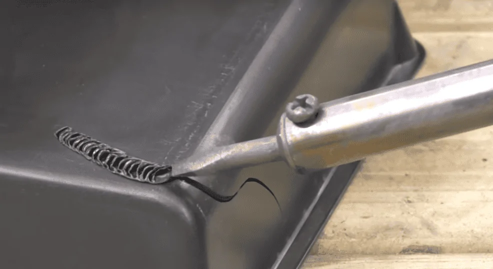

It was pretty easy, RTR vehicles has a great video on removing them. Soft pry too and a little tape…. Popped right out. Once off I used a small butane torch to soften the plastic welds while gently pulling everything apart. After painting it all went back together easily. I melted the tabs back together with a soldering iron. I own a plastic welder but I didn’t see a need for this.

Those look nice, but I think you should do something to highlight 'Lariat".
I’d rather it not say anything. Same with the Ranger text, it says Ranger 5 times on the outside of the truck alone. At least it only says Lariat twice but I still wouldn’t mind having no words.
