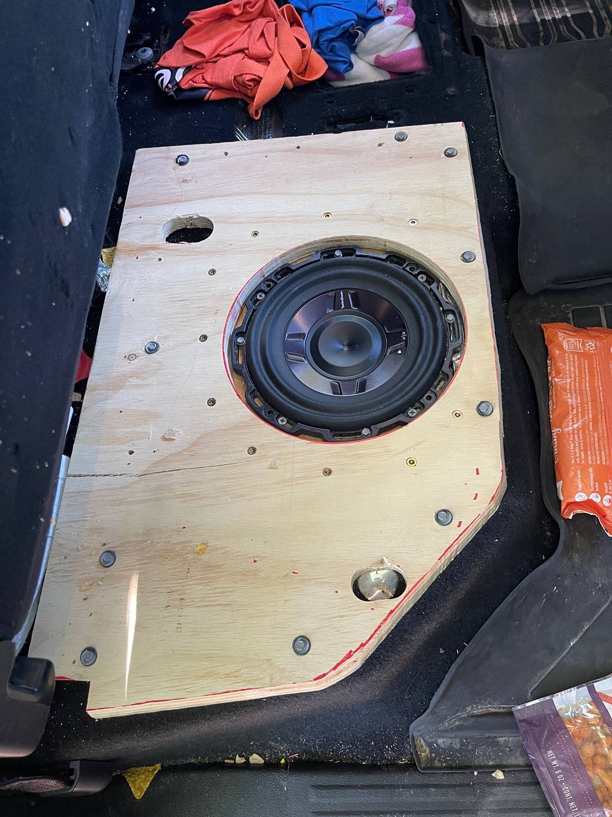

I decided I'm going to let the "professionals" handle the installment for all the audio except I made my own box for 2 Kicker 8" L7T's to sit behind the back seat(I have dimensions if needed/interested) I will have to recess the subs. I could have fit bigger subs but I figured since I plan on adding 2 more under each front seat it would be easier with 8" subs.
Besides that I have a question. Will the subs be okay up against the back seat?

i have a 10 inch rockford behind the seat with no problems

A single 10, 12, and JL's 13.5 would fit no problem but since I wanna add more subs I can fit 8's under the front seats as well. (Would be weird if I had different size subwoofers throughout the cab)

Old post but what we're the dimensions of the box you made? How did it fit? What do you think the max width would be behind the back seat (top and bottom between the wall and seat). I am looking at a powered/boxed sub package with dimensions: 24.2" Length x 15.2" Height 5.5" Top Depth x 7.5" Bottom depth. Mainly concerned about the top and bottom depth. It comes with a 10" or 12" subwoofer

15.5" tall x 3" depth on top 5.25" depth on the bottom x 24" wide, could go wider but would involve a lot more cutting/routing, this measurement is without carpeting, once you put carpet/felt it will not fit so I'd recommend you either sand it down a whole lot or maybe go 0.25" smaller on all dimensions except width. Also cut section to allow box to sit over/around jack bracket. Once you have box sitting in place make sure to place sub mounting hole directly between the seat supports because it's so snug that it will hit if not placed properly. I had to shave the inside back of the box to fit he sub. It's a long ordeal to explain over text, but self explanatory once you get started these are just some things I missed as I made this box.

Not elaborate at all, but I sealed the metal seat framing and installed an 8" sub where the storage compartment was under the passenger back seat. I am taking out the 150w Rockford punch and getting a Skar audio 8" 300w since the clearance will fit 5" mounting depth.
