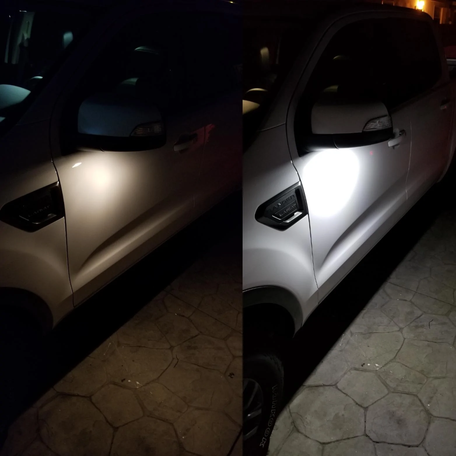

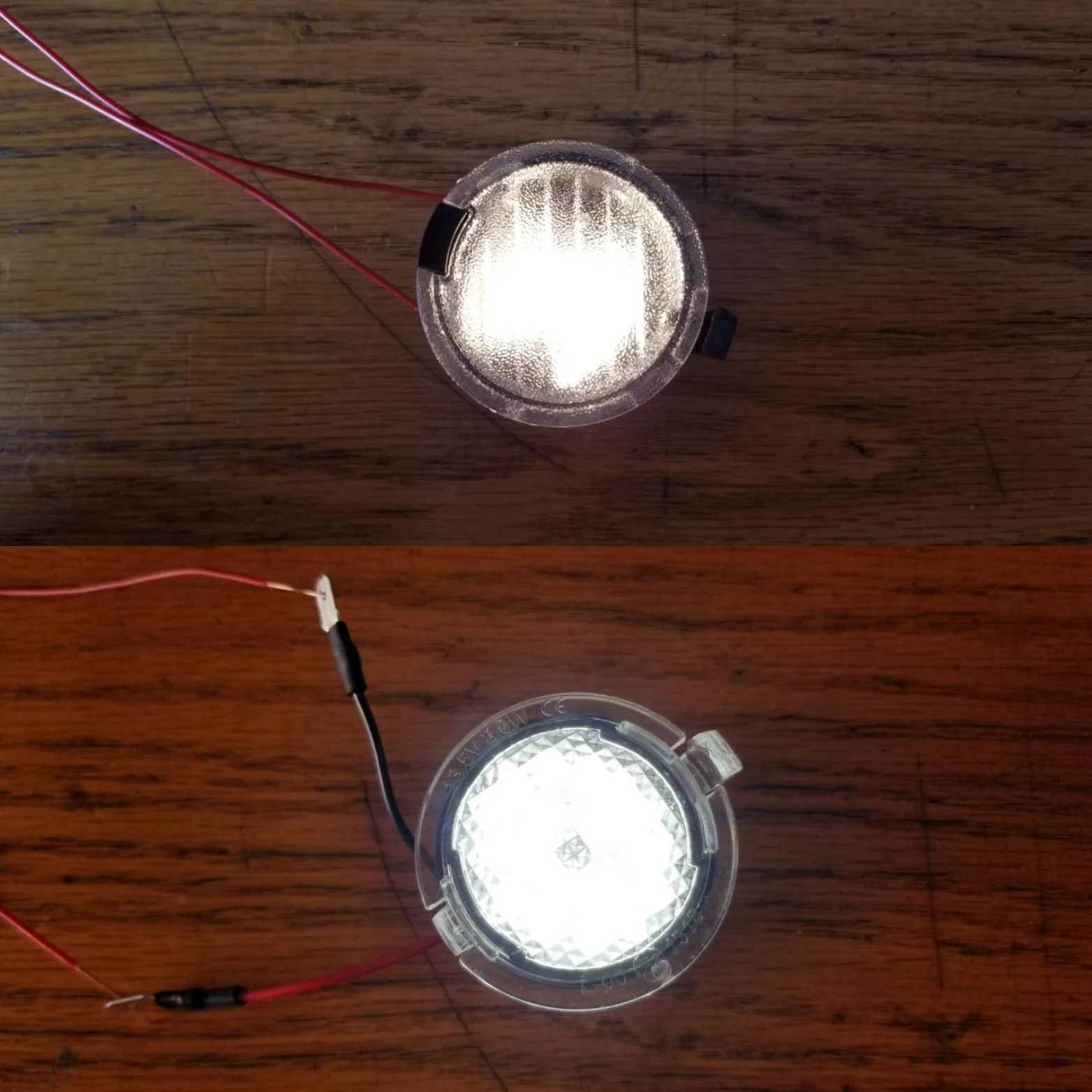

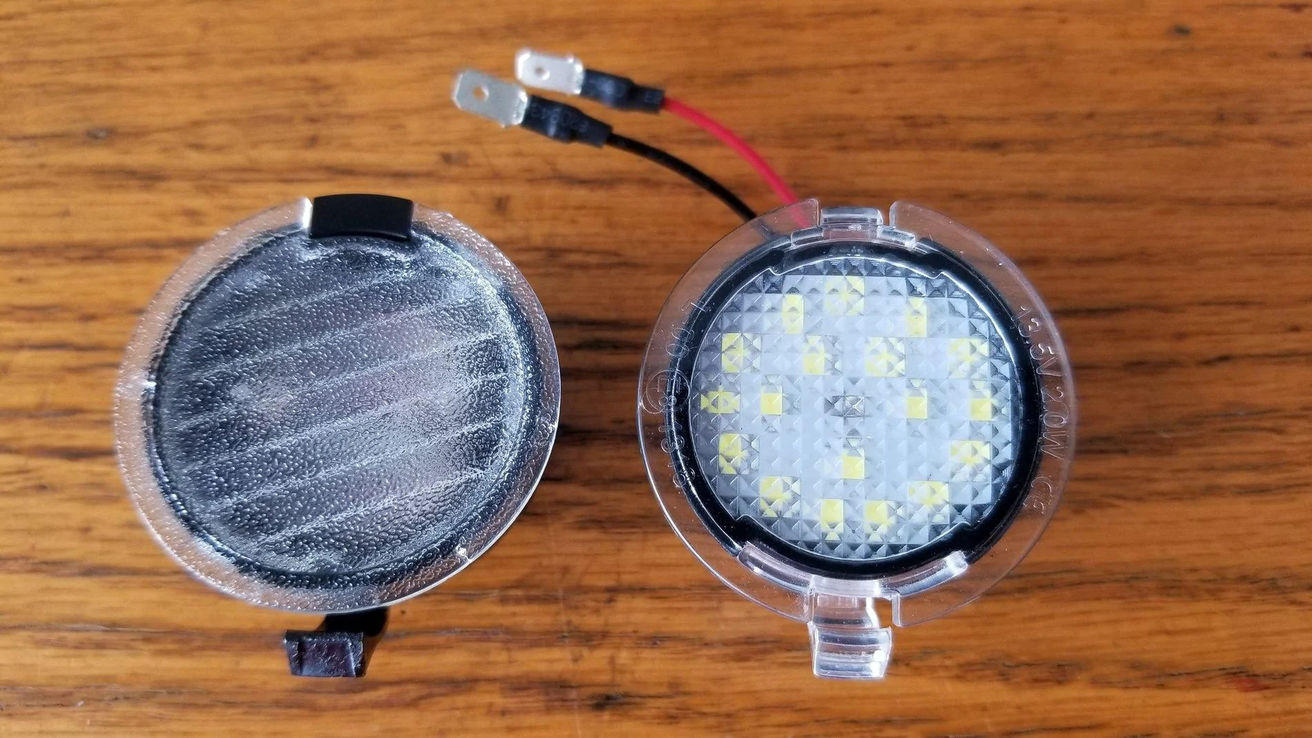

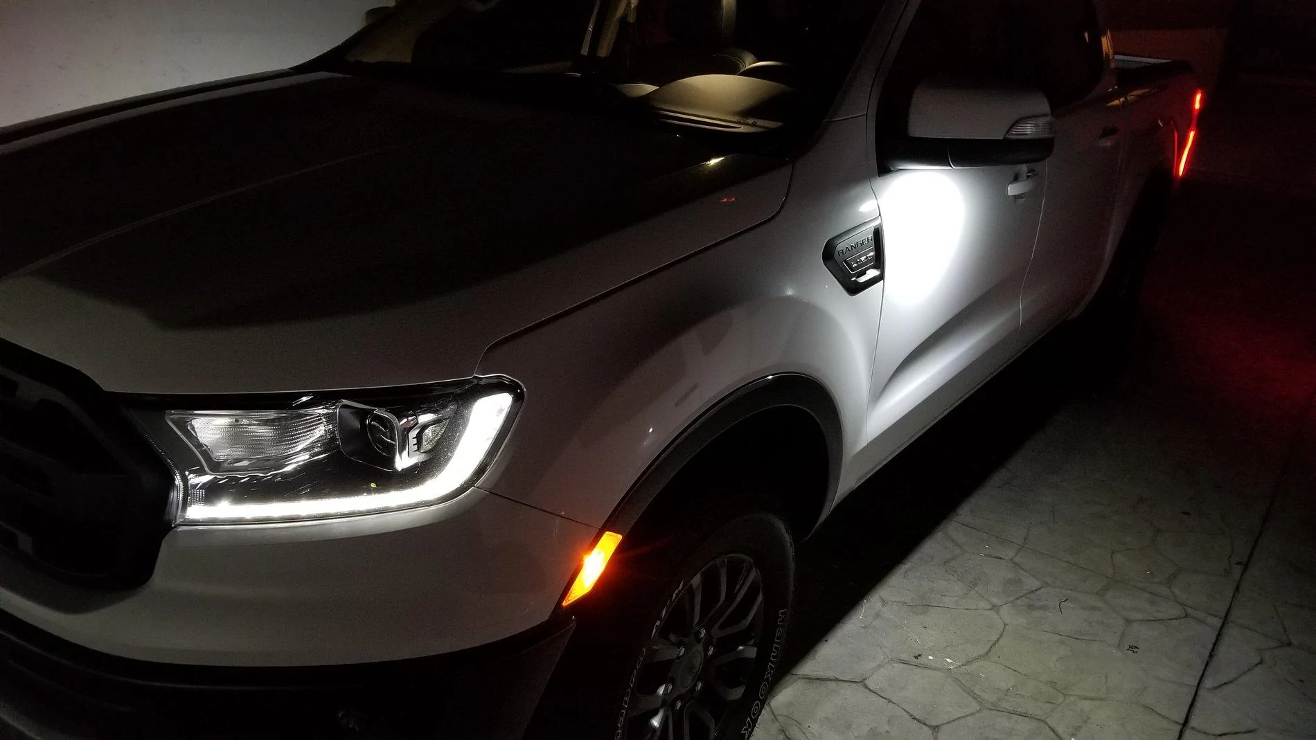

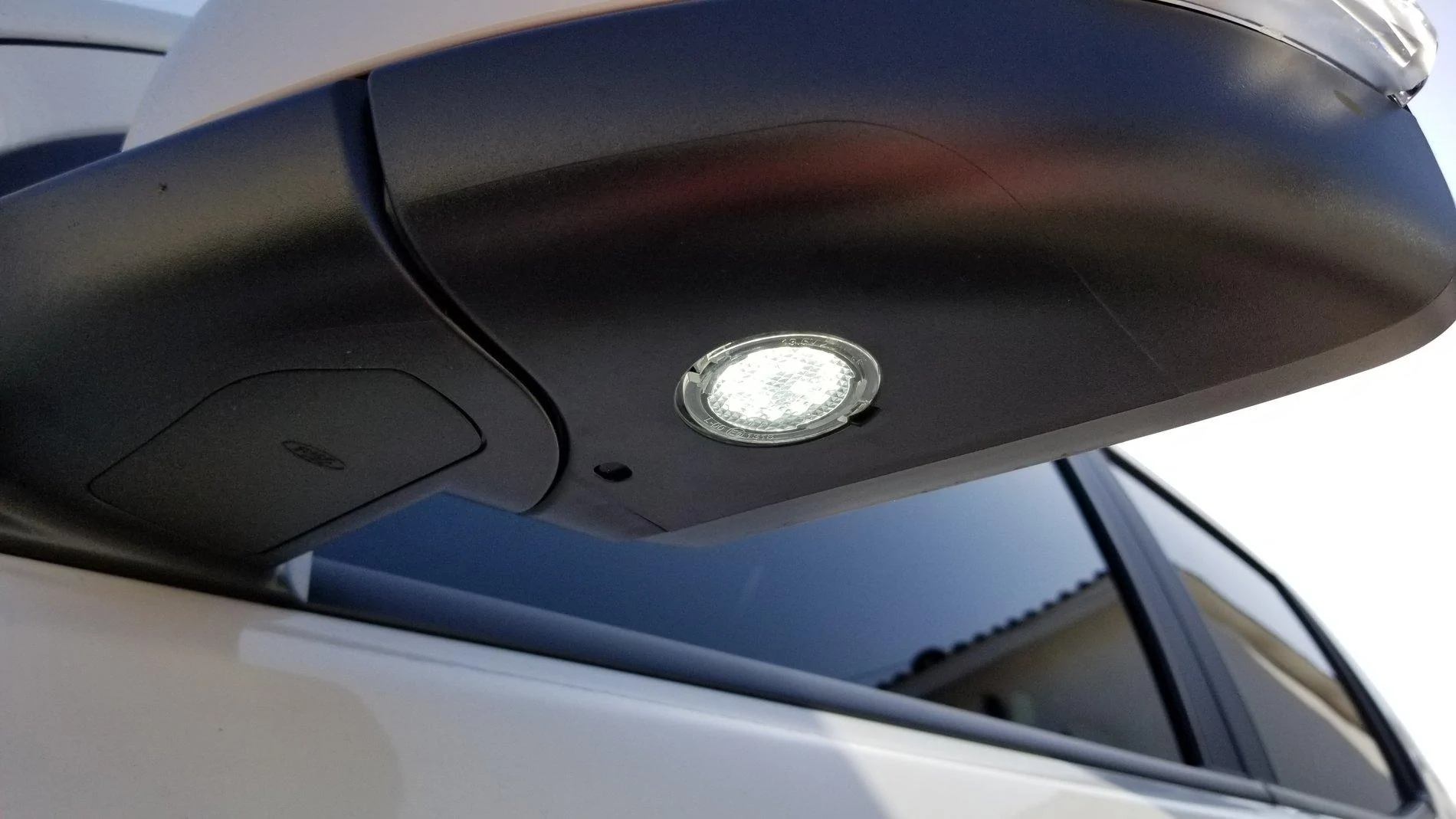

I got the replacement lights in, and they plug right in and are much brighter. It's still bright out but I'll get the night shots later this evening.
Just for reference again, these are the ones I ordered. https://www.amazon.com/gp/product/B078MJW122/

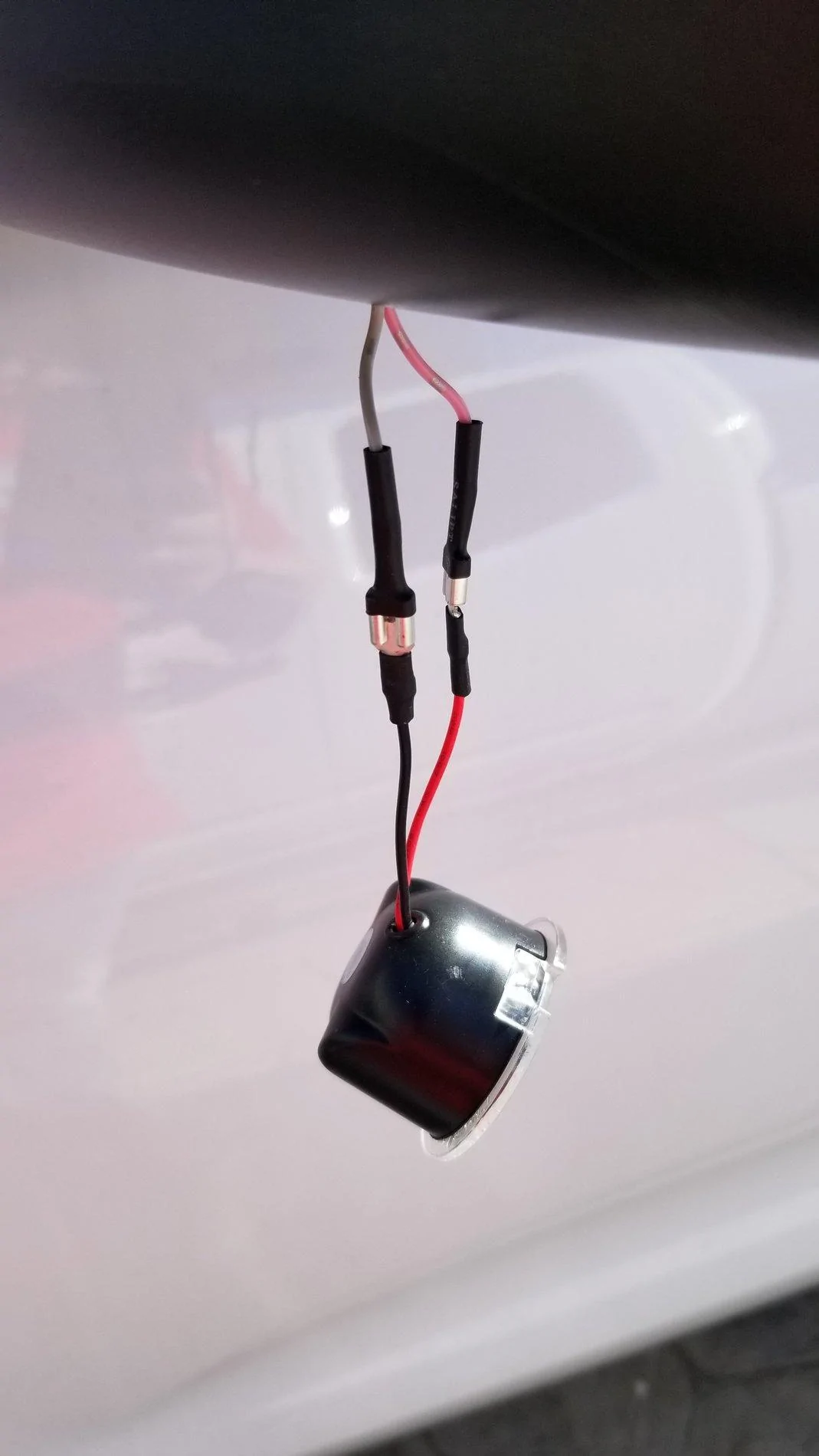

OH, and do yourself a favor and tape up the wires after connecting them so they don't short out when you tuck the wires in.
EDIT: Here's the night comparison and a bonus pic that shows it matching the DRLs quite well.

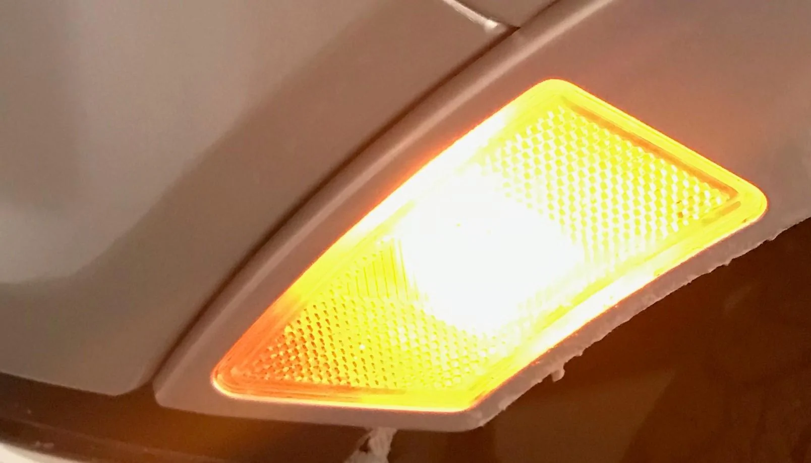

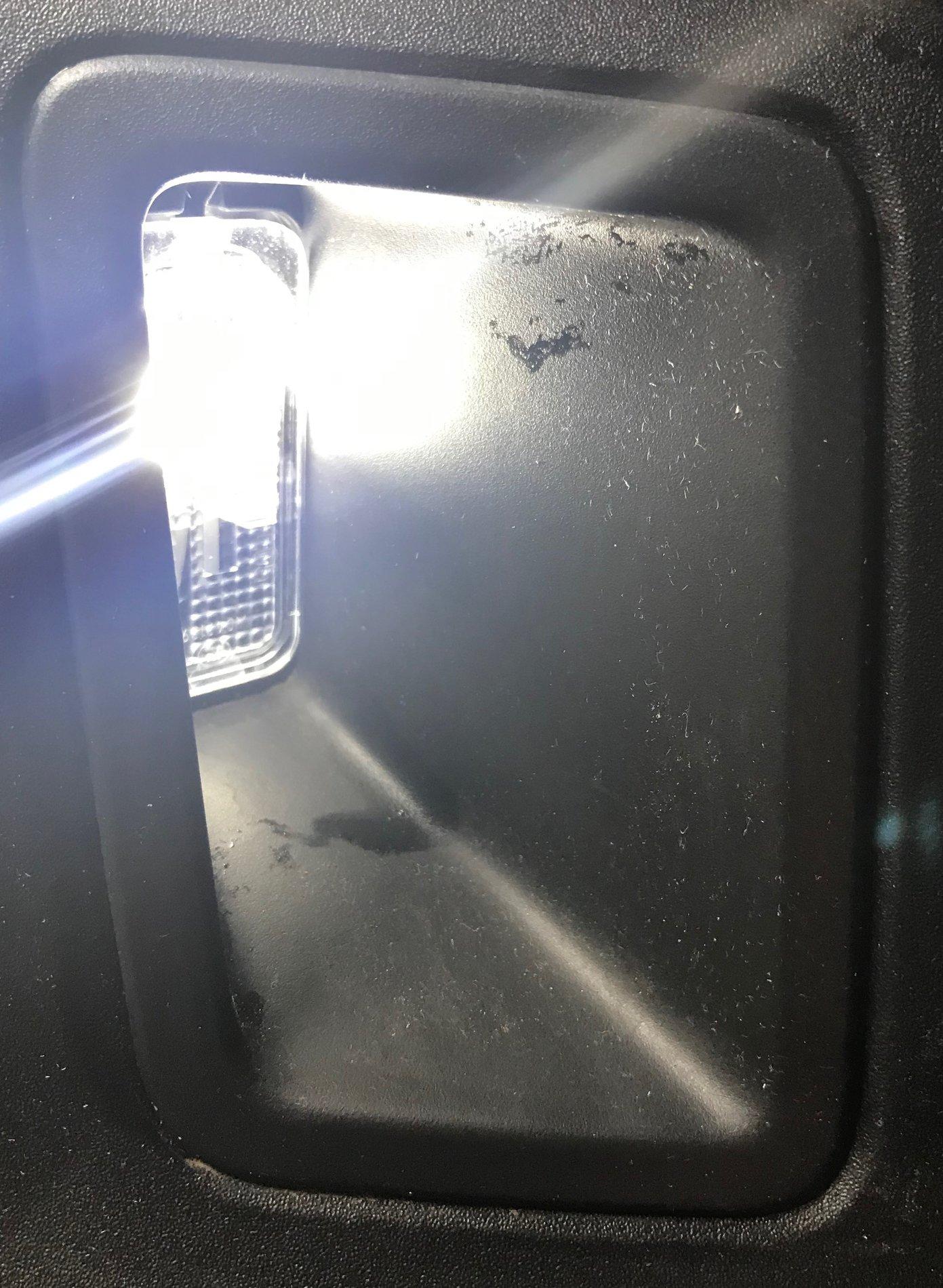

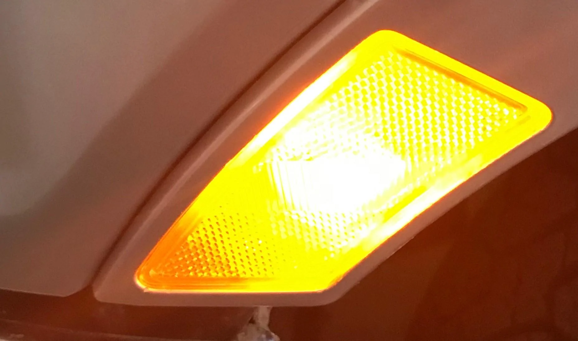

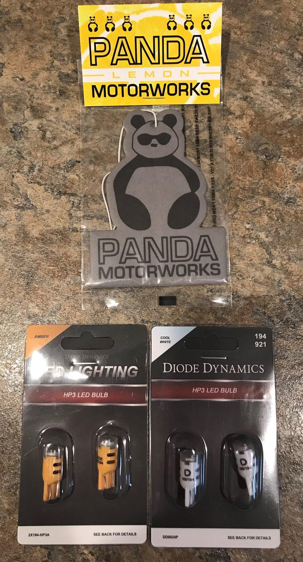

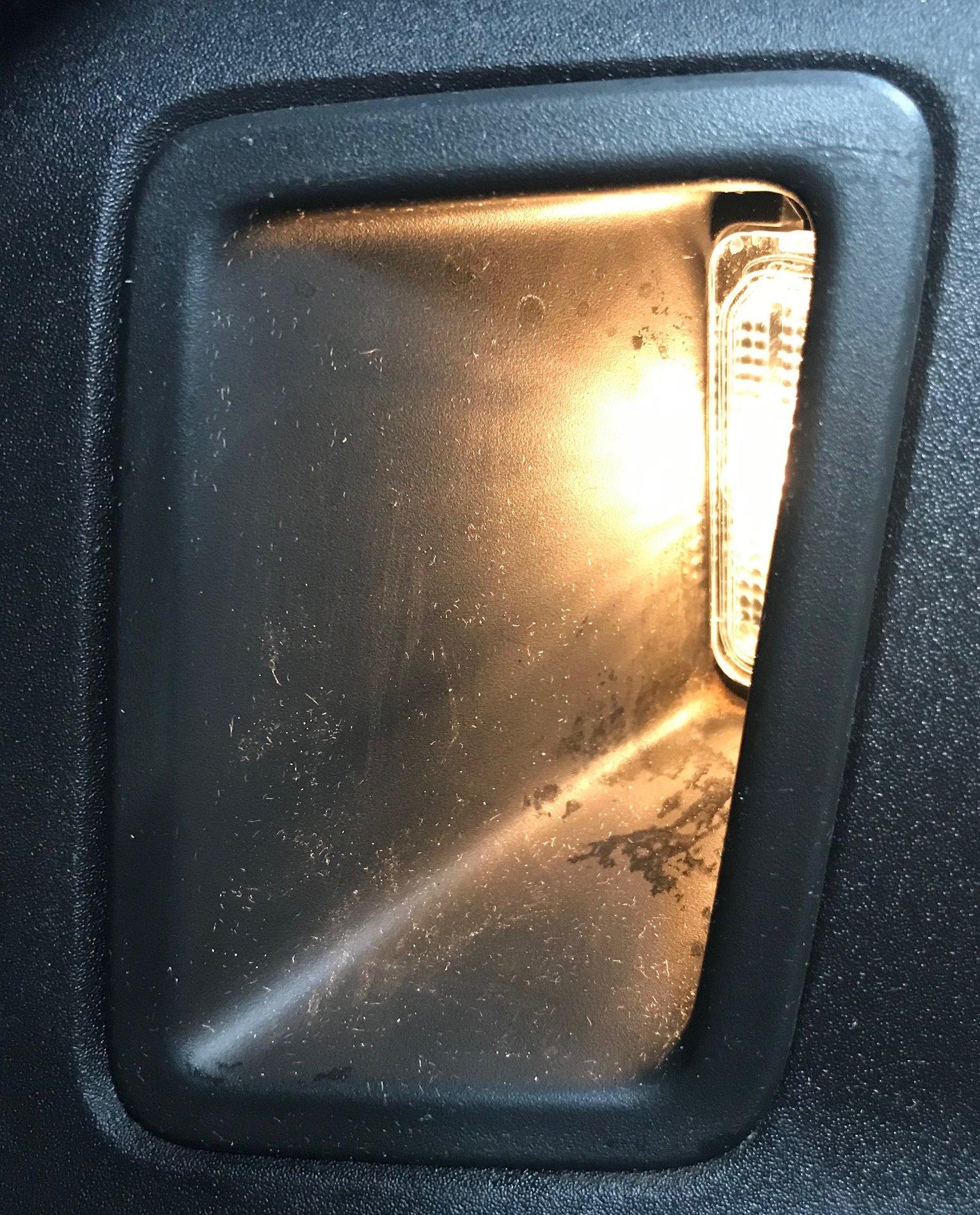

@PandaMotorworks GREAT CUSTOMER SERVICE!!! Got my 2 sets of LEDs from them and Diode Dynamics. HP3 LED BULB (Amber): for front markers and then HP3 LED BULB for license plate

Those look much better! How do those puddle lights pop out? Might have to do that to mine.

A flat head screwdriver to release a tab on one side and they pop right out!
