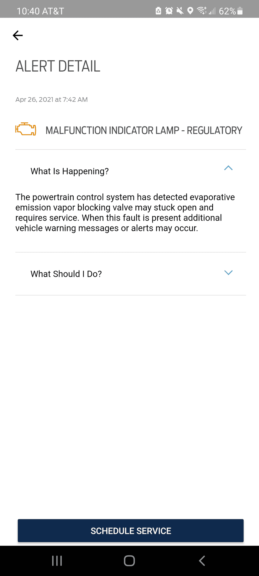

Hey all, first time posting here. I've been checking the forums to see if there are others with a similar issue I have but I haven't seen anything. I have a 2020 Ranger XLT FX2 with about 4200 miles. Engine build date is OCT 2020 and body build date is Nov 2020. A week ago I got a sudden CEL and immediately took it to the dealer. The fordpass app says its due to the evap blocking valve is "stuck open". They said the problem was a faulty blocking valve in the gas tank needed replacing. They overnighted the part, dropped the tank, and gave the truck back shortly after. Around 100 miles later, same light came on for the same issue. So I took it back to the dealer and spent the whole day with the tech and they couldn't figure out what's causing this CEL. The truck is still in the shop. Does anyone have any idea what could the source of the issue?

Sounds like they possibly forgot to clear the code, something got into one of the evap lines and is preventing it from pressurizing correctly, or the replacement unit is also faulty.
Looking into this a bit it seems some of the F150's had an issue with this a while back and many had to have the evap valve assembly and fuel tank hose assembly

Little update: Service advisor tells me the shop foreman hasn't reached a diagnosis yet and wants to refer to the ford tech hotline. I'm not sure where it'll go from here. I'm at a week with my truck in the shop. :(
