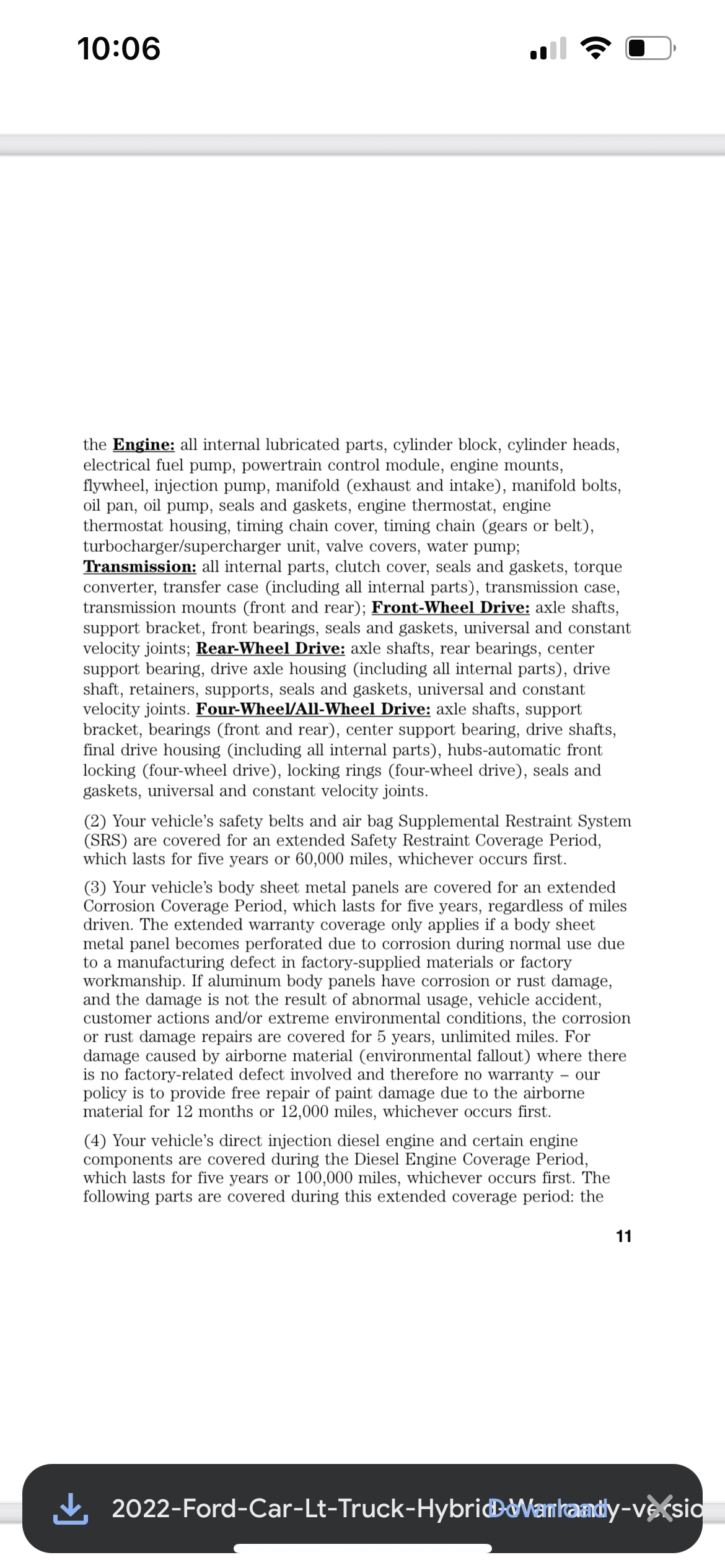

Tell them you want an full detailed estimate showing both verbiage and parts list. If you’re in the 5 year /60000 mile period anything to do with with the driveshaft ( seals or bearings) is covered. So them saying one is covered and one is not doesn’t make sense. See attached listing of what’s covered in the 5/60 warranty. Or they screwed up something when they did the other repair and aren’t owning up to it. Either way they have to give you a full detailed estimate before proceeding.

Bumper to bumper is 3yr/36K, drive train (which includes your problem) is 5yr/60K, so unless you have more than 60K, you should be covered.
