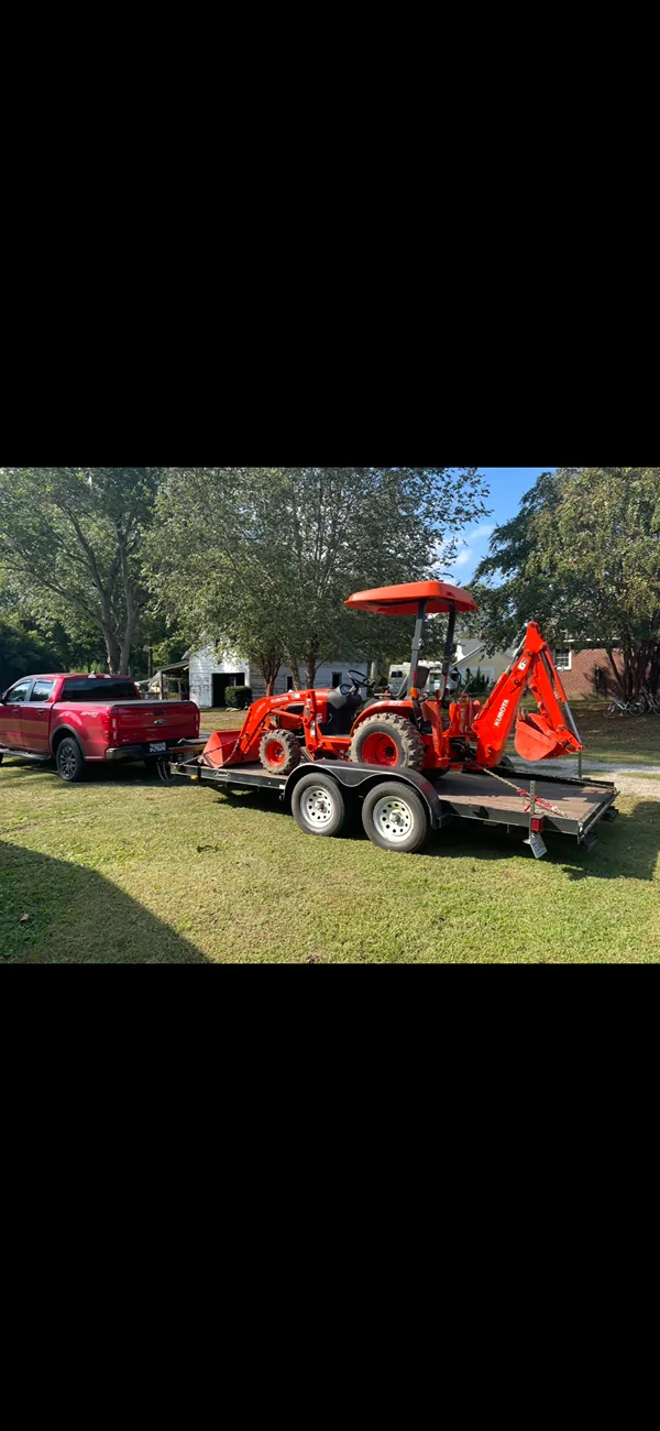

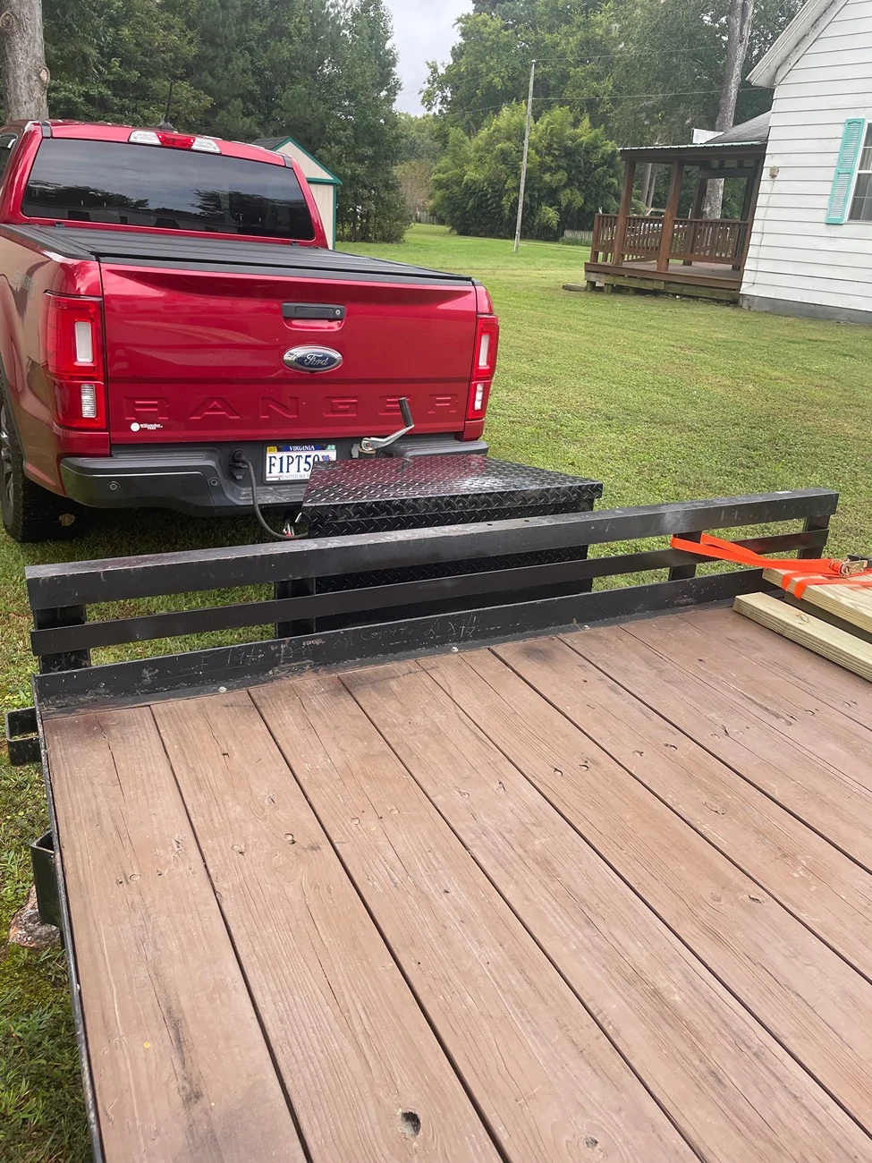

I guess I should not post these pictures of my Ranger going seriously off road cause it will void my warranty.
Y
Wait, you bought a Ranger with the tow package and actually *gasp* towed?
What were you thinking man!?!?
Scrub these incriminating photos ASAP!
OMG.....Off Road AND Towing.....instant voiding of warranty !!!!!
