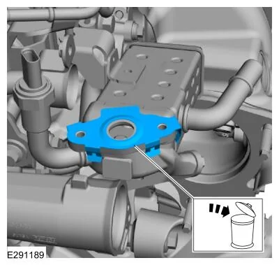

If you have P139C, which is the common DPFE Code and IF RELATED then I suspect a leaking EGR Cooler, letting coolant into the EGR System through the EGR Valve.
Now checking the rubber hoses at the DPFE may be misleading for wetness as there is most likely moisture in the sensor, but if it is indeed coolant - then it's coming from the EGR Cooler
So, if it is just moisture (water droplets) - Ok but if its coolant (Not Ok)
The easiest spot to confirm without pulling the EGR Valve is the EGR Backpressure Sensor - that mounts in the EGR Cooler - Stand-Off Tube
EGR Valve Mounts (at the blue gasket) on the EGR Cooler
The EGR Backpressure Sensor - is the sensor in the pic
The EGR Tube - that routes to the back of the engine and feeds the DPFE Sensor connects to the EGR Valve itself, and when it opens its feeds that tube.
So, depending on the severity of the leak, will determine how much coolant you can see here or if that sensor is wet.
This is possibly a easier way than pulling the EGR Valve itself and inspecting for coolant entry into the EGR Valve ports. (The Blue) Gasket and the matching EGR Valve Port

I would Pressure Test the System (Including the Cap) as a bad cap can cause missing coolant (Pressure) Issue
