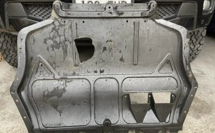

Kenny,
@Dereku is right - check those skids and also see if any heat shields are loose or bent and check any exhaust clamps in the area they accessed to perform those services.
A member on here had what he thought was knocking and it turned out to be either a loose exhaust clamp or a pin-hole leak in his exhaust - don’t recall exactly which. Another member had a heat shield that was making contact with something.
It wouldn’t be the first time a tech moved, bent, loosened, or altered something to make things easy for themselves and forgot to put things back to their proper state. Instead of removing the belly pan of my Passat, a tech took a sawzall to it so they could access the oil drain plug.
Anything can happen out there - it’s like the Wild West.

Kenny,
To elaborate I had a low speed knocking after my transmission replacement. Slid underneath when I got home and started poking things. Skid plate was loose. Wiper arms were not put on in the right position either but that was 54k miles ago. Still wrong.
