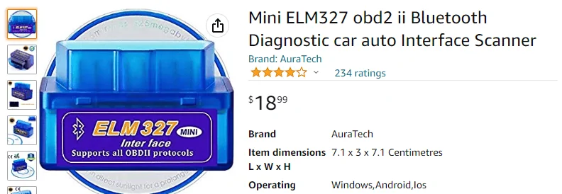

You can buy a blue tooth scanner, ELM327 & get the free torque app for android.
If you have Apple phone, good luck. I bought a blue tooth device for Apple & Dash Command & it did not work.
You can scan codes or delete/reset a CEL Check Engine Light. Simple to use.
