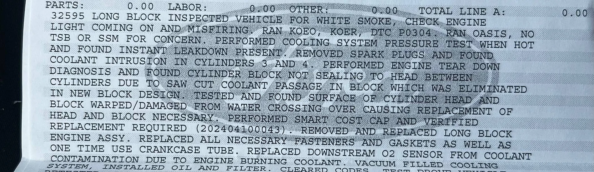

My motor was replaced at 32500, covered under warranty. Coolent in the cylinders, took like three months
Blown head gaskets were a known problem on early Ranger 2.3L engines and has been corrected in later engines. My mid year build 2020 has the newer engine with the revised coolant ports between the cylinders.
I would still be very cautious about continuing to drive it once the idiot light or gauge reads high. The block and head are aluminum, and they will warp when overheated.
Blowing the bottom end out is very rare.
I thought that issue was for other 2.3 variants? I thought they changed the design for the 2.3 designed for the Ranger? It is mostly the same as other variants but I do remember reading about the head gasket issue but am like 99% sure it was not an issue for the Ranger engines.
They drilled coolant ports between the cylinders in the block to even out temps. It worked well. All 2019 and some early 2020 models had the early engine. I remember researching and checking my engine date to see what was in my truck.
