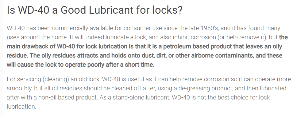

we can do this all day
Source of your posting?
Do what all day? Being an ass? I merely presented a much wider 'picture' of the product depicted. WD-40 is good for what it was intended to do.
