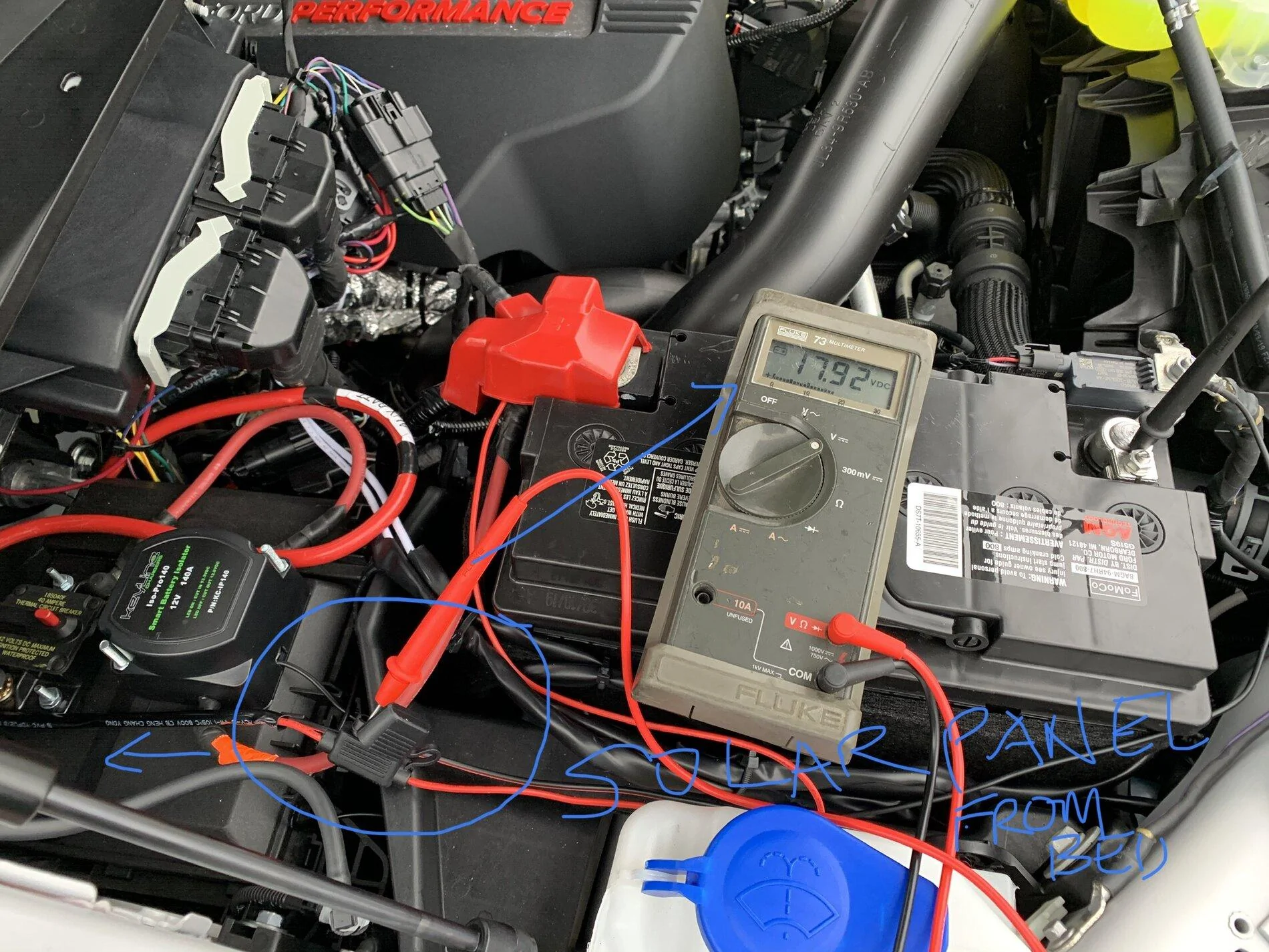

I did a non-permanent dual bettery setup on my Raptor.
( not planning on doing it for the Ranger...yet)
I used a Trolling motor battery case, a size 34 AGM battery,
a battery charger/ isolator and a cicrcuit breaker to and from source battery(hood) and 2nd battery(bed). Run the 7awg from the charger/Isolator kit, under chassis frame, then into the bed.
(Its important to add circuit breakers to and from, for safety reasons, in case the wire gets damaged you dont want it to turn into an arc welder, remember you now have 2 batteries, not one)
No issues, for the year that I had the truck...running inverter, power saw, tools, Arb twin comp, etc...
Its not the prettiest setup, but it worked. :p
And its Not permanent, so I was able to remove the whole thing before trading my Raptor.?

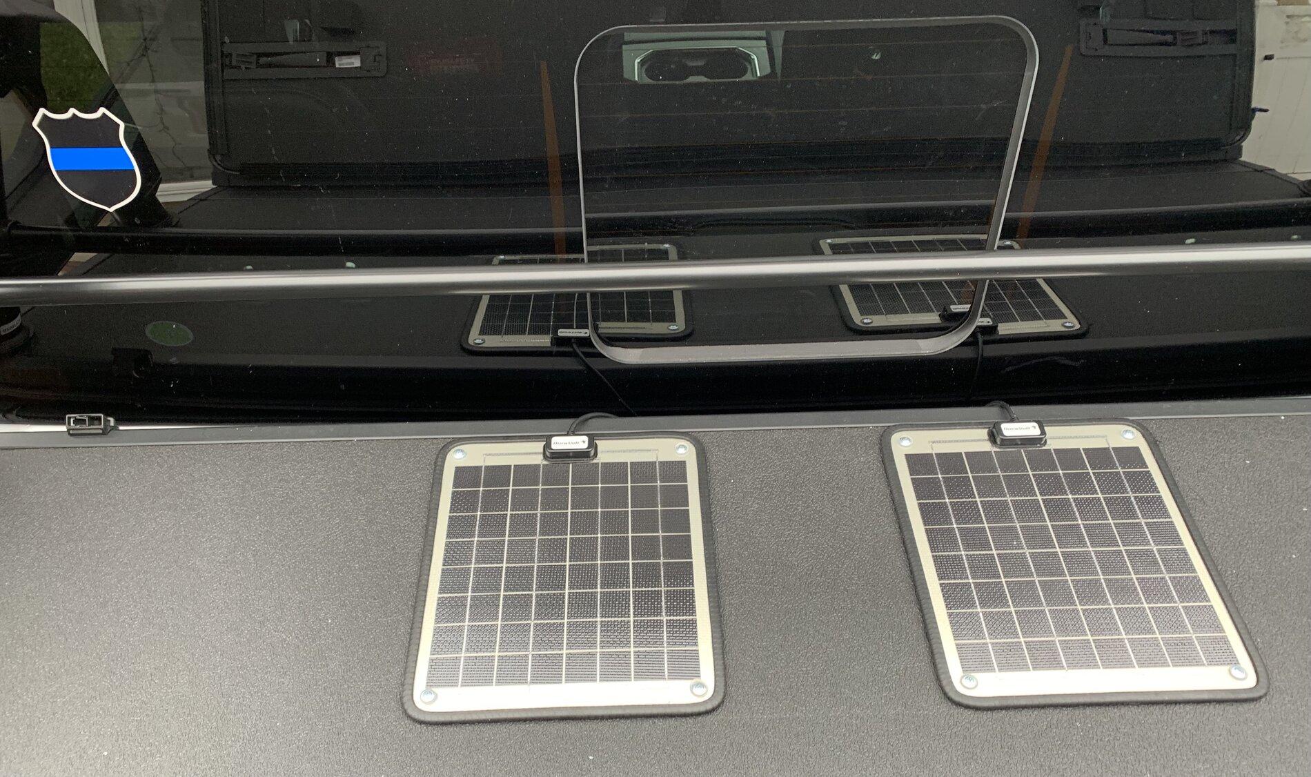

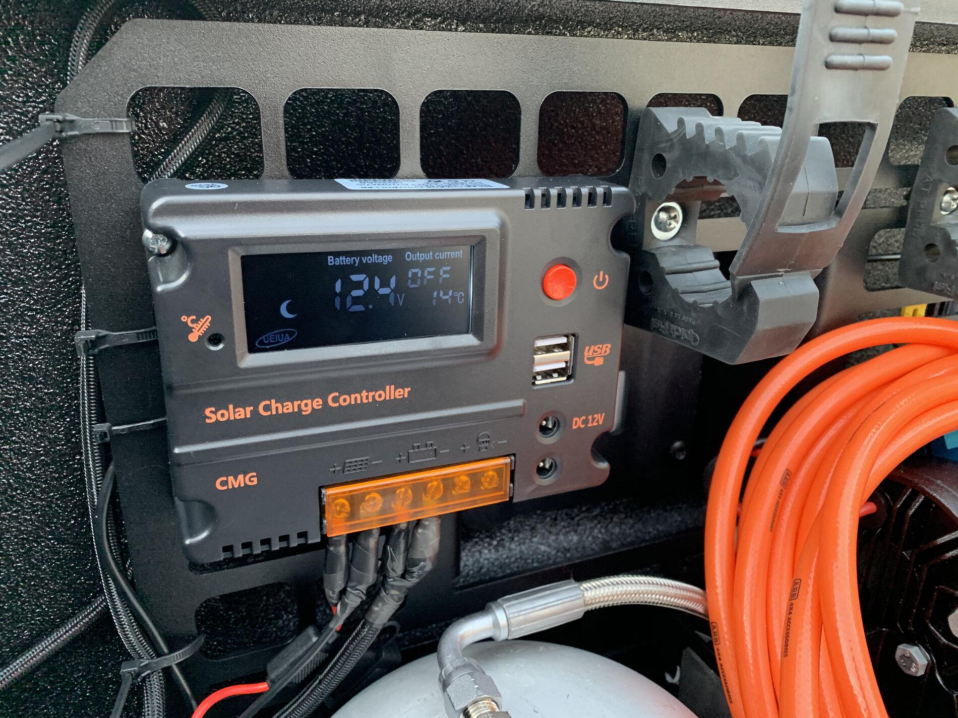

I forgot to mention, It also had 2 Duravolt Solar panels, thats why there’s a solar controller next to the ARB twin.

I really want to see how you attached those molle panels to your bed.
