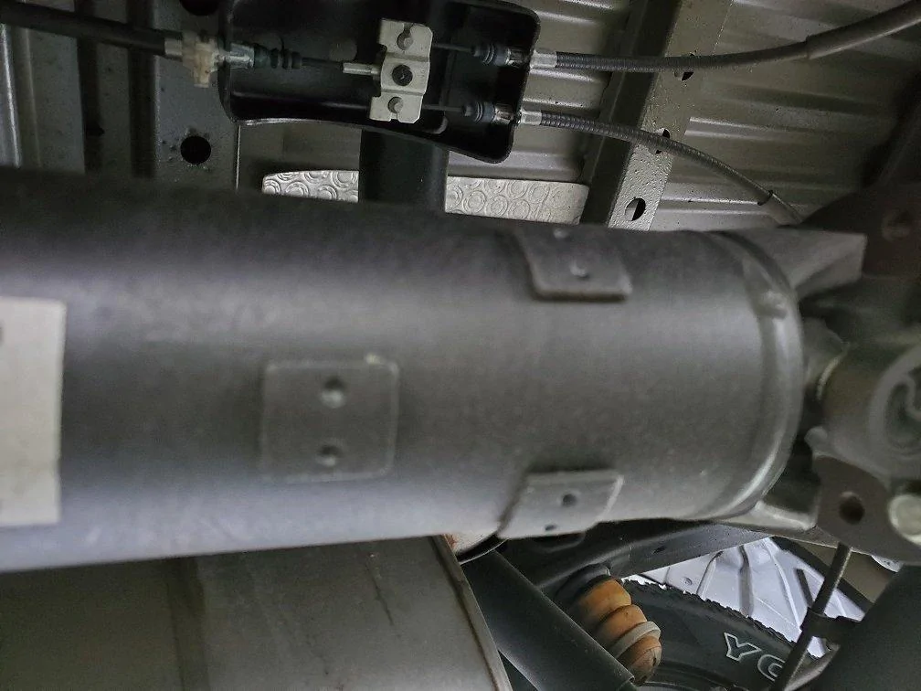

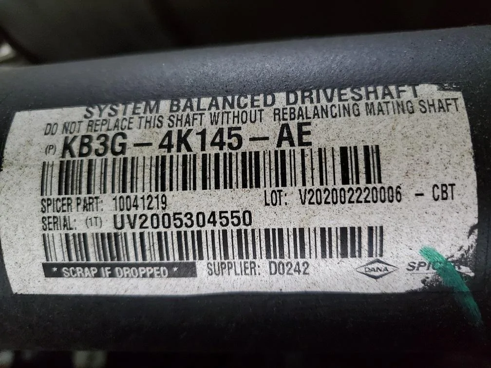

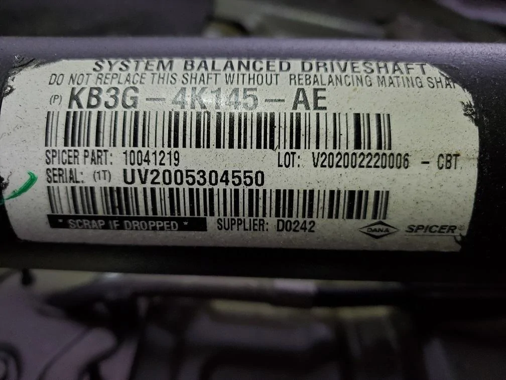

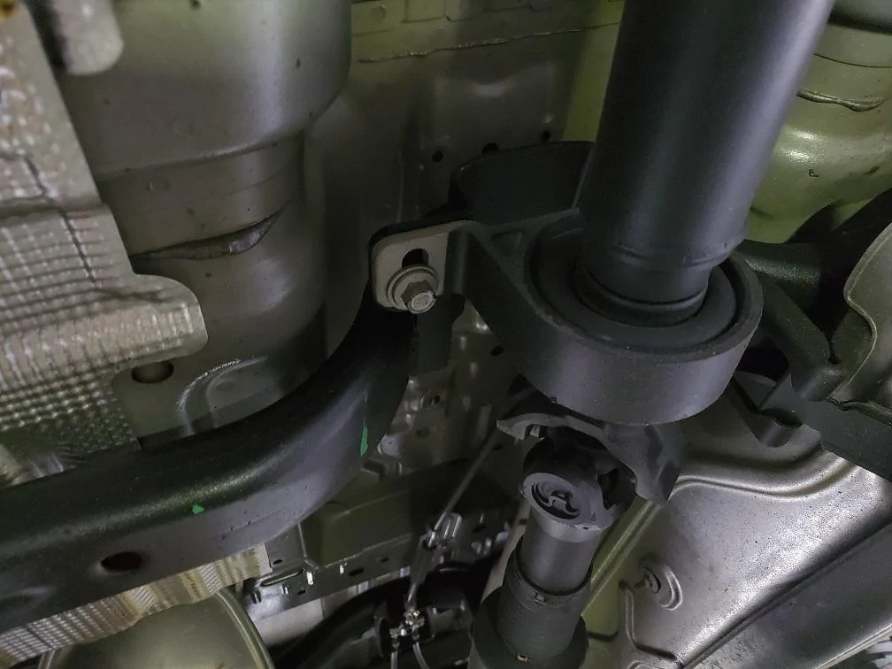

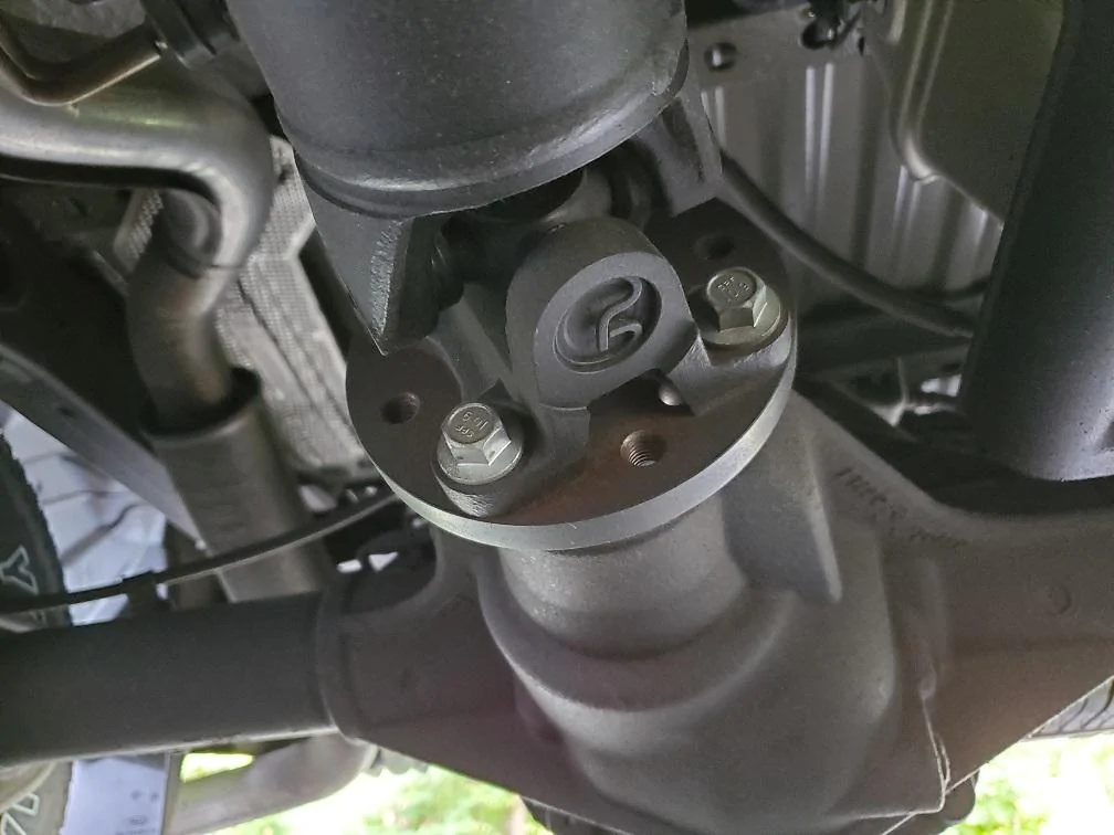

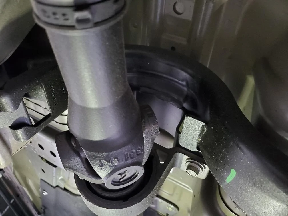

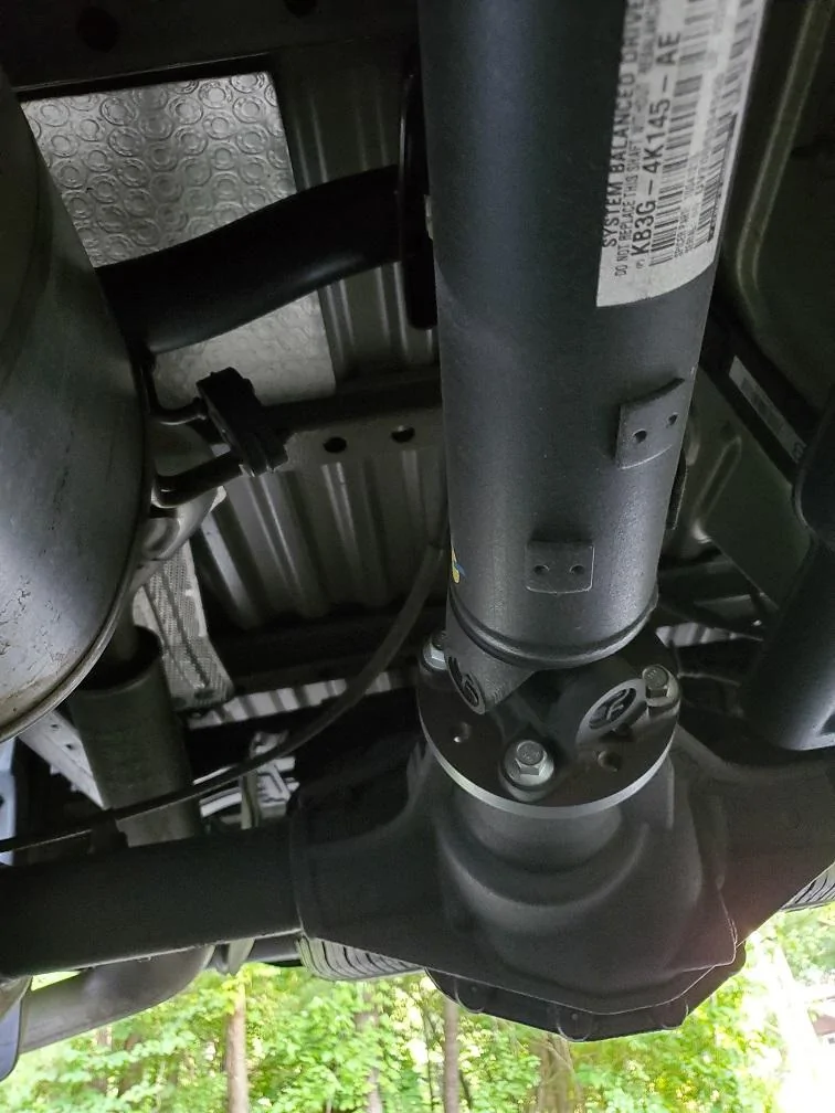

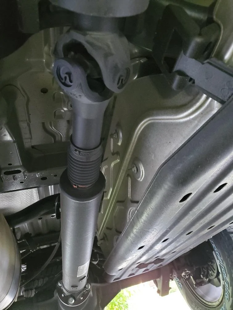

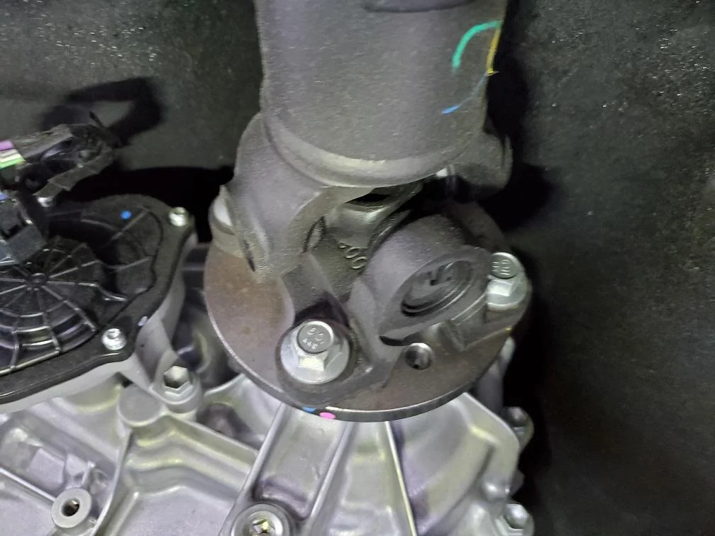

While under the truck I snapped a few photos of the driveshaft assembly and mounting areas.
It looks to me that with the center carrier bearing removed there should be quite a bit of clearance for the one piece driveshaft to articulate. I measured the distance between the flanges to be 67.250", but I have not yet taken into consideration the critical speed factor that Phil pointed out as being a very important aspect to consider. While I have been in communication with a driveshaft manufacturing company who knows what vehicle I am working on, we haven't actually discussed the critical speed requirement. The representative has sent me a document that addresses this and I have attached it here. I, for one, will not need to consider the extreme articulations required for off-road adventures, nor increased driveshaft u-joint angles from lifting the truck. The most off-road type driving I will be attempting will be negotiating New England winter pot hole roads.
