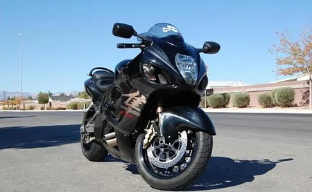

Hi arbjosh, I have a question and hope it is not taken wrong because that’s not my intention.
Just curious if you actually knew what a turbo sounds like that is not restricted? I have a turbo motorcycle and it has a turbo that is bigger than most cars. It puts out 311 hp to the ground but it’s capable of 600+ If I added secondary injectors.
In the picture you can see I have a dump pipe exiting the right side of the bike. There is only gargle at idle and low power. It’s loud! It’s not a pleasant noise.
That set up is the least restrictive and you get the turbo noise. Look on YouTube for videos of what a dump pipe turbo sounds like.
When it comes to exhaust note, I would always choose a built motor or big cam motor over turbo. They sound SWEET!
I do like turbo sounds because of what it means. Smooth power and usually way more power than non turbo motors.
So a clean turbo sound I don’t believe is possible.
