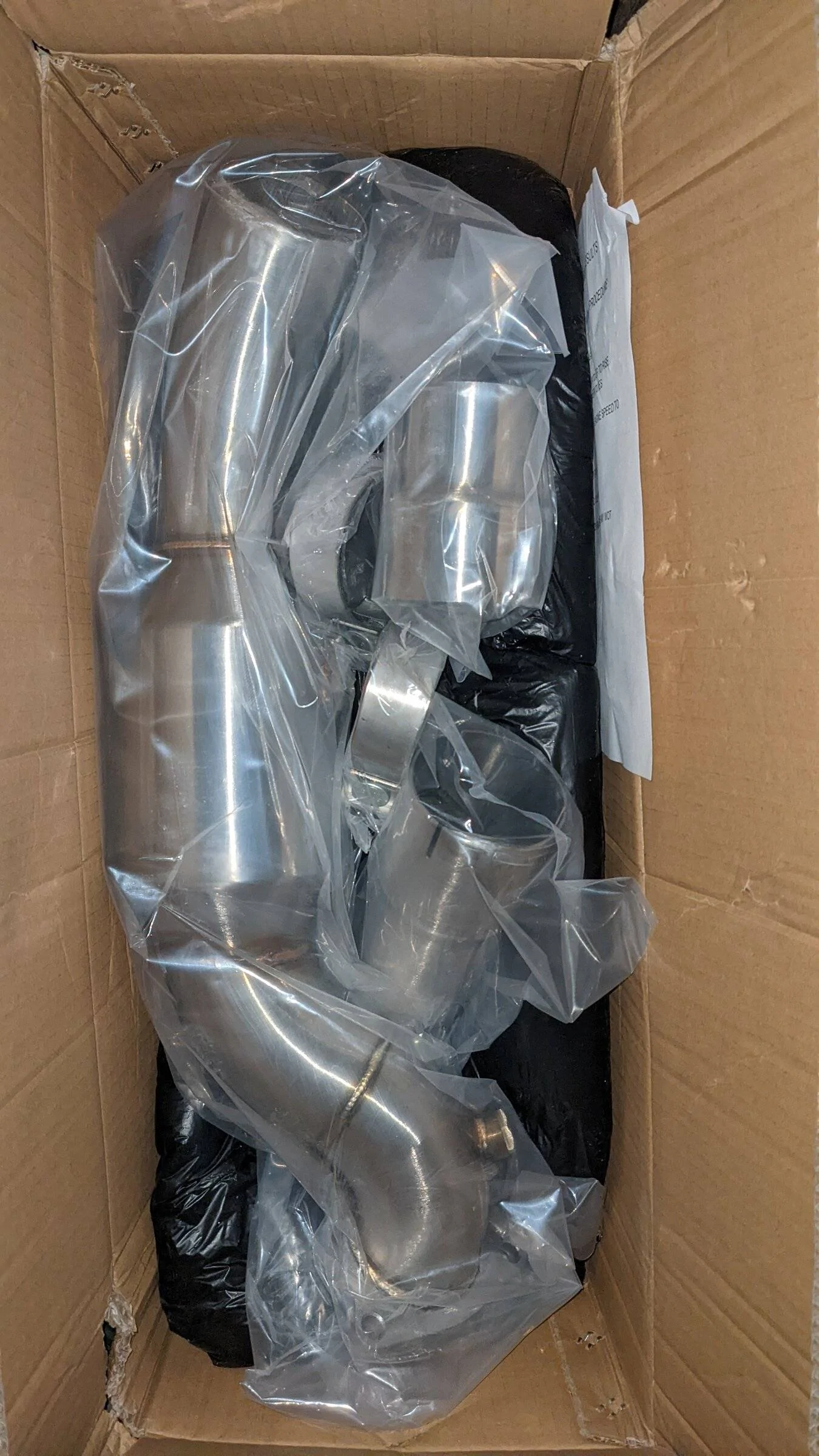

What's up guys, I just got my catted downpipe in today from CVF and I'm stoked to get it on and light up the tires!
I purchased it through 5 star since they update my tunes for free if I buy the parts through their website. I've heard great things about CVF and this thing is 304 stainless!

Update:
Got the downpipe on this morning before and I'm uploading the tune!
The install was honestly a pain in the butt for most of it. The three nuts I actually loosened up first and without a ratcheting wrench man it was tiring, and very tight of a space! Good thing I can stand on my bumper.
The most annoying part is have to say is disconnecting the O2 sensors, for me at least. That was a real PIA.
The downpipe comes with a sheet of paper explaining how to turn on the truck and hold some revs to break in the new cat. I'll break it in and post about it after a while!
