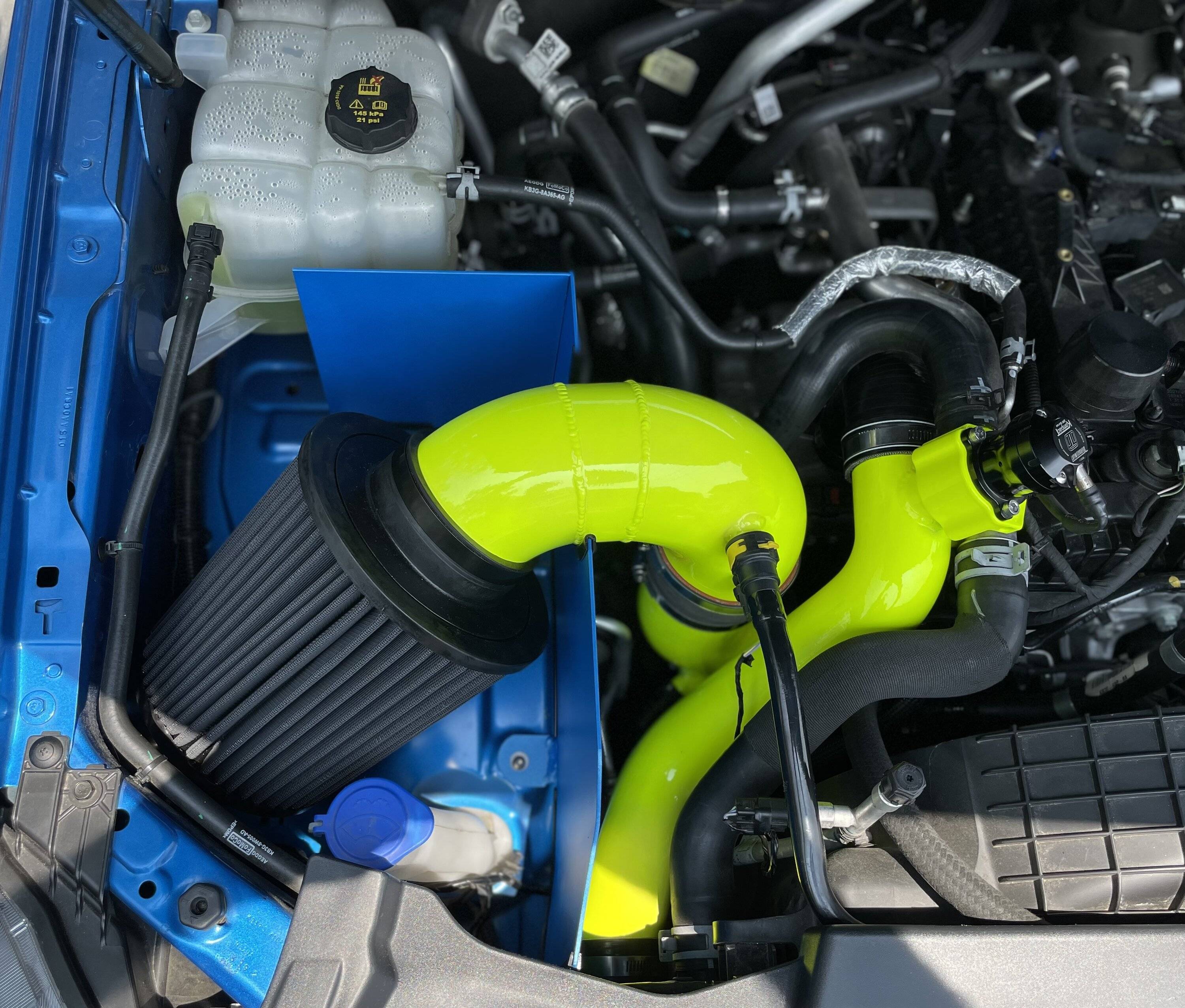

I have Mishimoto pipes but…. It’s not a big deal to have them recoated any way you want.
