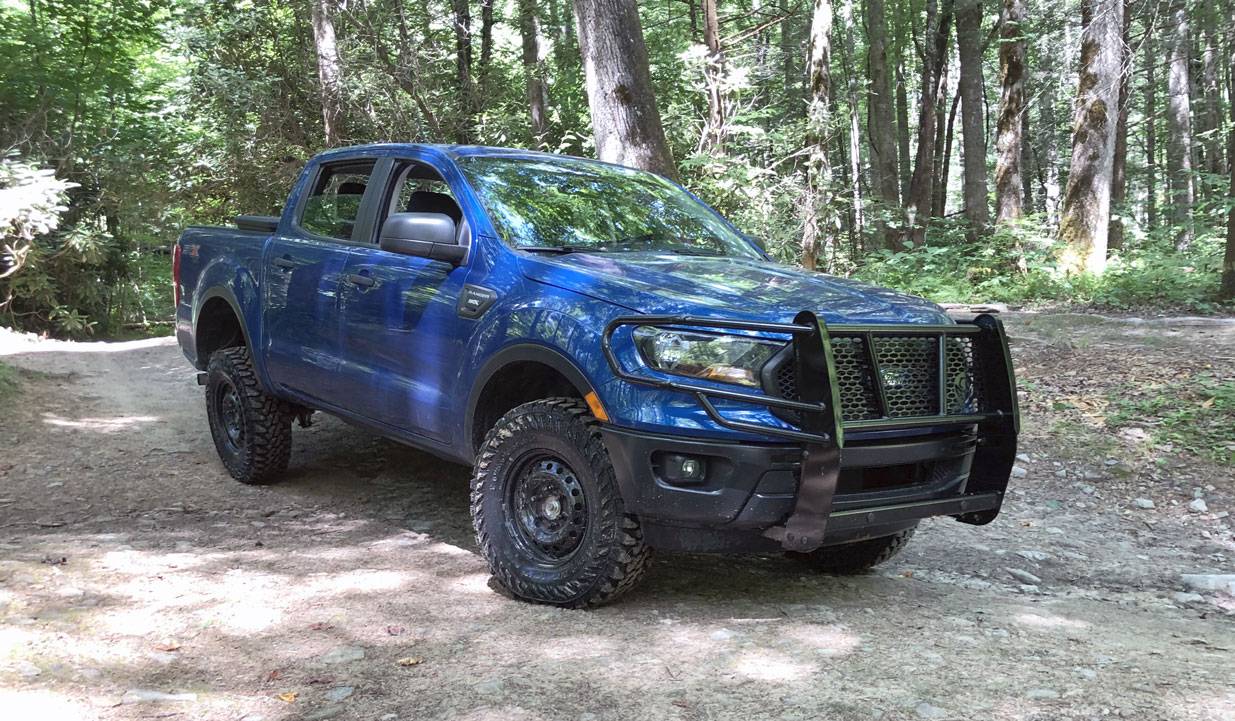

Gratuitous pic of Ranger. (This was taken during a break on a fairly level, easy stretch. The camera doesn't capture it, but even where it's parked the front and rear are a bit "twisted" showing the rear springs extended quite a bit. Sorry, I'm not big on taking lots of photos when I'm out and about LOL)

Those 265/75’s are a bit taller than the more common addition of 265/70’s.
Did you have any clearance issues and do these fill out the fender well better?

These definitely fill out the fender wells better. To be clear, they are 16" rims so the 265/75-16 are almost exactly the same as 265/70-17.
Absolutely no rubbing whatsoever (there was plenty of opportunity, too). According to Yokohama these are 31.9" diameter / o/a width=10.7" / tread width=8.4"
The rims are factory / 55mm offset. (I prefer the narrower stance..... and they were cheap! :) )
