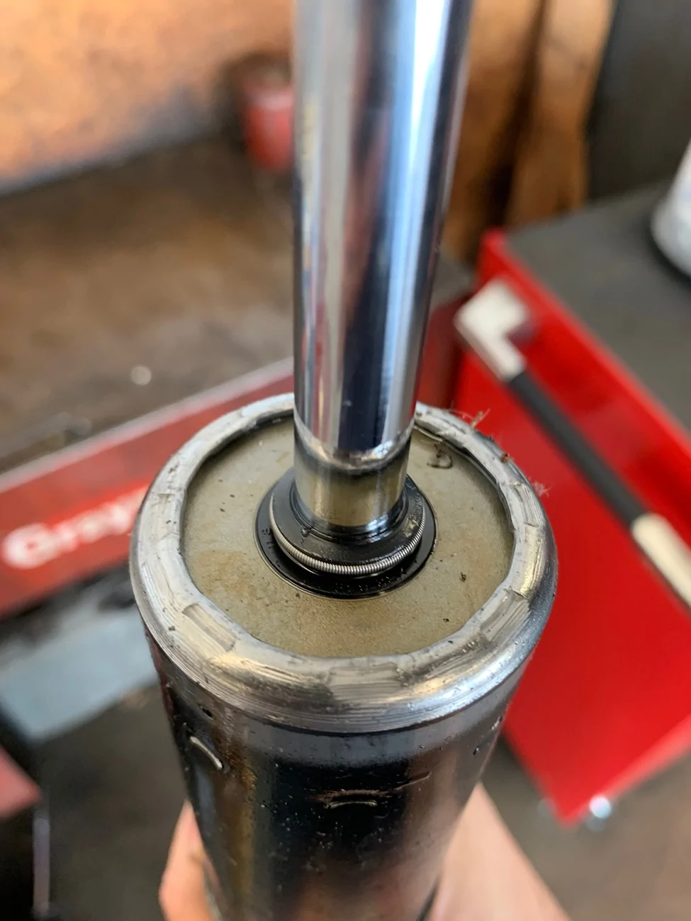

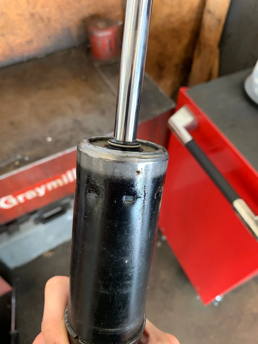

I replaced mine on all four corners on my 23 FX4 at around 1,000 miles with Bilstein 4600s. Once apart, I was able to see the fronts were already starting to leak. No joke. So I’d say with 123,000 that you could benefit from any new shock on the front. Even quick strut type assemblies would be fine.

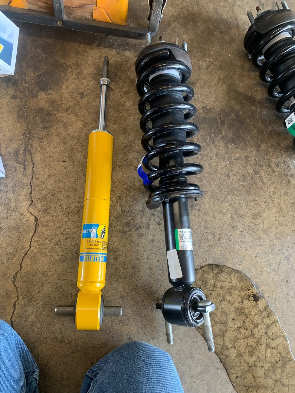

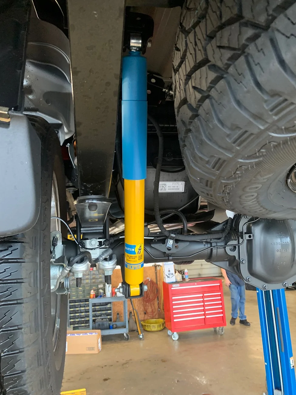

I installed Bilstein 5100 "Shocks" on all 4 corners of my FX2 at 10K miles. My Ranger is a road truck and these are a great system with a great ride. I put the spring on the 2nd notch which gave me a 1.5" front lift which is perfect. Yes the spring is compressed more than stock, but the ride is perfect IMO. The FX comes with upgraded shocks but the 5100 is a far superior shock and will last a long time.
