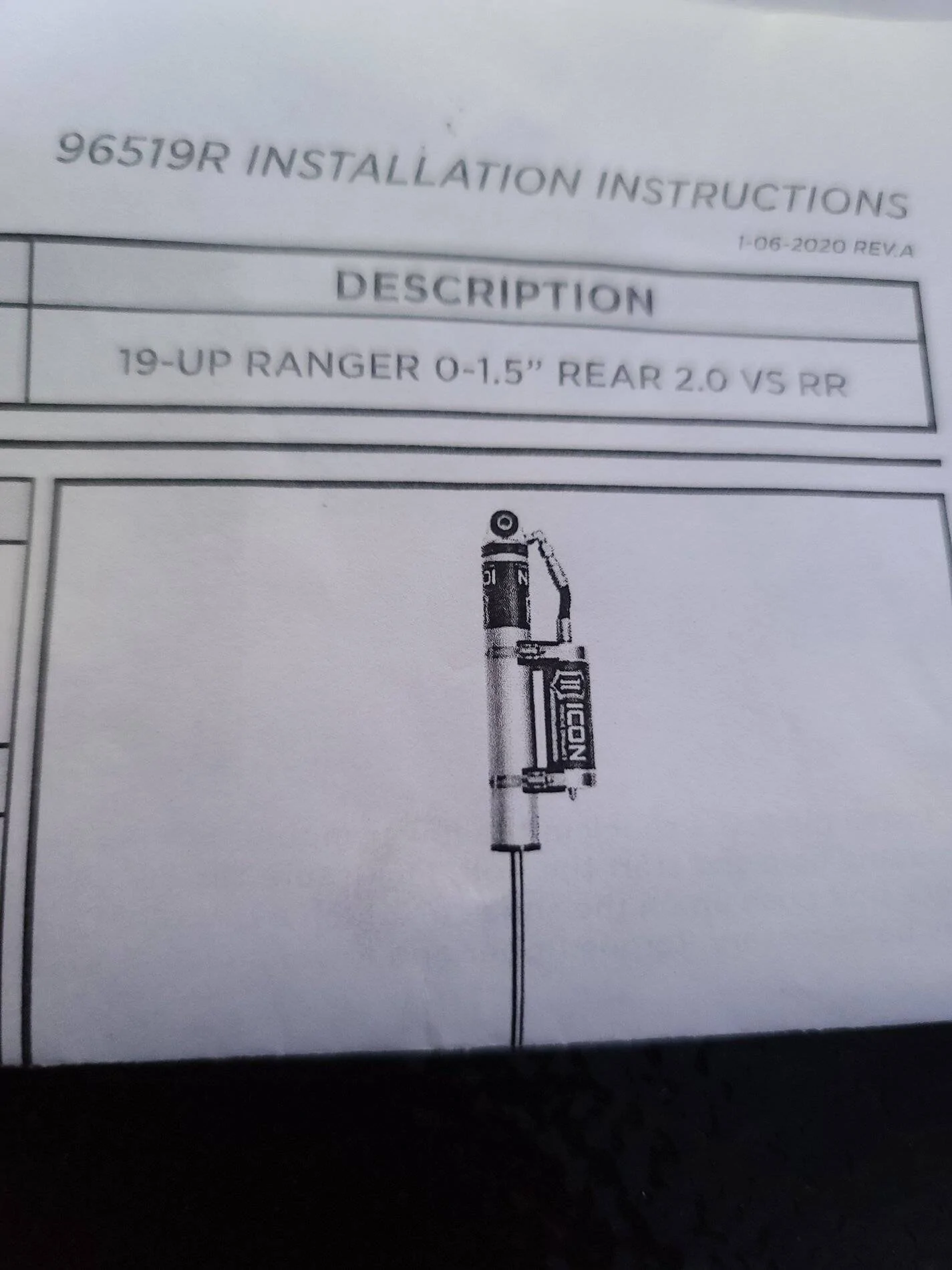

Pretty lame either stage 3 or icon sent me the wrong mounting hardware with my rear remote resi shocks

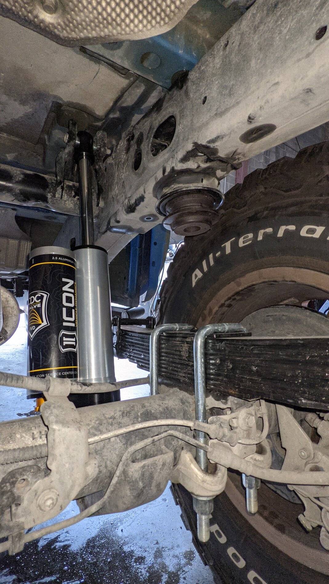

Here's mine
Ya i have the 2.0s the pictures all show a piece between the two bodies and then two clamps I didn't get the clamps or the piece for between there isn't a hard mount like the 2.5s you have.

These are what mine supposed to look like

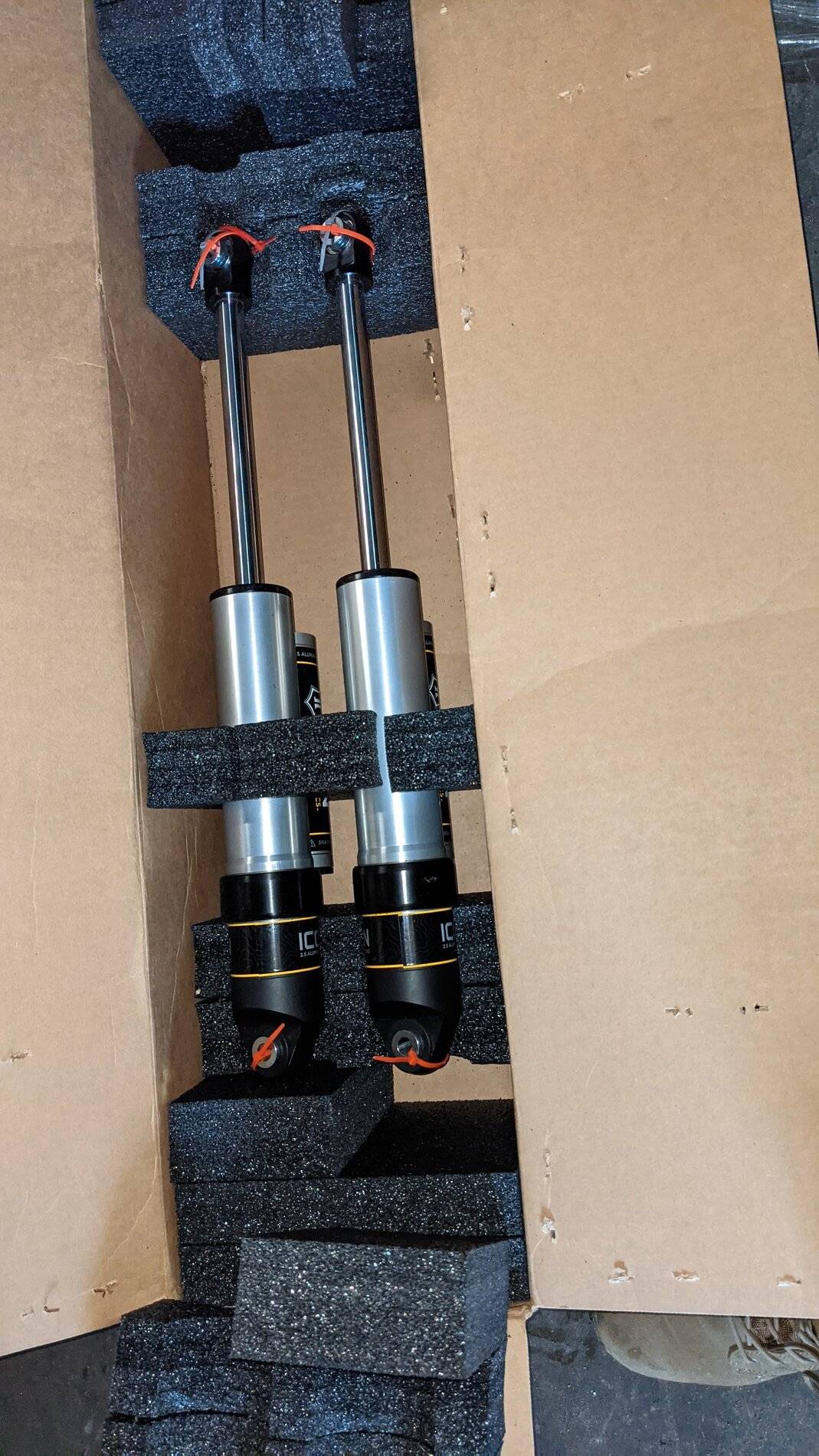

Yours didn't come ziptied?
I'm not sure what clamps you are talking about. The 2.0's look like the mount the same way.

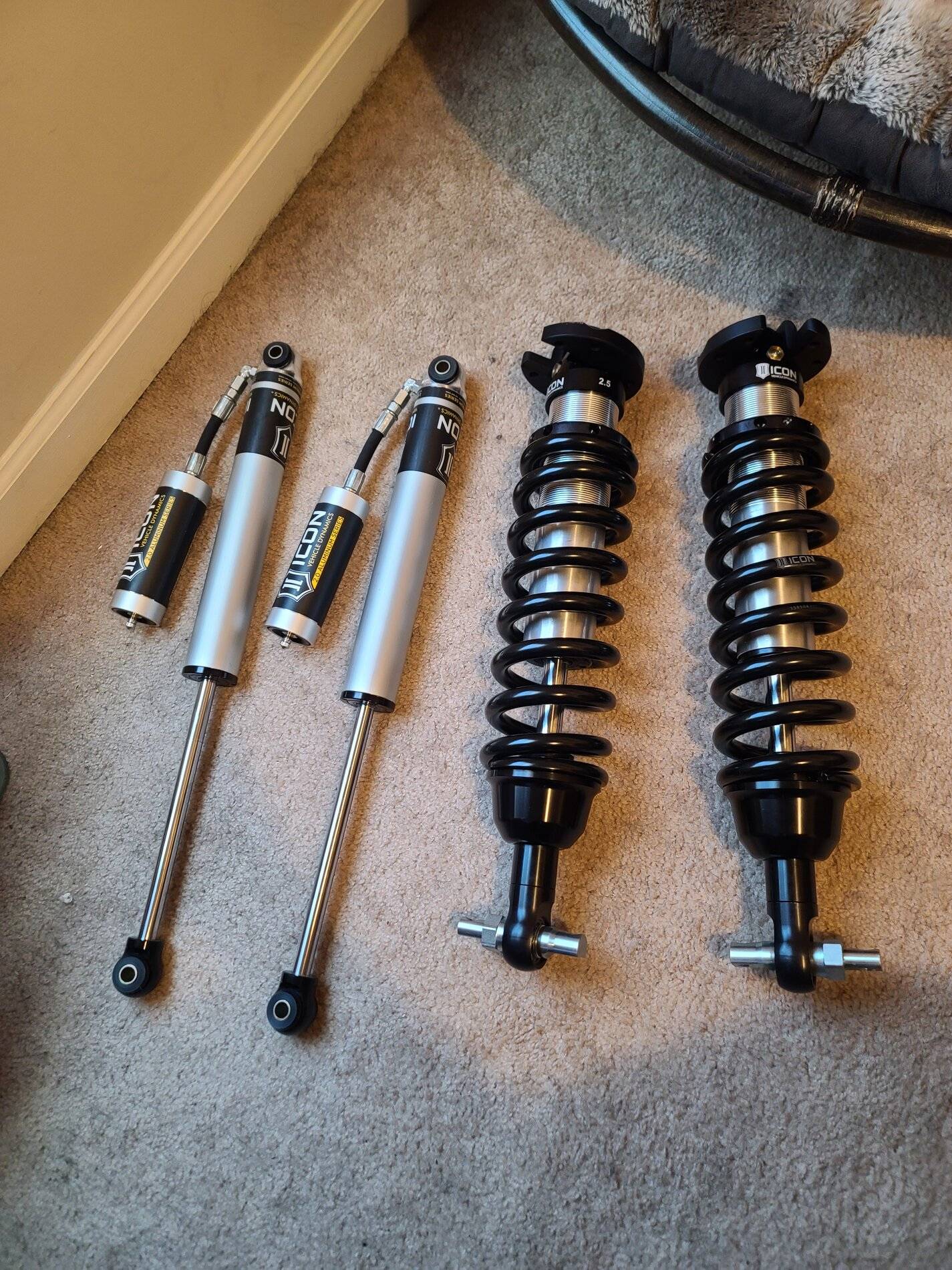

They look so sweet!!
Idk why the bushings aren't attached. Call Icon they should send you some out soon!
