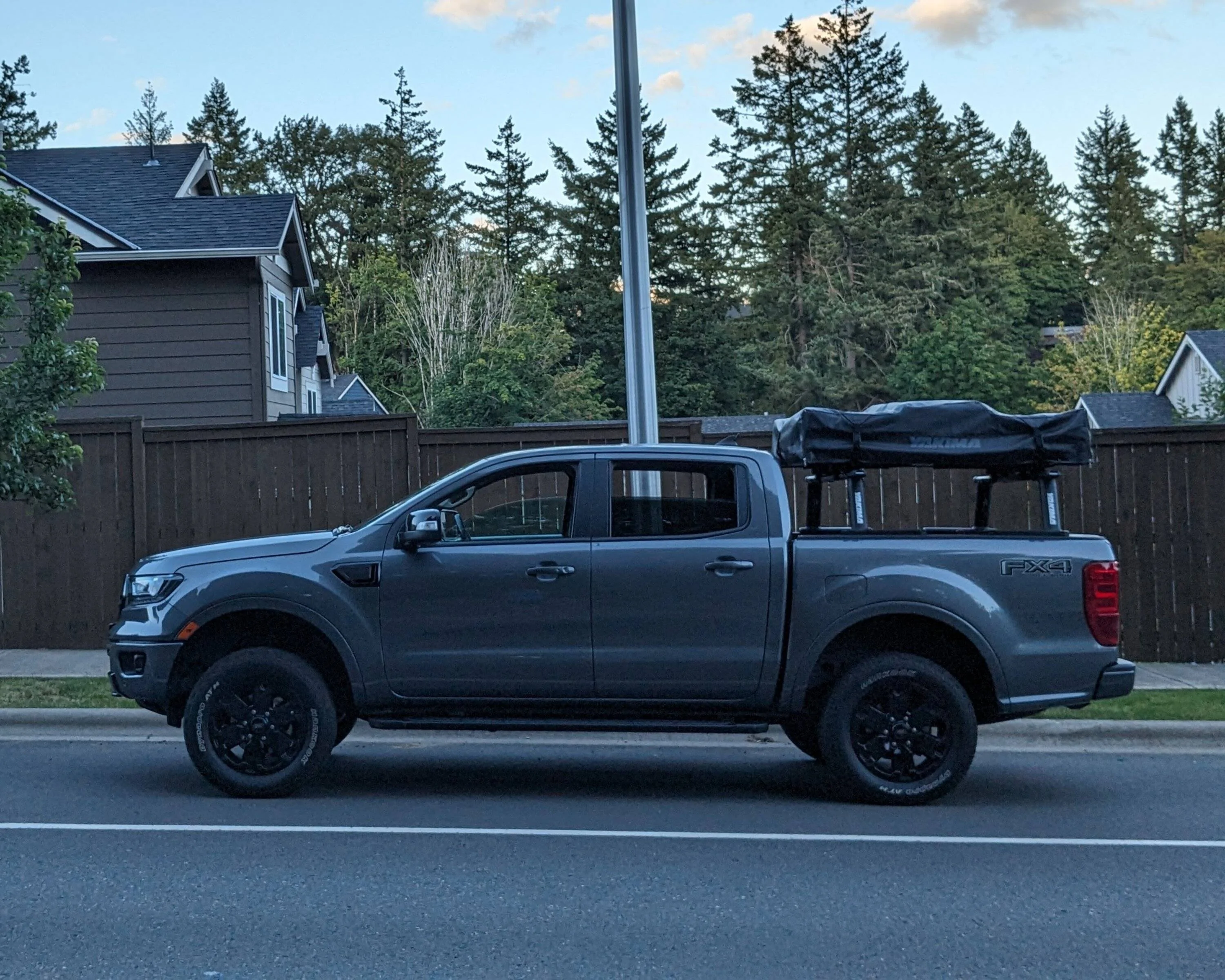

After my install I am approx 37.5" front, 38" rear. I do expect the fronts may settle a quarter inch or so.

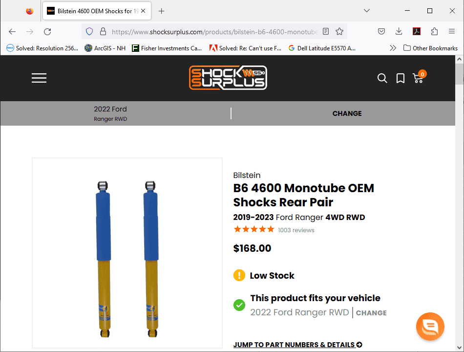

So do you think the Fox rear shocks are worth $160 more than the Bilstien 5100,s
Thank you.
Brian
The is a lot of info on varies threads on this forum about the different shock options for our trucks. it comes down to personal preference and what you are looking for. I prefer Fox over Bilstein for my application.
Edited to add that any option you choose will be an improvement.
Copy that thanks for providing your opinion.
