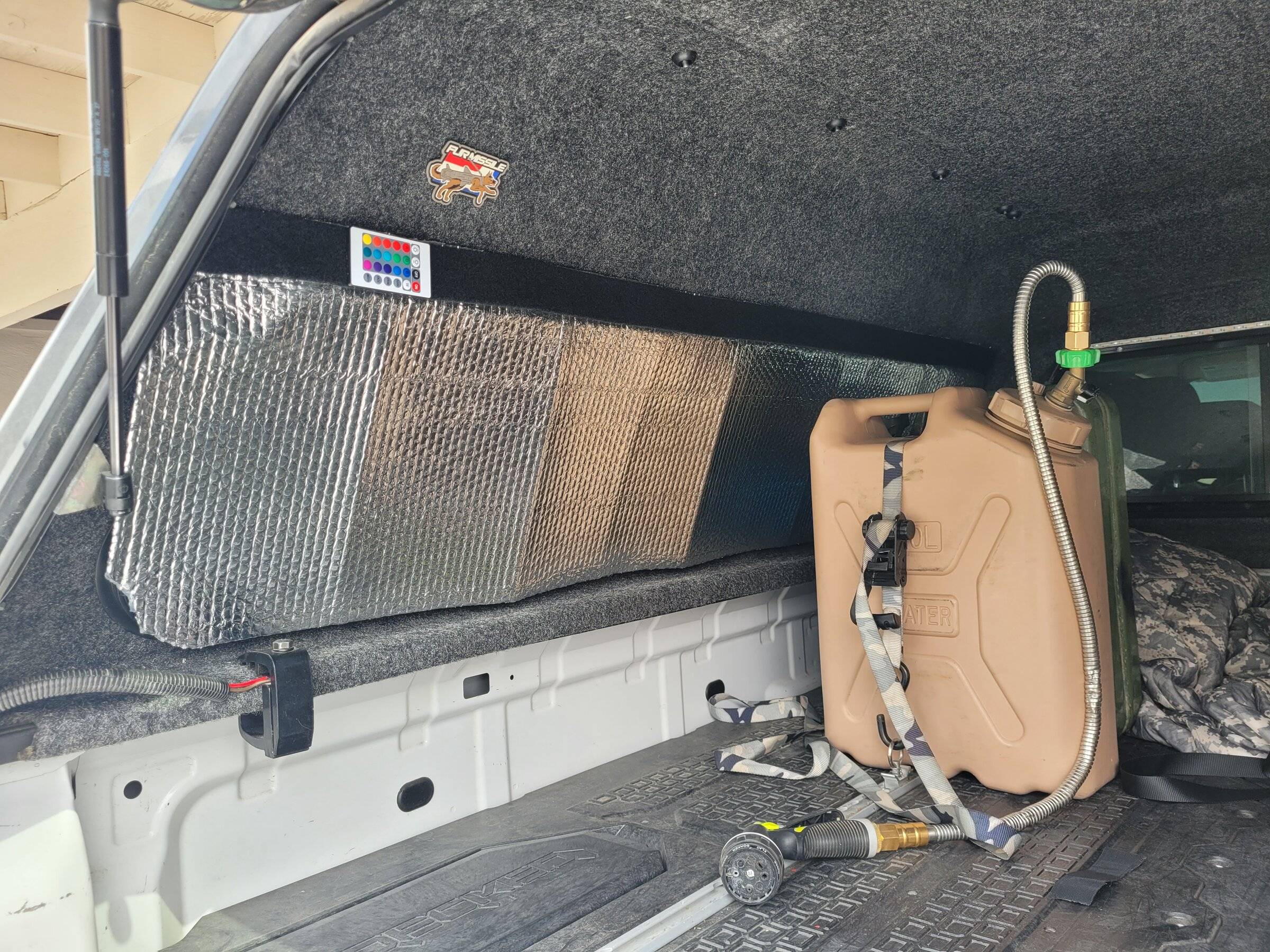

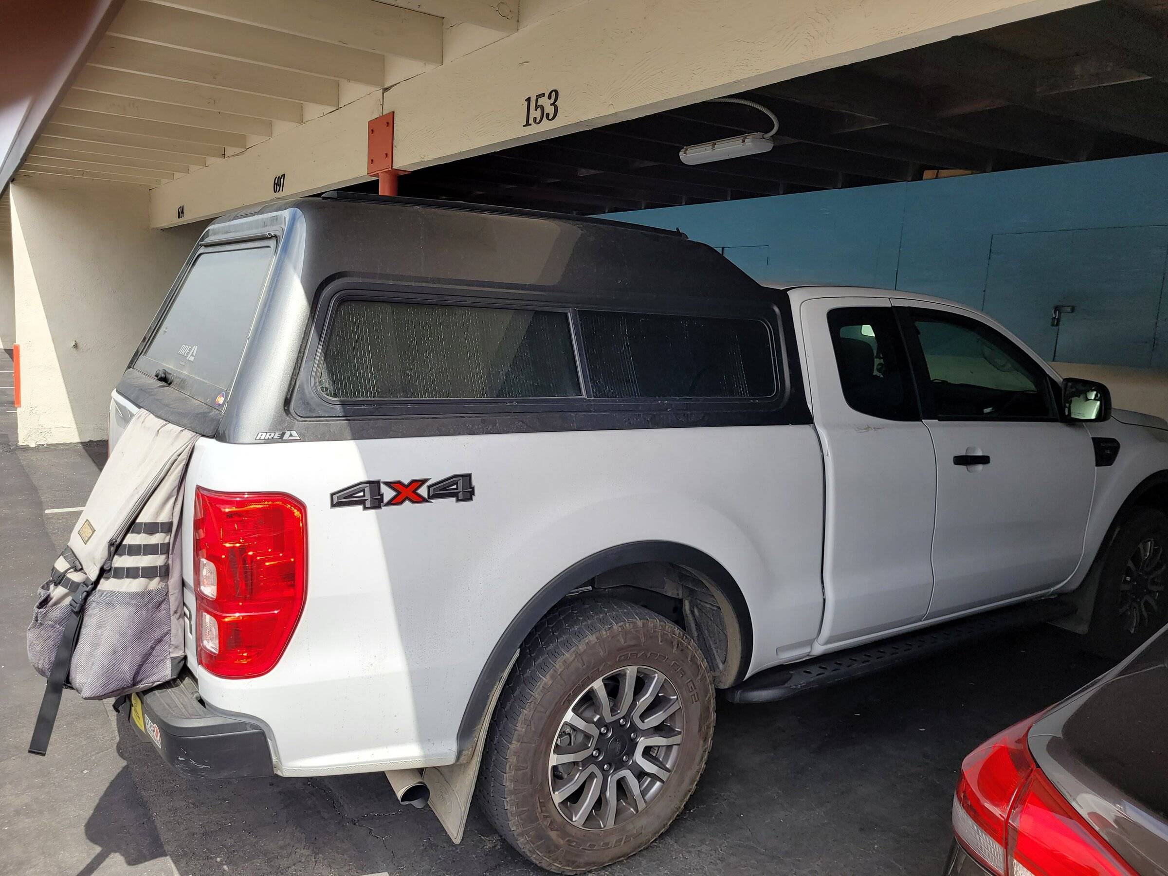

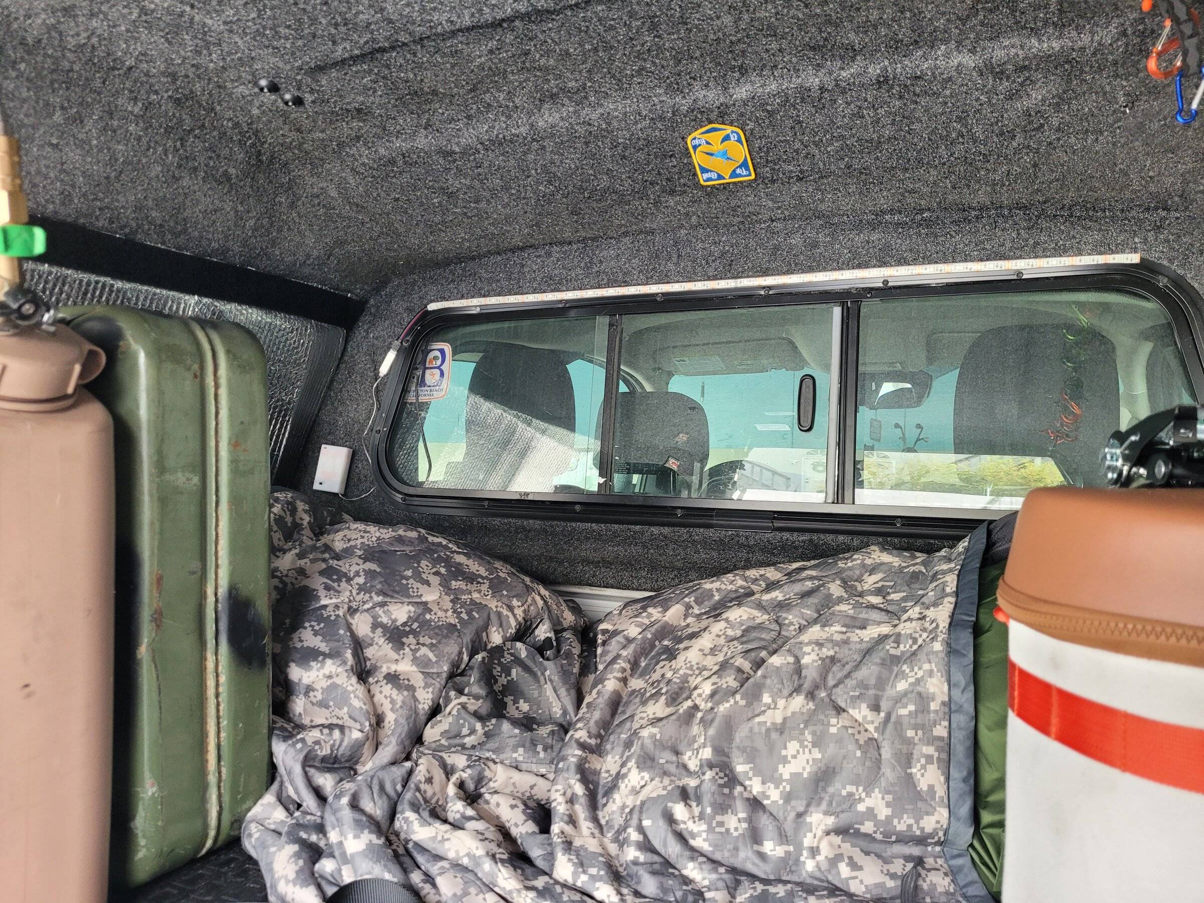

@kaylawiz was a huge inspiration for this combo :)
Finally found a used ARE MX topper, still need to wire up the 3rd brake light, but this is a huge insulation upgrade from the Soft-Topper I was using for the last year.
Did some minor livability mods:
1. Side window insulation (Reflectix panels) via velcro tape
2. mounted my old Nite-Ize Gearliner by using some cheapie picture frame hooks against the bottom of the rail screws. I hogged out the hole with a drill and "tapped" it to match the end of the threads on the bolts protruding inside the topper.
3. I added some cheap RGB battery powered lights for the interior with velcro mounted remote to enable turning on the lights without having to crawl all the way back in. Since they are cheap I might add more to the rear.

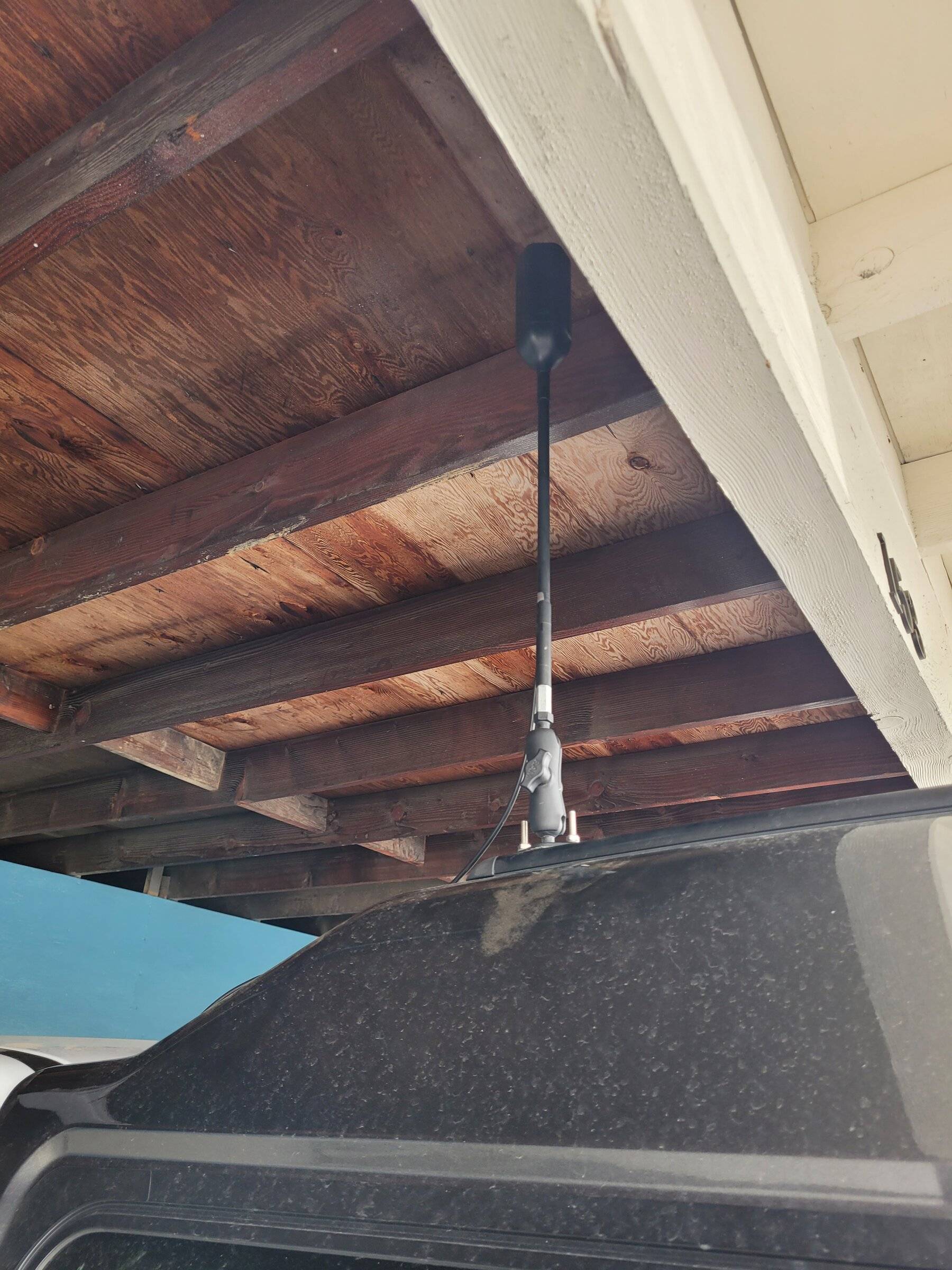

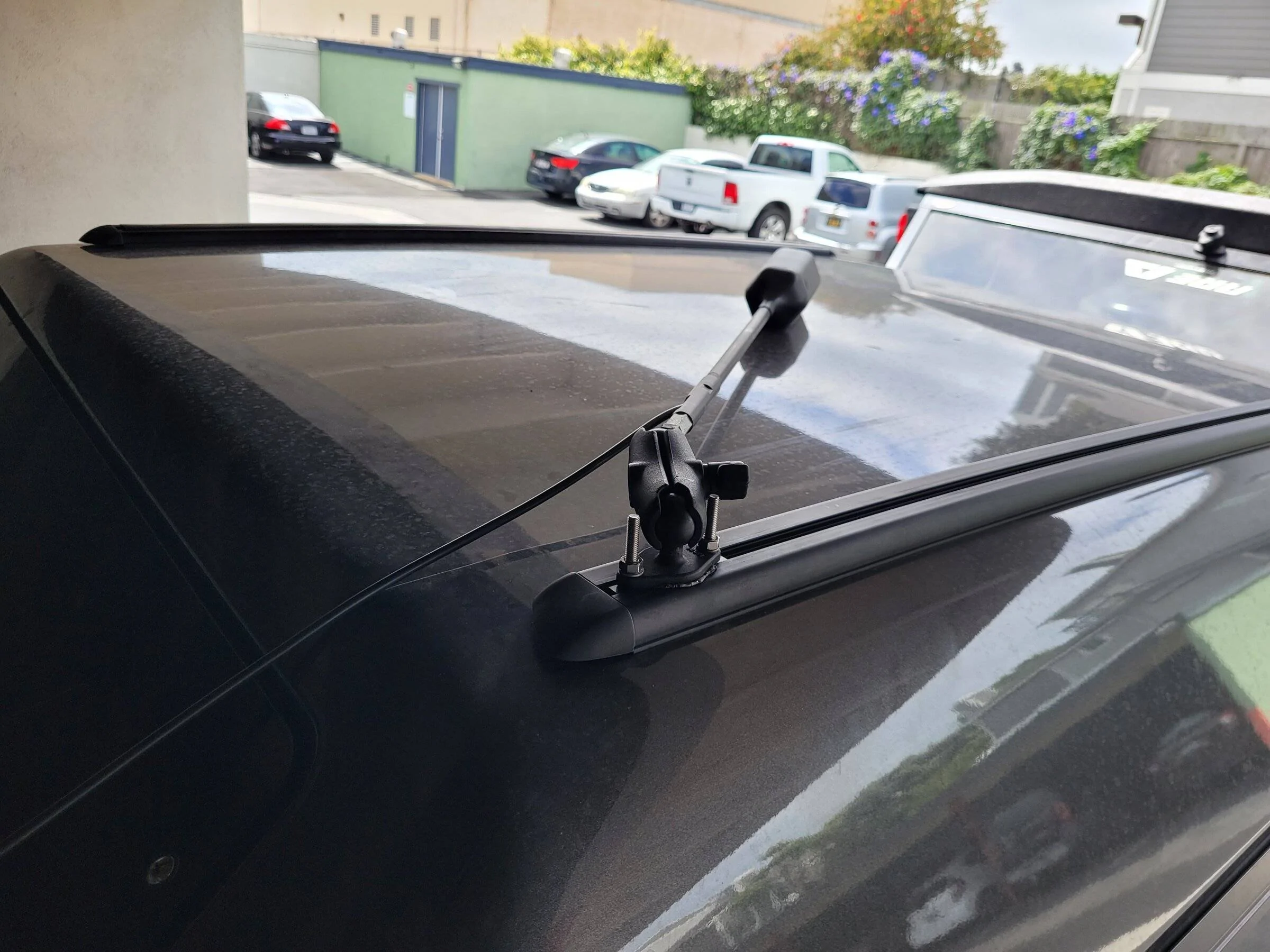

4. Lastly I found some universal T track bolts on Amazon that enabled me to recreate my original We-Boost Cell Antenna set up (albeit shorter).
