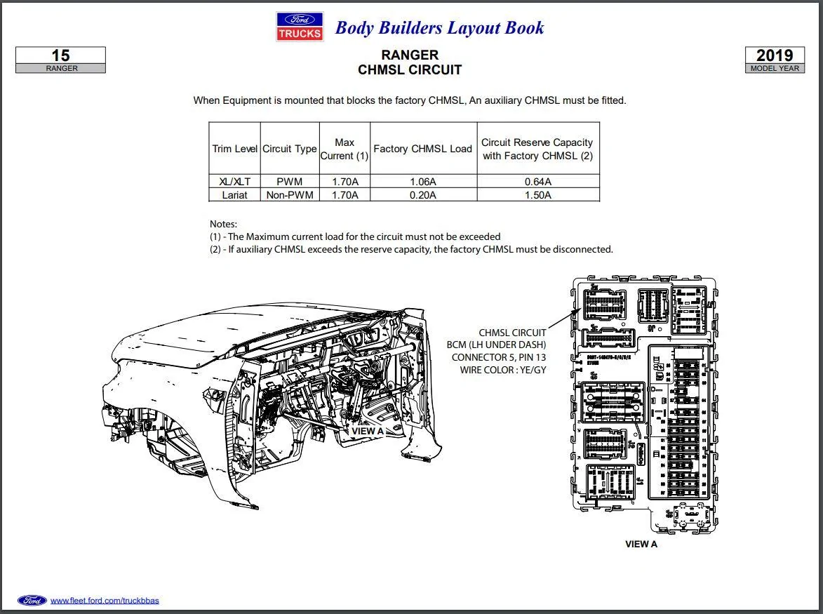

Just wondering if this is the easier solution for the 3rd brake light. The Ford Body Builder's guide shows tapping into the CHMSL circuit on the BCM fuse panel that is located in the driver's-side foot well. The fuse panel is reachable, but sounds like a PIA to run a wire through the cab all the way to the tailgate. I ran wiring for my LED lights on the front recently, and although doable, I don't want to dig into another project like that again for awhile if I don't have to.
Here's where Ford recommends tapping (you can find the complete document here: https://fordbbas.com/publications)

Answered my own question. Was able to tap into the rear tail light harness to get a clean 3rd brake light signal.
