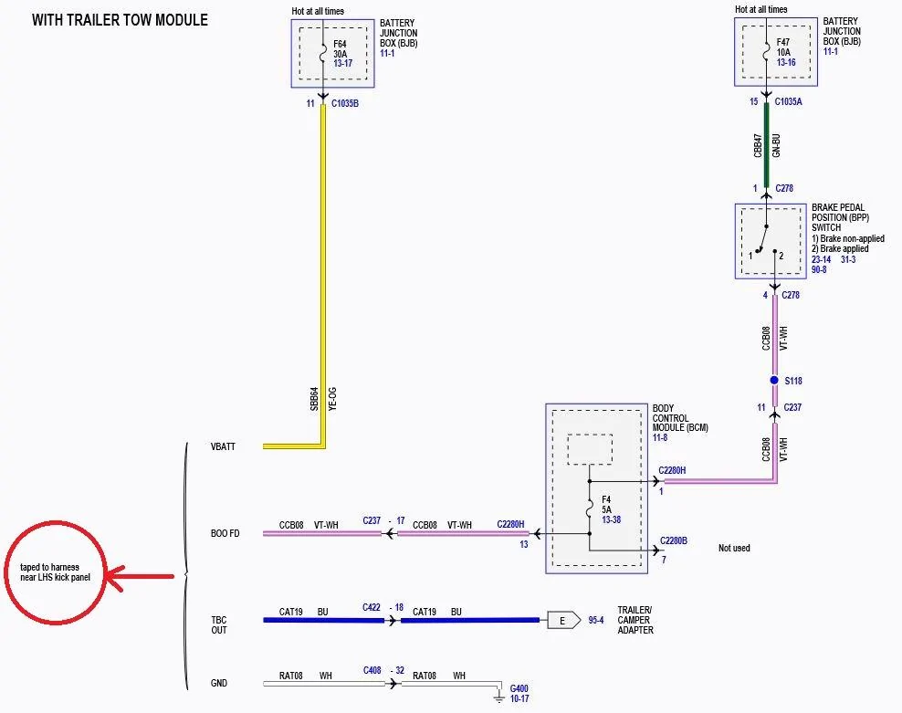

Just for reference, below is how Ford wires in those four wires in case anyone else finds that they are MIA, they can see how to wire it in on their own if they want to copy the original design.
Where is this schematic from? Are there wiring diagrams available somewhere?

I don't think that diagram is right. It doesn't show the signal coming from the high brake light. I don't see how taking it off the brake switch will allow the adaptive cruise and emergency braking to work. I spoke with the installer at some length about the install. He said the Ford instructions had him taking the brake light signal from the high mounted brake light.
I believe the diagram is showing the path for the 4 wires that are supposed to be taped up under the dash. Not showing the wiring for the brake controller itself. If I remember correctly the Ford brake controller only uses the yellow and blue wires since the harness has a ground wire with ring terminal that gets installed on a stud and the signal comes from the 3rd brake light. So the violet and white wires are unused.
