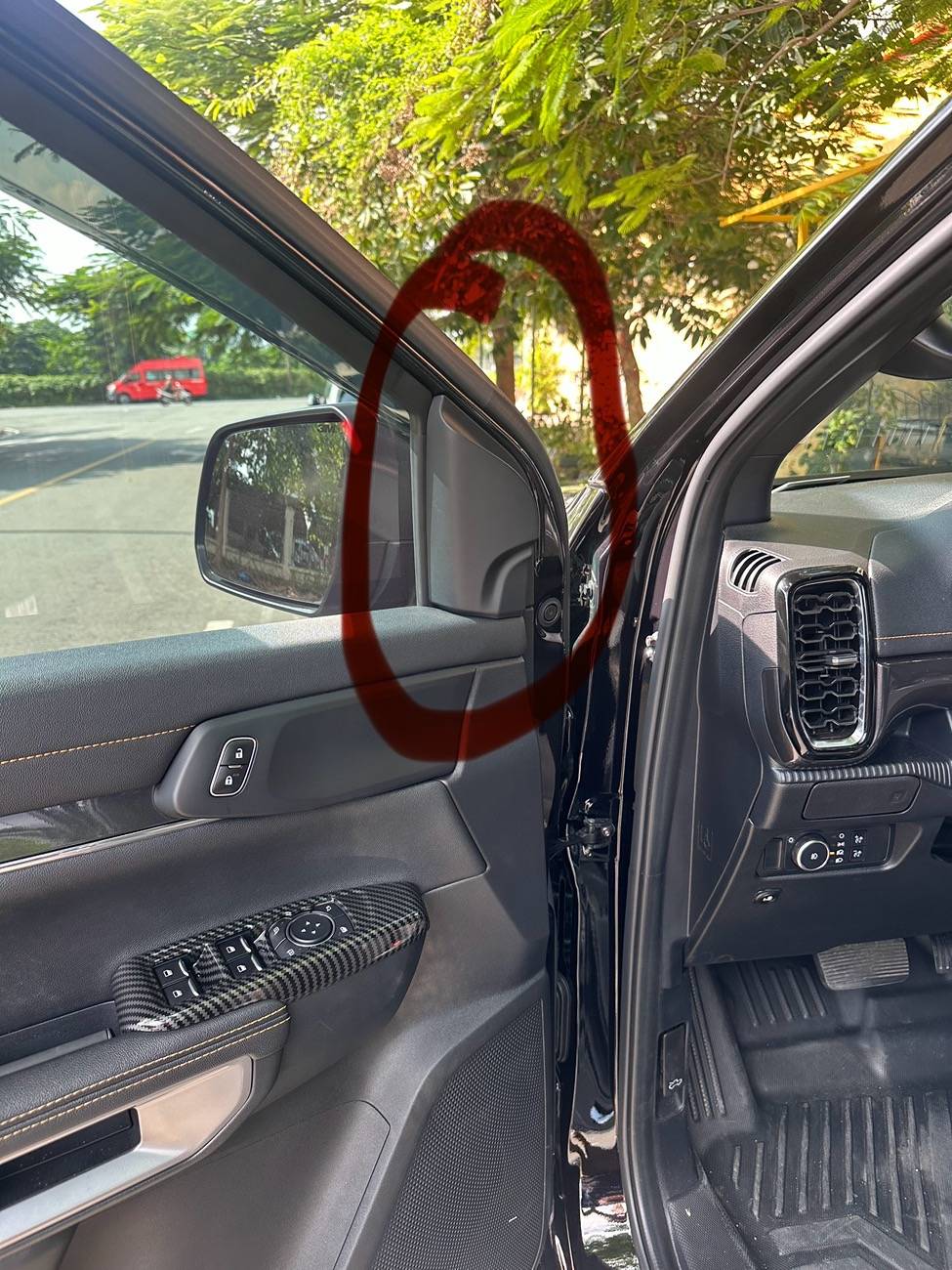

Install more tweeter speaker on ford ranger 2023. Help me

who did help me ?
I can't find a speaker cover for this job. If I cut and paste it I'm afraid it won't be perfect.
I use tweeters pioneer and Installation position behind the mirror as shown in the picture
With old Ranger models (T6, T8), this speaker cover is very popular, but not with Ranger T9 (2023).
Thanks!

Since the parts diagrams are not uploaded for the (US Version) 2024 and also it appears the (sail panel tweeters) were deleted on the 24 (6g Version) and they moved to the pillars above the dash
I see 2 options to mount them in the sail panel.
Drill and Glue (seal)
or
TRY: the previous gen (sail panel) and see if it fits.
Pull yours and take to salvage yard to match, size and fitting of the attach clips
