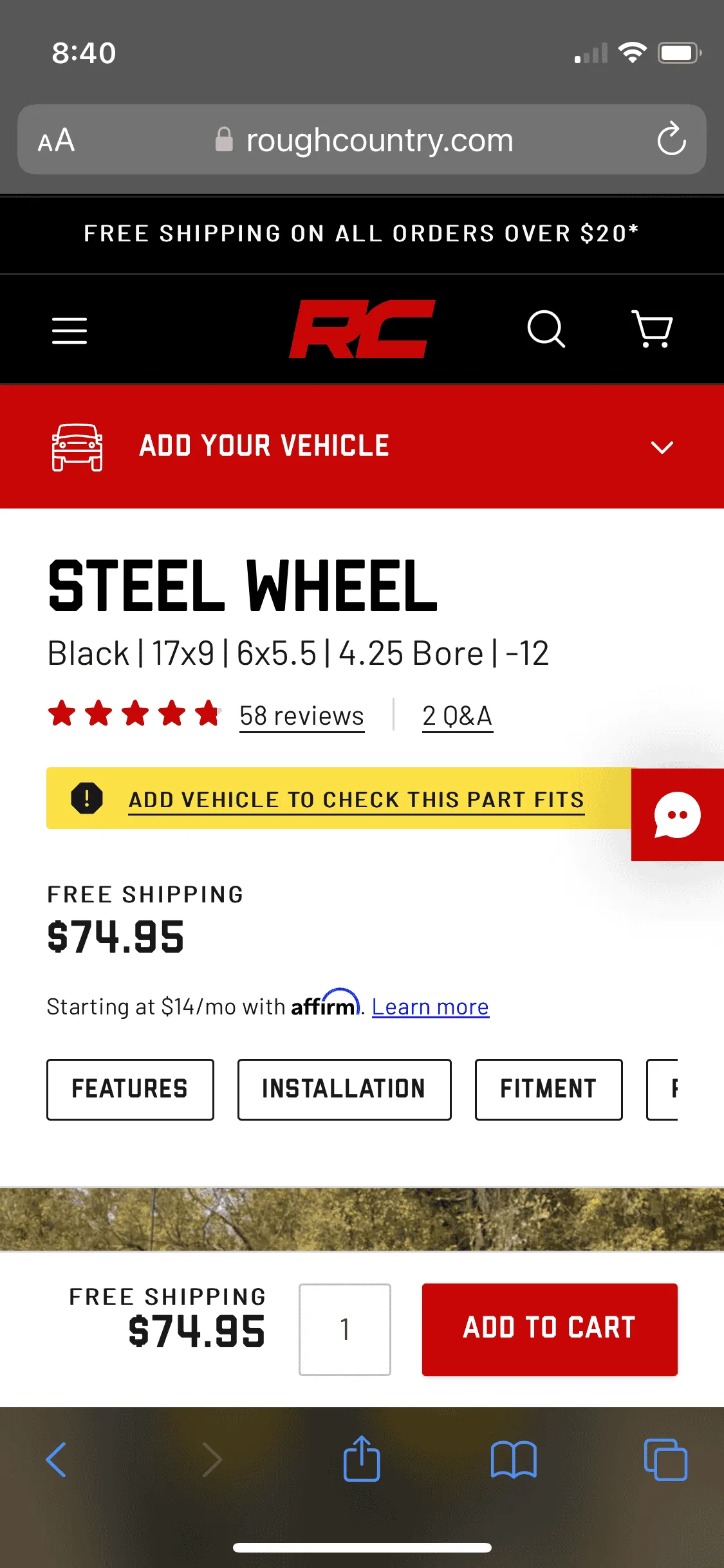

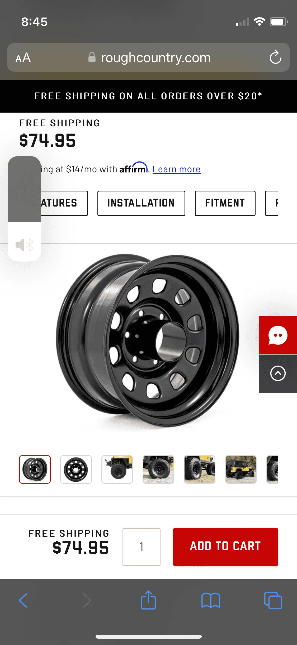

Yep, this is the style I was referring to. Seems like there's a few in size/offset but no one is running them

Just something to be aware of, the link posted is a -12 offset. Stock wheels are +55. 0 offset stick out a bit past the fender, so -12 is going to be real out there.
I did the math after I posted. looks like they stick out about 2.64" more than stock. Might be a bit much for me with just a level kit.

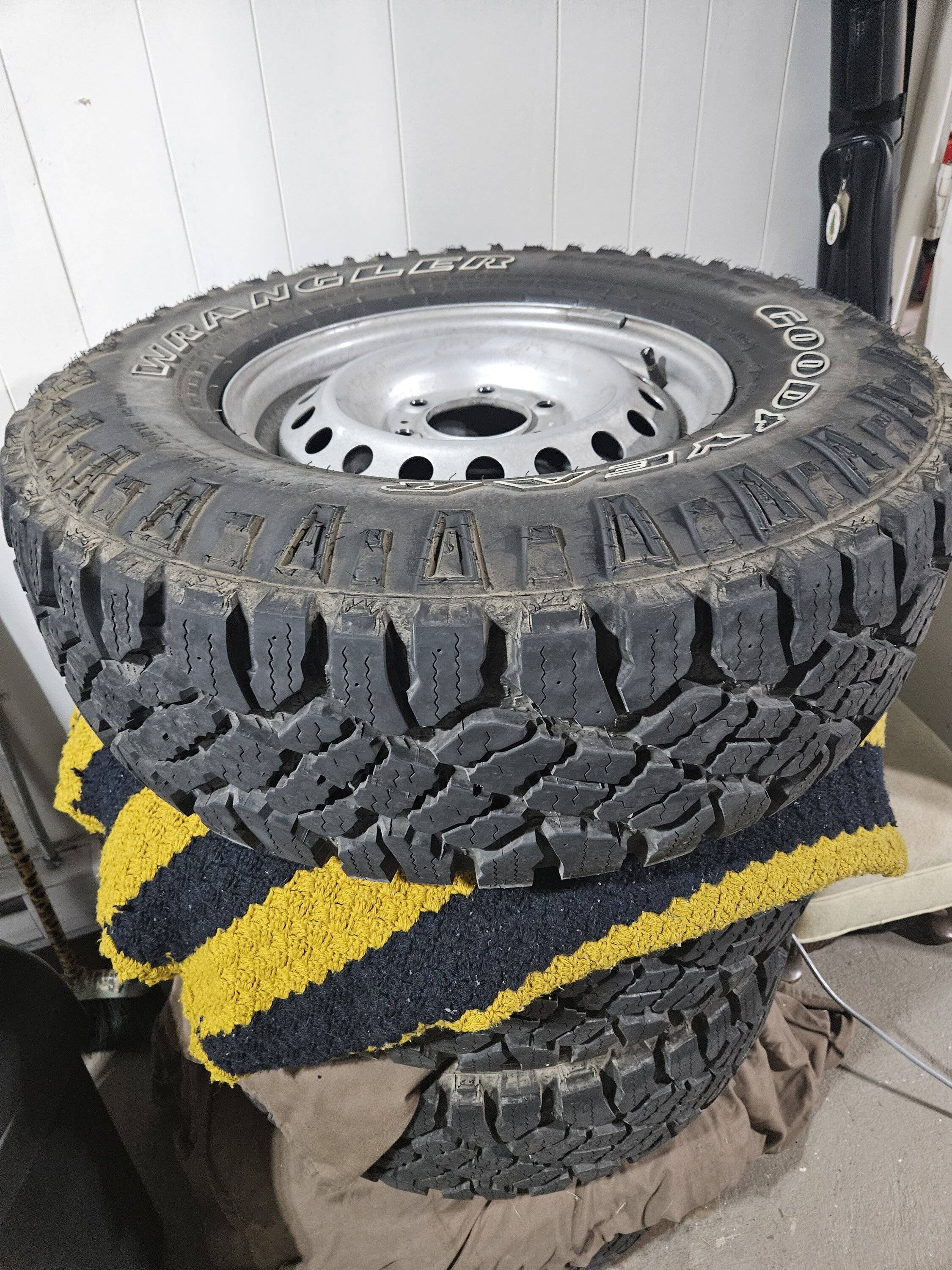

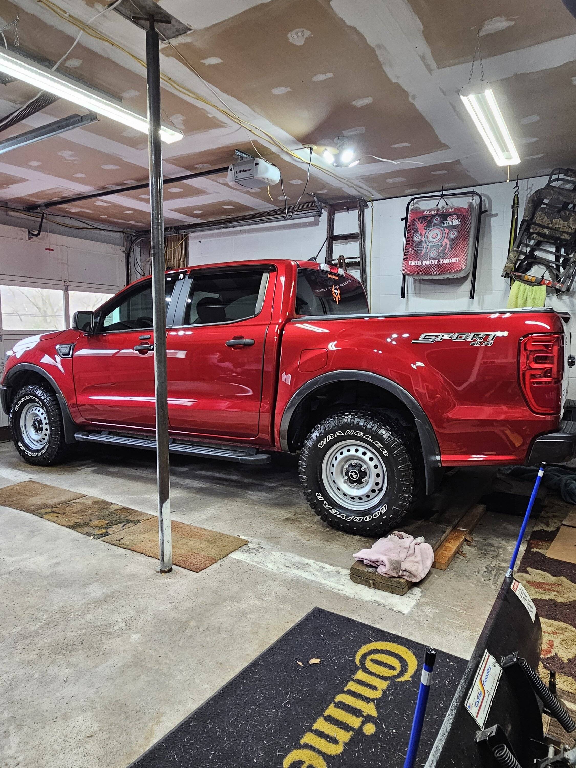

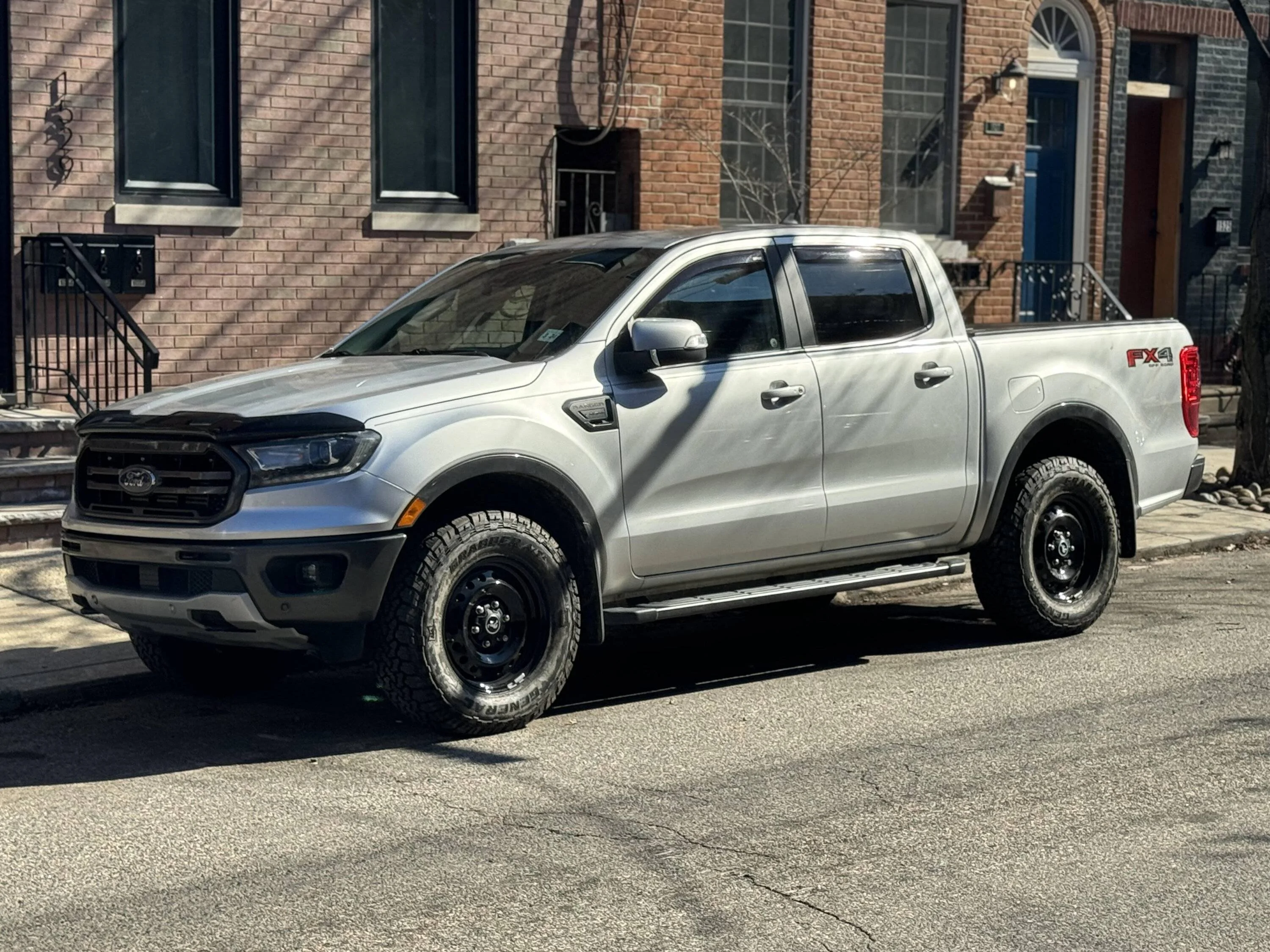

Ok so I ended up finding a pair of Bronco (Black Diamond) steelies and confirmed they're the same hub pattern (or negligible if different; wet on fine) and offset (+55), so put them on. Can confirm:
  • They fit stock (FX4 suspension and unmodified crash bars; 265/70/17 is ~1" > factory 265/60/18)
  • Doesn't rub forward in full lock but will have to test in reverse
  • Definitely noisier, but an unscientific phone meter says only 1-2 db increase overall across ~30-70mph (it's just the obvious knobby hum more than anything)
  • The full size spare fits in the stock spare place, but doesn't seat as firm as I'd like
  • Checking threads on the bronco forum side and comparing to stock, I think I gained ~6lbs unsprung mass per corner, which is slightly noticeably on the butt-dyno
  • TPMS appear to be the same frequency and talking as normal, have not had to recalibrate yet; overall size difference should mean ~2mph (slow) speedo difference
  • Lost about 1-1.5mpg as well (mixed highway/city), also expected
