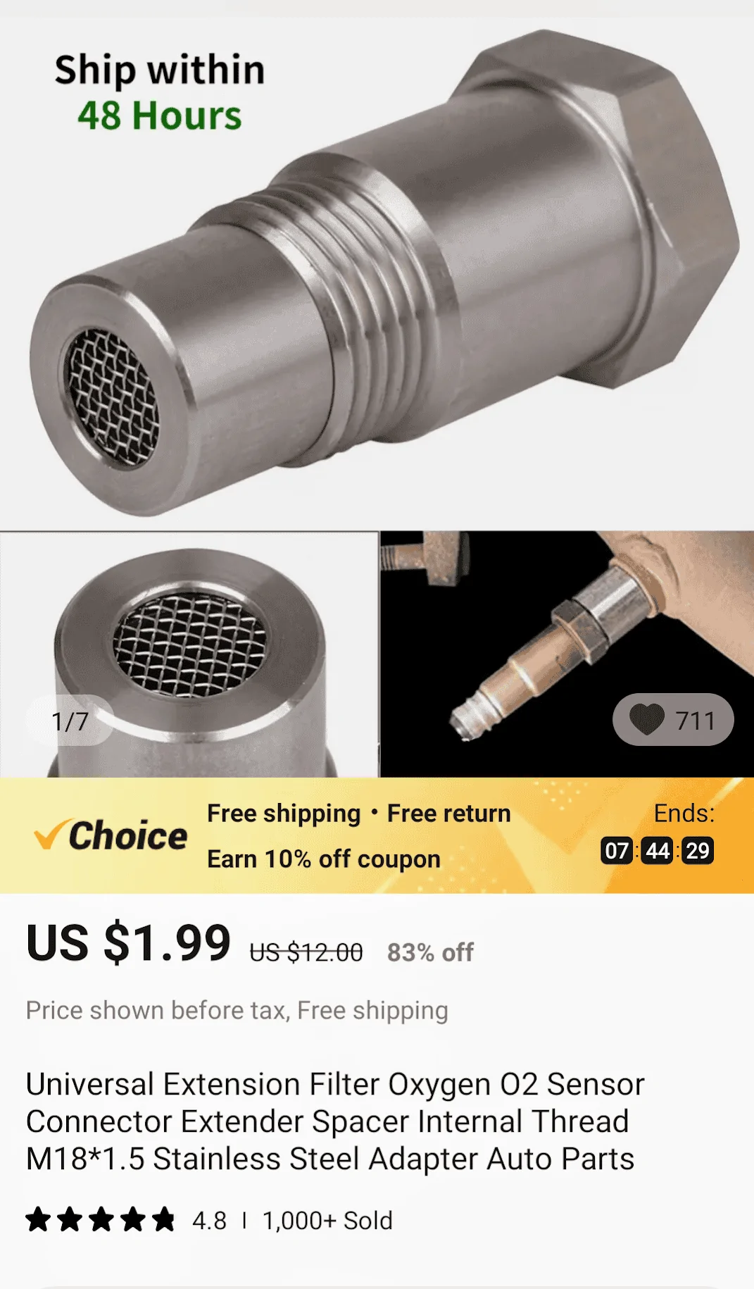

I think @CVF-Jason that they offer a 3 inch outlet and the step down is an option..
That said I think going 3 inches is going to be a performance boost behind the turbo but in the Mustang forums as well as here the factory computer seems to want to throw codes de to the change in flow. I'm not sure if that has been universally resolved. I think there is a O2 sensor 'defouler' that needs to be added (?) but they are 'illegal' in America. Maybe one of those foreign vendors who skirt EPA control can 'help.'
