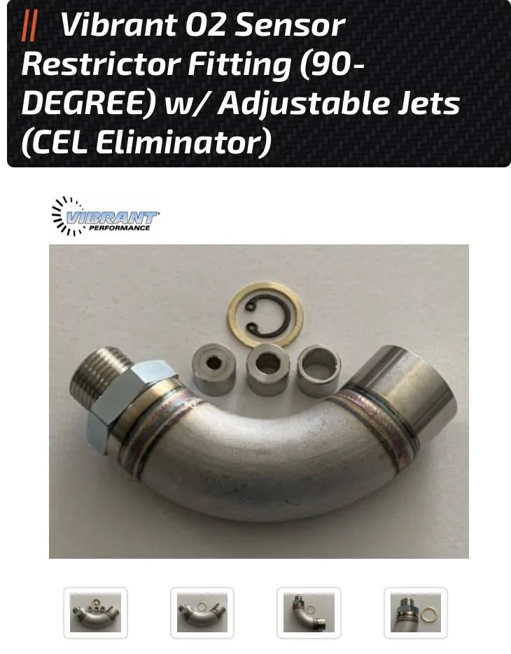

Yep, it’s all in the same. The defouler is a spacer for the sensor, basically pushes it back a bit so the sensor doesn’t pick up as much of that high airflow, so doesn’t throw the flags.

Yes I have a friend who put one of these on his catless DP on his Ranger with the smallest restrictor fitting like 6 mos ago and still CEL free. Just make sure the J points towards the turbo vs towards the muffler from what I understand as that makes a difference. Ebay has had all of these defoulers removed due to EPA crackdown, so grab one soon if needed:
https://fasthemis.com/i-23894159-vi...-degree-w-adjustable-jets-cel-eliminator.html

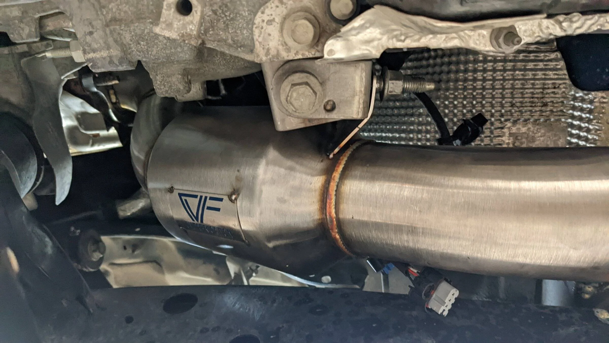

Update:
Got the downpipe on this morning before and I'm uploading the tune!
The install was honestly a pain in the butt for most of it. The three nuts I actually loosened up first and without a ratcheting wrench man it was tiring, and very tight of a space! Good thing I can stand on my bumper.
The most annoying part is have to say is disconnecting the O2 sensors, for me at least. That was a real PIA.
The downpipe comes with a sheet of paper explaining how to turn on the truck and hold some revs to break in the new cat. I'll break it in and post about it after a while!

I'm due for an inspection and it's time to take the defouler out of the glove box and onto the downpipe. Did you guys use the restrictor with the smallest hole or the biggest hole? Also did anyone add the defouler with the downpipe installed already? Hopefully I can fit a wrench in there with the downpipe installed.

@Superdannyboy - My friend uses the smallest insert. But to clarify this is only needed for catless downpipes.
Your downpipe is catted so should pass inspection as I would think the catted downpipe doesnt cause a CEL. Also, I’ve never seen an inspection failed for the presence of an aftermarket cat.
