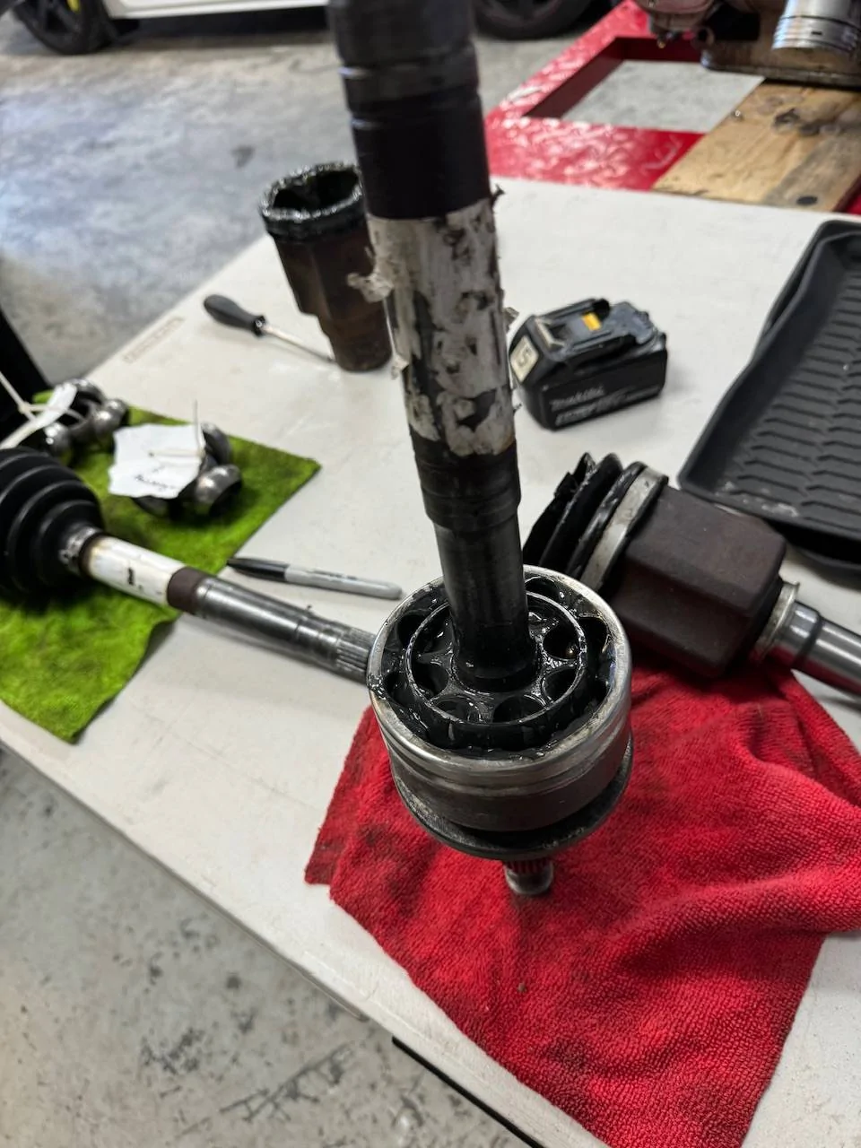

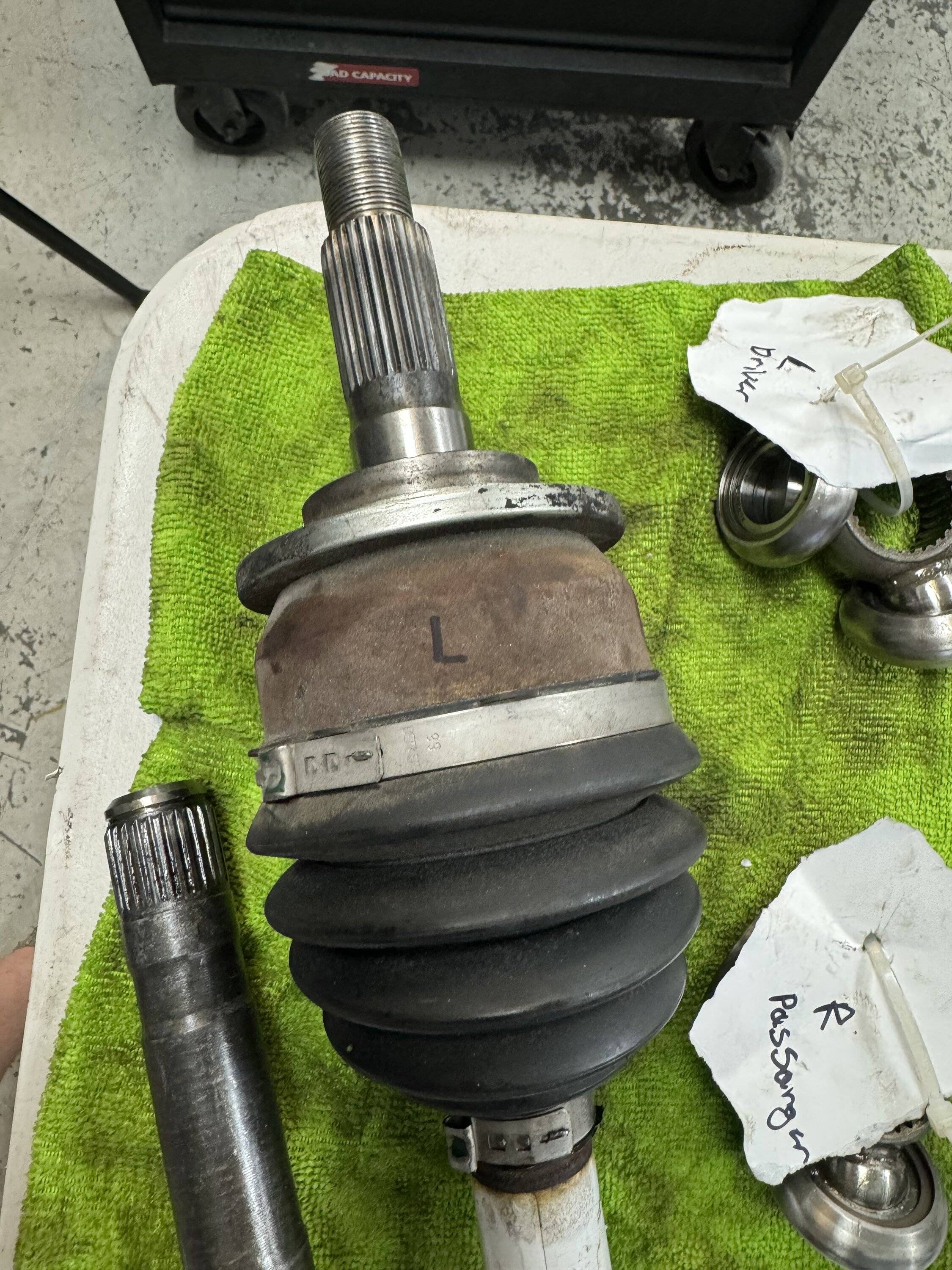

Hey 916ranger, there is a clip underneath the bearing race that is a huge pain to remove. I tried doing that same on my own, then took it to an axle shop. They couldn’t do it either without saying they might damage the axle.
I ended up taking it to ORW and they cut off the axle near the bearing cage. Then flipped the bearing cage over and removed the c clip. Both my stock axle shafts had to be cut off in order to install my longer axle shafts.
and it’s not a c clip where you pinch the pliers to remove it. It’s just a regular c retaining clip. Hope this helps.

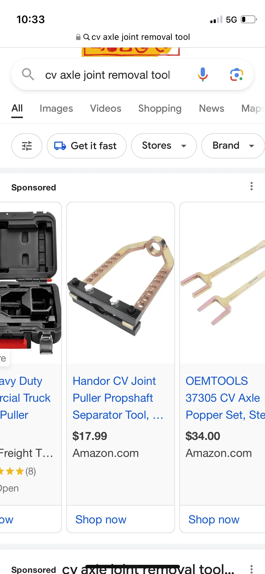

For reference, ORW charged $250 for one axle and $300 for the other. I took them in at separate times.
if you wanna save money and still try it yourself, I think a tool like this might work, although im Not 100% sure it will work but from watching some videos it looks pretty promising. Last resort you can just cut the axle yourself with an angle grinder.
the tool in the middle for 17.99

I’ll definitely try it myself and if worst comes to worst I’ll take it in. Thanks for the help!

Question, did your cv shaft from Baja kits fit into the oem tripod bearing? Or you went with another company
Yes, they used my stock cv ends. The tripod should go in. You might have to tap it with a mallet if it doesn’t feel like it’s going in. It might be pressed in from the factory.
