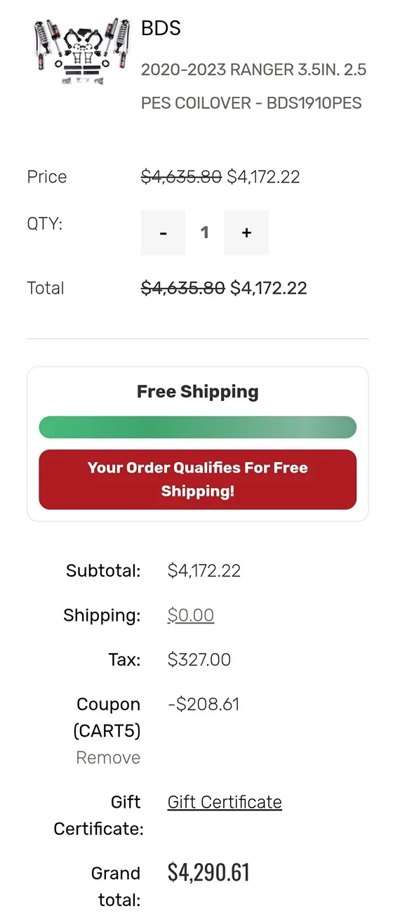

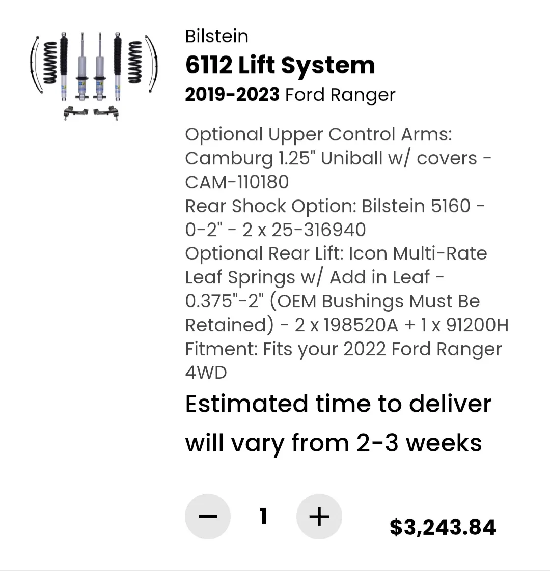

I'm seriously considering the Ranger 6112 Lift kit but I don't want to drop $3300 on them unless the off-road performance is mind blowing. My 1st option is a $4300 Fox 2.5 BDS 3½" Lift kit.
I've driven the Fox 2.5s off-road and they are amazing. I would love to save $1000 by going with the 6112 kit but I'm just not sure if they measure up off-road...
