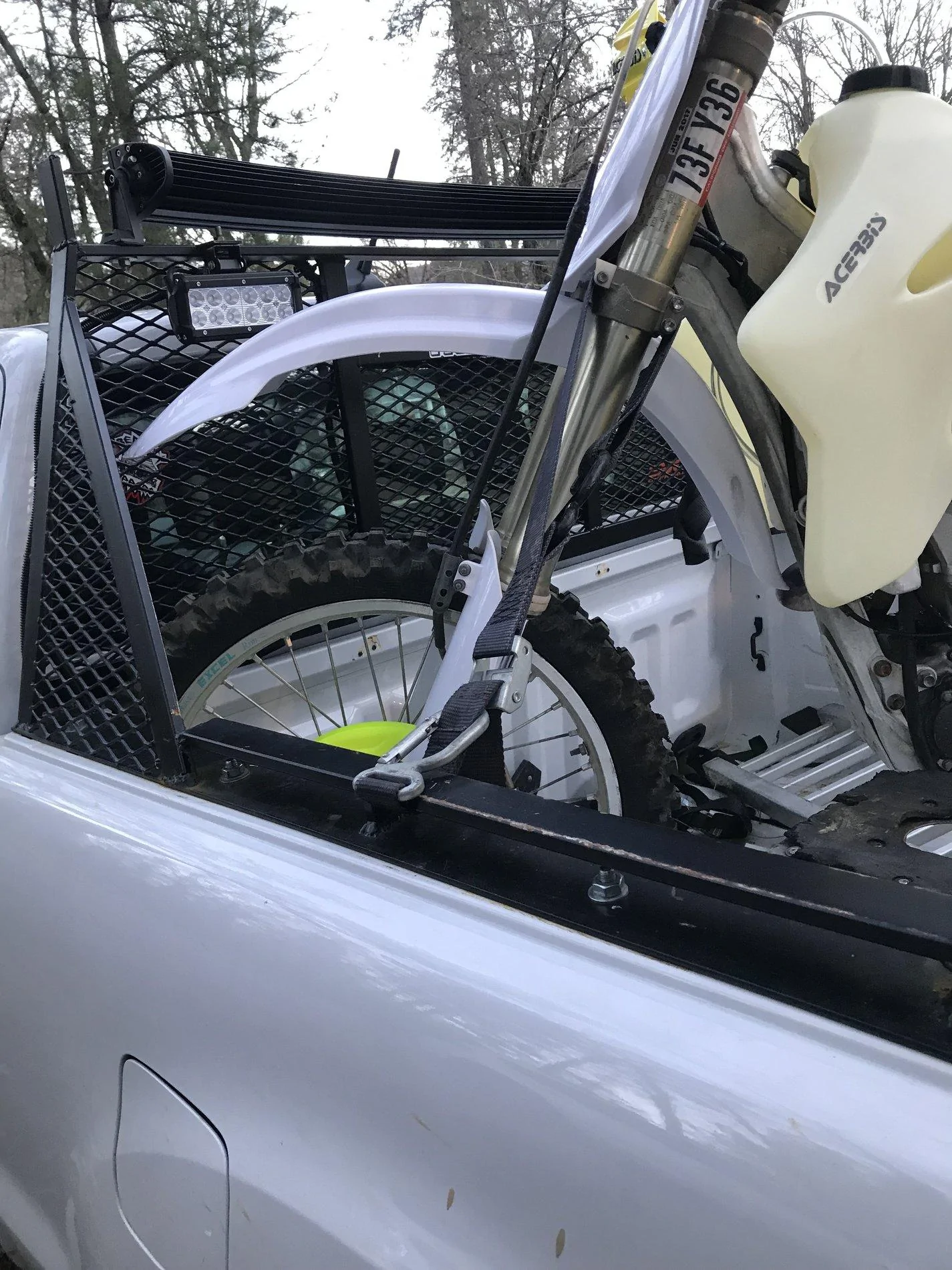

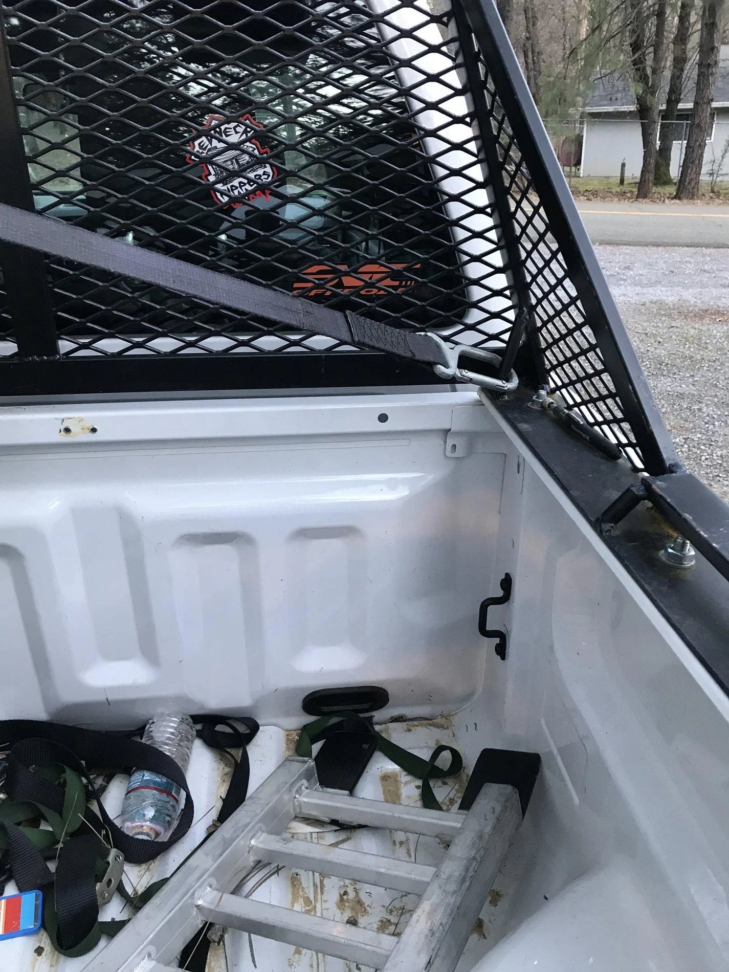

Sorry to be off topic but what brand/where did you get that headache rack and side rails? I am having trouble find ones that mount the way it looks like yours do. Very cool and useful looking!
Hey thanks for the compliment! I actually built that setup. I’ve done a few in the past on other rigs so I had a idea of what I wanted on the Ranger. 90% of why I did it is for how useful it is, multiple tie down points are great.

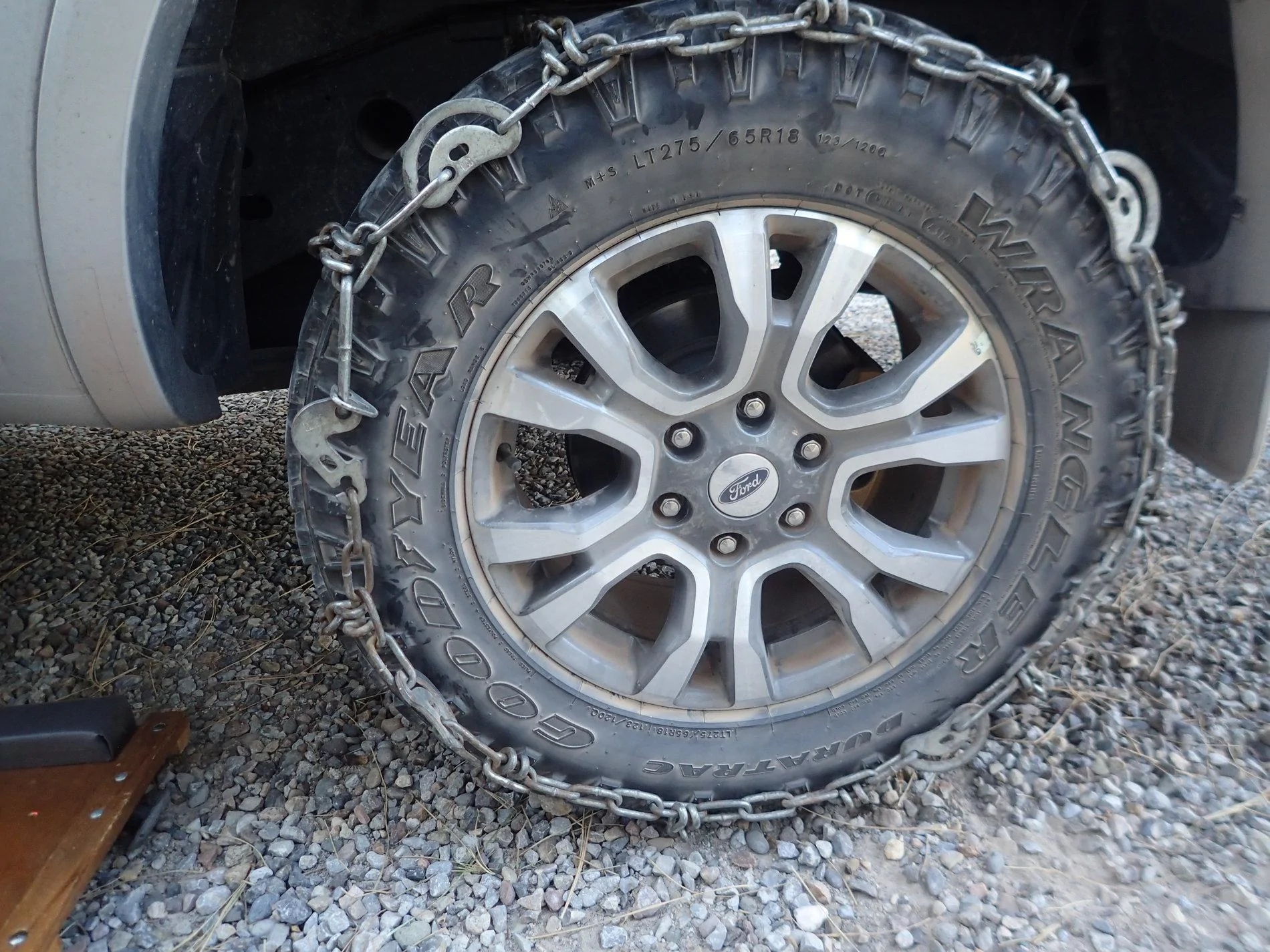

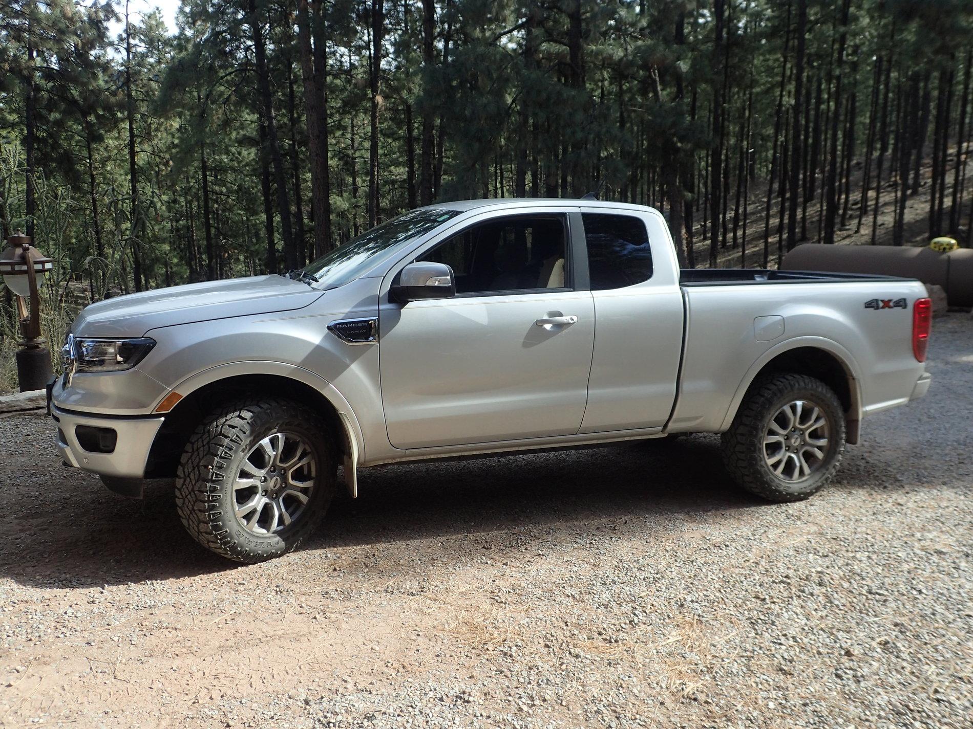

Another item to remember when discussing fuel economy is that the refineries change to their inferior winter formulas, so it is not just the cold weather that is reducing mpg. If you changed to larger tires at the same time your gas changed to winter formula - and the temps dropped, you have those additional variables to consider.
Because I live in the mountains, sticking with the "test-drive" tires over the winter would not work. So, I bought a matching set of take-off 18" rims from a gentleman on this site and mounted a set of M/S tires to change to for the snow season. This was a far less expensive option than I would have thought at the outset, with the deeply discounted cost of the rims and the excellent set of 'pre-owned' Goodyear Wranglers I sourced in the North Valley.
These tires are 3/4" taller than stock (changing from 265/60r18 to 275/65r18)giving me worse mileage by 1-2 mpg. Also, my speedometer error is 1-2 mph and we have some highly dedicated speed-cops to beware of around here.

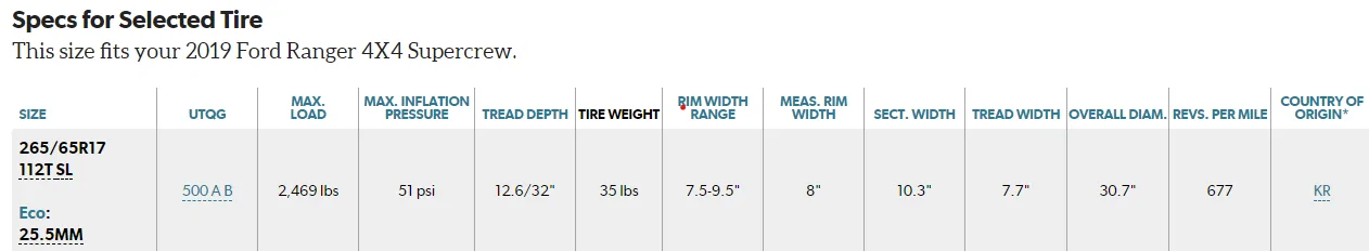

You may already know this but on sites like Tirerack you can click on specifications to see things like tire weight, etc.
OE Hankook specifications:

Tire rack lists weight for each tire.
Stay away from LT's. The ranger cannot tow/haul enough to need 'em.
Amazing how much variance exists between the same size tires - Even stock size. The stock all terrains my ranger are listed at 34lbs. That is awfully light.
