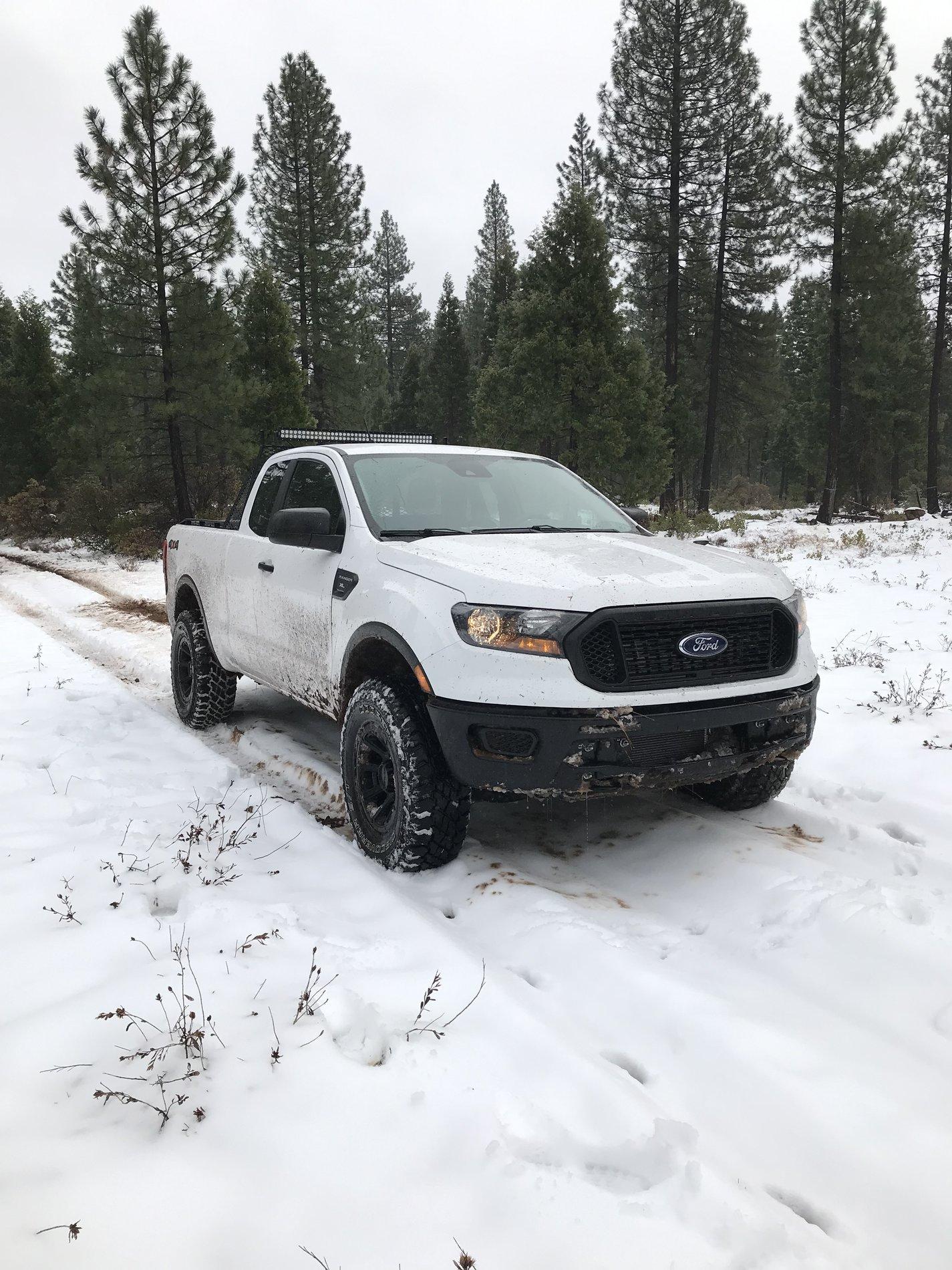

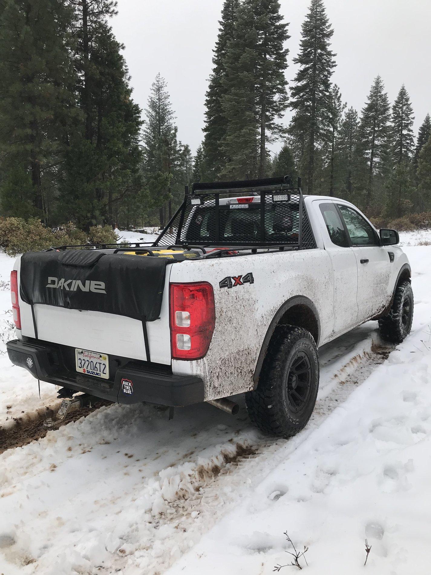

Welllll... it was fun while it lasted. I put LT265/75r/16 Cooper ST Maxx tires on my Ranger. Looks awesome, tows great. But my power and fuel economy took a pretty solid ding. About 3-4mpg. So back to stock Bridgestone duelers and not be so cool.. Tires for sale if anybody is interested. local pickup only Redding California

I think the lift and low offset wheels that stick out past the fenders have more effect on mpg than the actual size of the tire.
also the light bar above the roof probably doesn't help at all

The LT tires are a lot heavier and have more rotating mass which = poor gas mileage. I put the 265/70/17 on mine but they're not LT's and I'm still averaging 21 mpg's. You're right the other stuff does have an effect too but those LT tires are really heavy.
Edit: Your truck looks really good with those on Tyler but I'm sure just pulling the camper hits the mags pretty good. You could always get another set of wheels and switch them out before towing or was it bad (mpg) with just regular driving?

Yes totally agree with you all! I did everything in stages one at a time.. the lightbar although does push a little bit a of wind (barely noticeable inside the cab) didn’t seem to hurt fuel economy. As well as the 0 offset wheels. I had the aftermarket wheels with stock tires for a few thousand miles and still got 24-26mpg on the freeway. I really want some nice oem Wheels now though. Currently put back on the steelies but fuel economy is back up so I’m happy.
I concluded three major factors with the beefy tires. Weight, rolling resistance, and larger diameter (essentially like changing the gear ratio a bit) all those played a big factor in killing power and fuel economy.

Sorry to be off topic but what brand/where did you get that headache rack and side rails? I am having trouble find ones that mount the way it looks like yours do. Very cool and useful looking!
