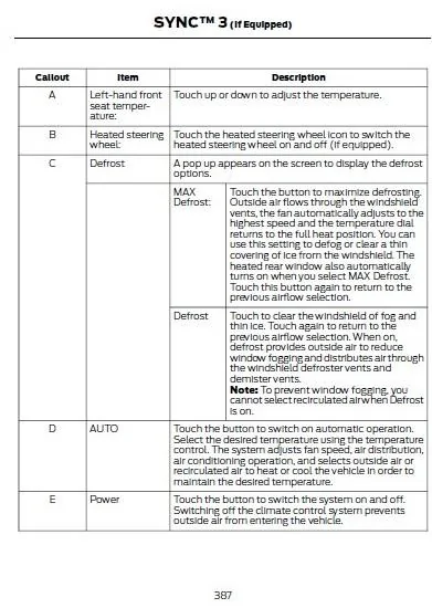

Ugh.... It doesn't appear there is a way to select only outside air. The "system" knows better than thee... :headbang:
Owners Manual Page 387, Callout D: AUTO.

Turn a/c and auto off, set temp to minimum, fan to however you want it.
No different than old school mechanical controls of yore. A/C off, temp slider to full cold

This is correct, and if you bring your A/C controls up on the display you can direct the air to the feet, vents or both and then modulate the fan speed for however much air you want. The system is either full Auto or you can manually manipulate it anyway you want. :like:
