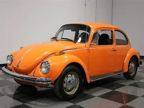

I've had much worse.
Having driven one of these in winter I can attest to how bad the "heaters" were in them... On a 25 in minute or so drive in 30 degree weather you might just begin to start getting what one could consider as warmish air from the vents... Of course this was absolutely negated by the fact that you had to keep the wing windows open to prevent the windshield from fogging up.

I had a '72 with the flat windshield which was easy to scrape when it frosted up inside. The '73 with the curved glass was impossible to scrape. Had a handheld defroster to plug into the cigar lighter to keep the windshield clear.
Actually, I may be tied with you. My 1977 Corvette was an oven even with the t tops off.
