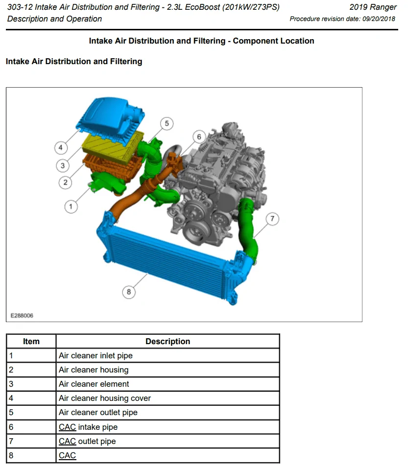

Here is my implementation, for both the cabin filter intake and engine intake. It's of stainless steel mesh, cut to size with tabs that snap in place inside the various inlets.
Accessing the cabin filter intake:
Openings #1 and #2:
On this next one, it looks curved on the bottom with a gap, but actually the mesh is flush with the bottom of the intake...deceptive angle :)
This is perfect. where/what kind of mesh is this? all I see at HD is hardware cloth. thanks!
