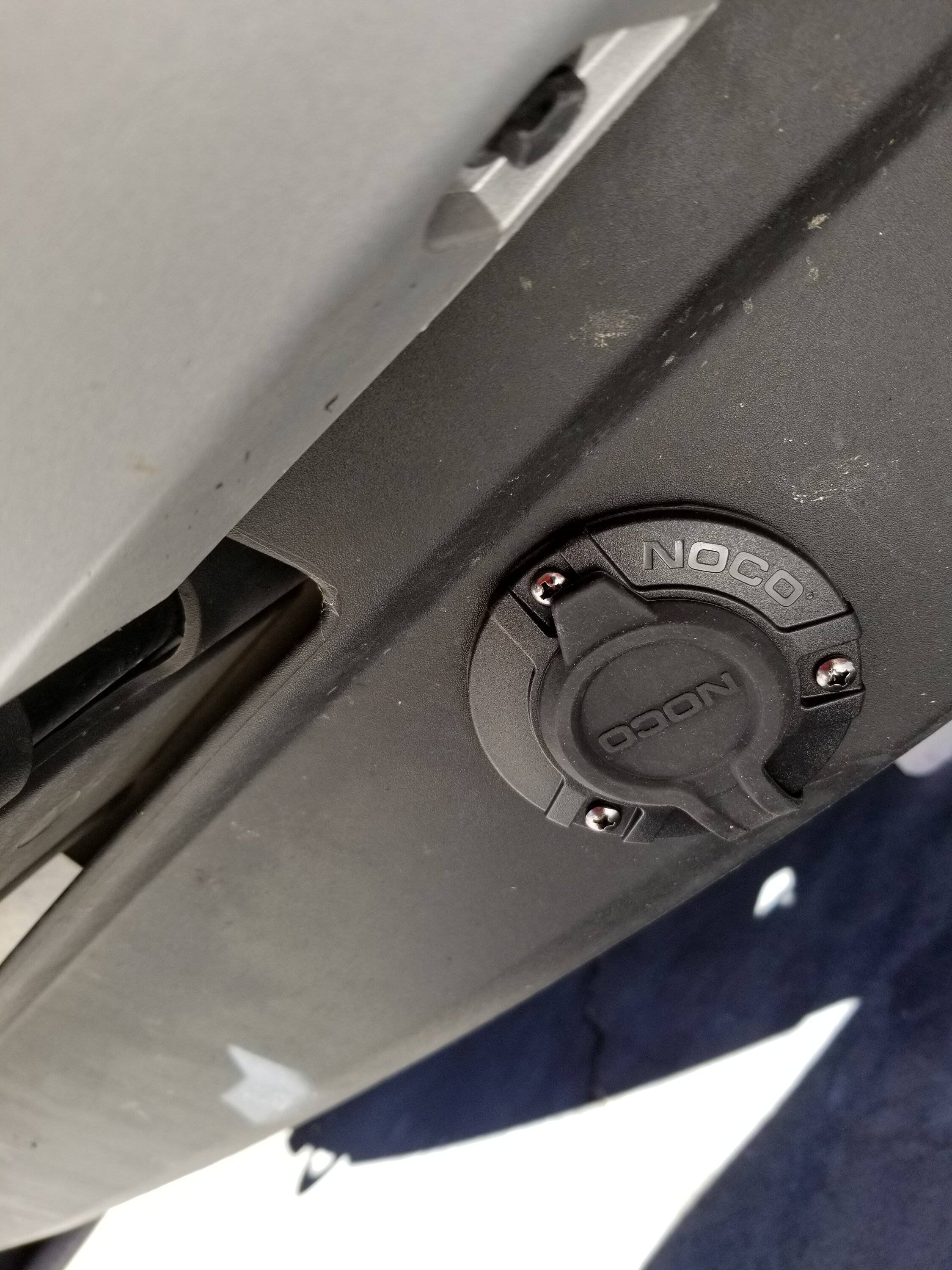

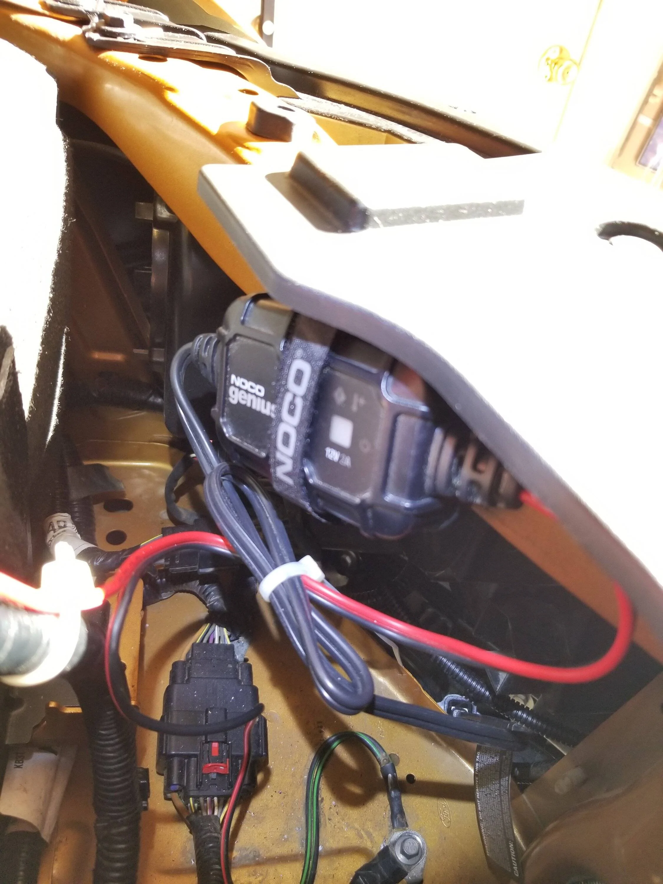

Do you have your maintainer set up so you can just plug it into an extension cord or do you have to put the clamps on every time? I was looking at getting a couple for my tractor, mowers, and the ranger(or any other future vehicle), as a work from home, so I may not leave the house for a few days if I am well stocked on groceries. I dont even know where to start though, is there a brand thats been popular on here?
I used the Noco charger and plug installed in the air dam to make it easy to plug in. It is permanently connected so no clamps. Charger link. https://www.amazon.com/dp/B07W3QSMF9?ref=ppx_pop_mob_ap_share
Plug link. https://a.co/d/a2QLL6A
I added the extension to it so you don't have to raise the hood every time. It makes it much more convenient and super fast to connect/disconnect. Here's a post I made showing it and links to all the parts.
https://www.ranger5g.com/forum/threads/fordpass-app-message.20787/#post-447866
