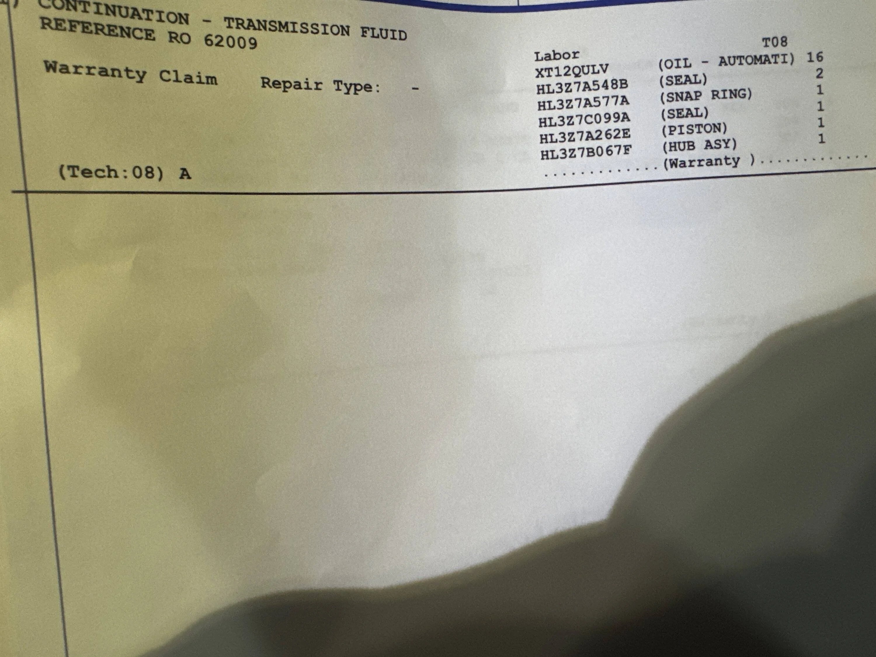

Do you have a copy of the repair order for the transmission repair that you can post? Did they repair it or replace it?
Stevedbvik1
Oct 4, 2021
2,809
8,488
2022 Ranger Tremor XLT

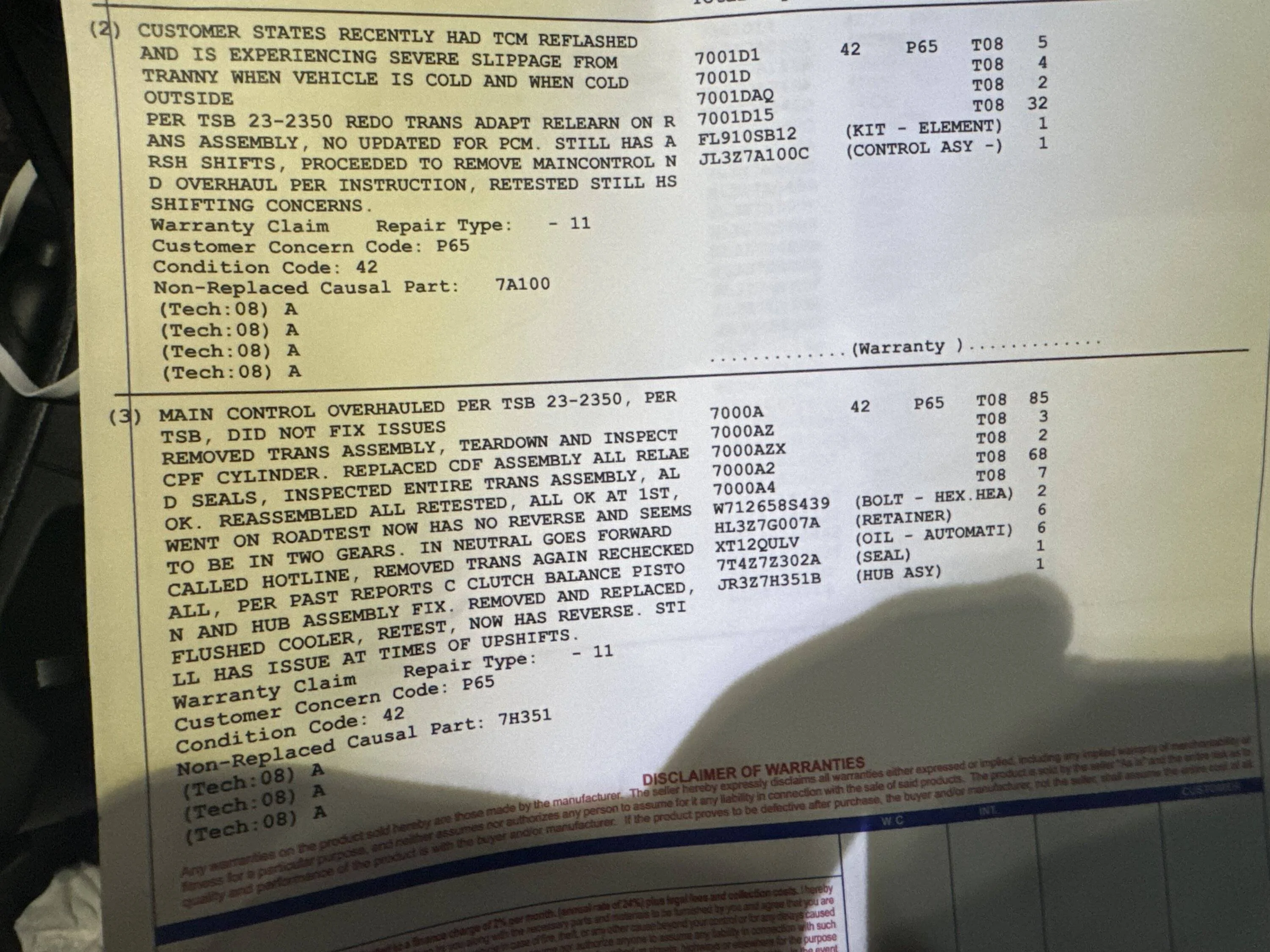

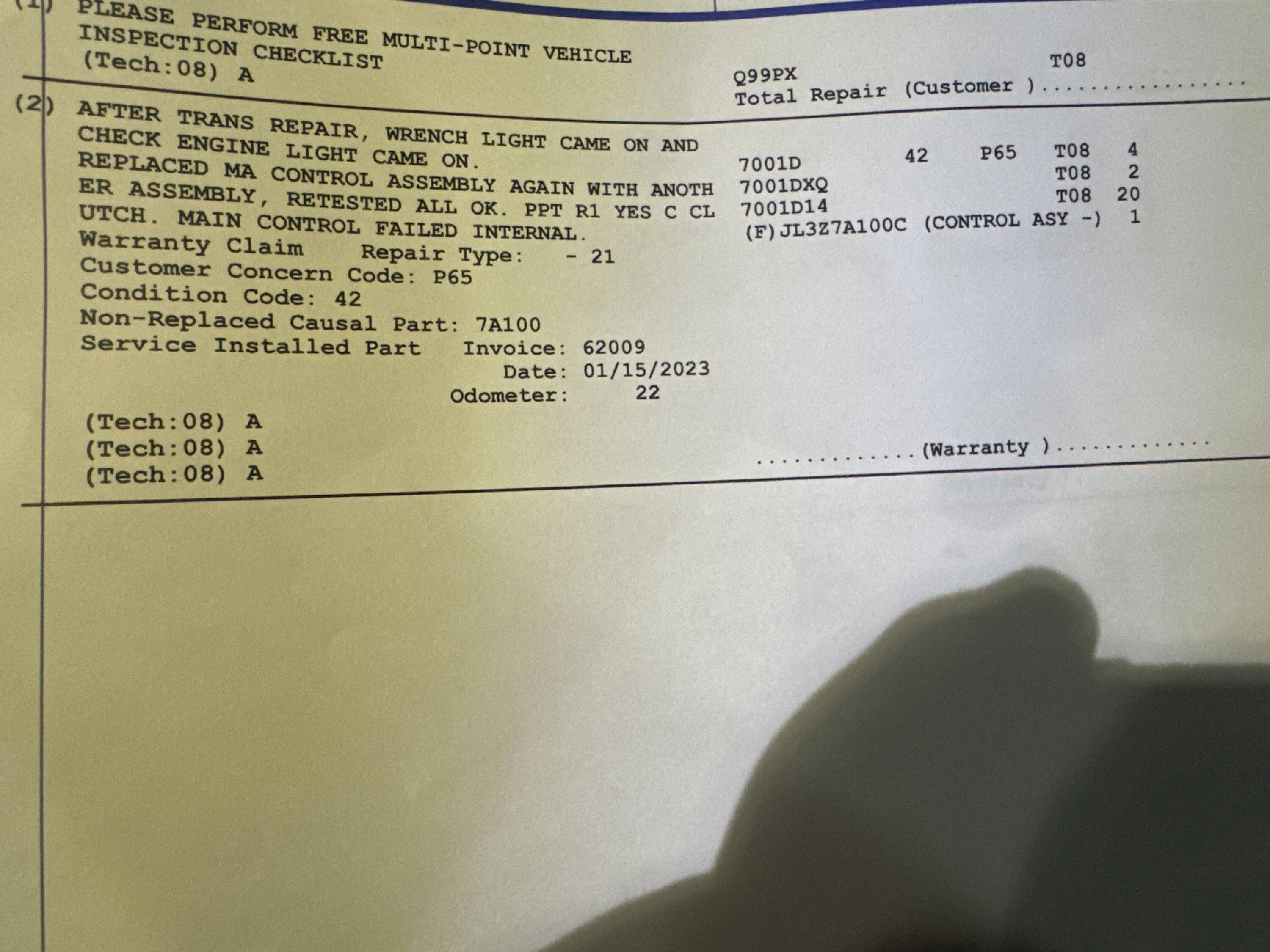

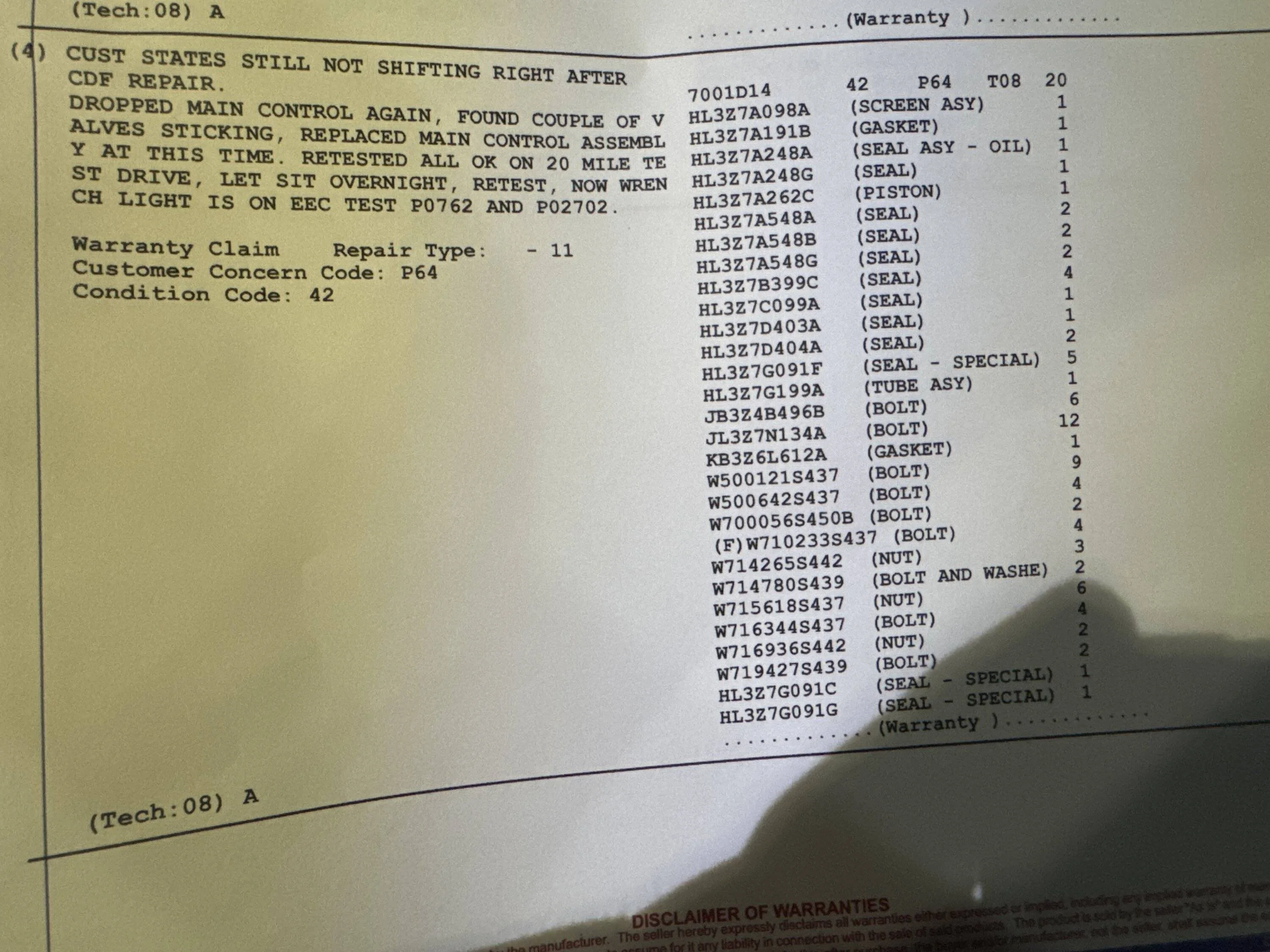

You know. Service advisor said it was being replaced. I don’t see it on this parts sheet
Yes they did, it’s the hub assy. Looks like after they got it back together they had codes and then had to replace the valve body. Wondering if valve body is acting up again ?
That was one of my thoughts. I see @SeaRanger posted a new tsb. Wonder if I should see if they can just do a full replacement instead of dealing with this problem child. It still under the 36k warranty for now.

They really battled with getting it right the first time. Threw a lot of parts at it for sure. I would ask that question about replacing it this time. Don’t know if it’s a defective part, workmanship or both

The original TSB that yours was repaired under also included the option to replace the transmission.
