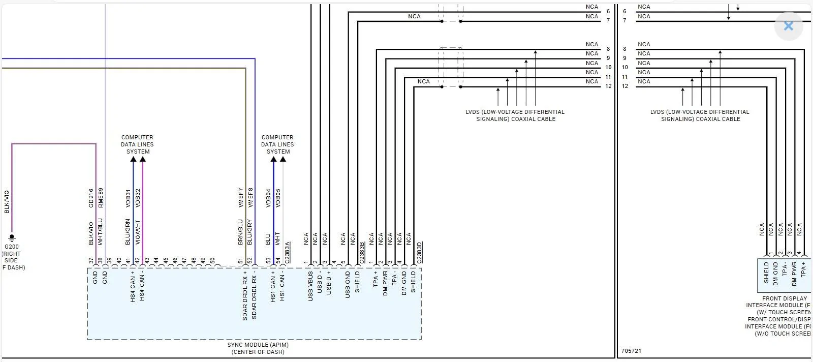

I have been trying to figure this out and since I do not have an issue with mine, it's strictly guess work.
EDIT:
When I first posted this, I had the OP's issue backwards, as I was thinking the issue arose with Ambient Lighting (ON) the Hub was inop, then realized that the hub was inop and he turned ambient lighting on, and it works. (But drops off)
Either scenario, though points to a ground issue in my opinion or a power loss at the APIM itself
which can be checked - see below
The manuals do give a specific failure (Pinpoint-Test) for this specific issue and how it ties into (Ambient Lighting)
The Ambient Lighting (itself) is separate from the Sync System and has NOTHING to do with the light on the USB Hub or USB Power.
However, and this is a GUESS since there is NO direction for troubleshooting this issue.
So, the best that I can tell, is that the HS1-CAN input here is the direct control for the Ambient Lighting, and when it is turned on - it is generating a circuit disruption within the APIM.
EDIT:
The actual input (Ambient) Lighting (Change-Adjustment) on the display (control inputs) is communicated via HS3-CAN to the GWM, the GWM then provides the change request via HS1-CAN to the BCM (which provides the actual - color and intensity change) on the circuit.
So, some possibilities here are:
1. Ambient Lighting Circuit (Issue) bleeding over into the APIM (Sync Module) via HS1-CAN Bus
Think of it this way, I am not 100% certain that the HS1-CAN is actually the control, but if it is, it is an Intergrated switch vs a physical button and rotary dial. (Rheostat)
The Ambient Lighting itself - is self-contained Power & Ground and a LIN Circuit - controlled by the BCM.
The Lin Circuit is the (adjustable control) for color / brightness.
There is no direct connection for the LIN Circuit to the APIM to control it, the BCM receives communication via the HS1-CAN Bus for control. (IF I AM CORRECT) in this assessment.
There is a Direct Connection between the BCM & APIM (noted below) Pins 53 & 54 HS1-CAN
Note: Not Pictured but the (Input) into the APIM Pin #38 is the Ground for the USB Hub, note this is not a physical ground. The ground is internal of the APIM, which is grounded by another pin which is grounded at G200.
There is another possible source of voltage anomaly and that is from the short harness cable from the FCIM to the APIM, this I believe is for the display (separate) dimming features.
RH Side of the Pic - Shows this cable connection.

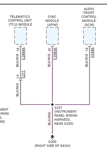

2. Bad Ground for the APIM
Adding voltage to the circuit with a bad ground, could cause the HUB to drop off when the Ambient Lighting is turned on and the display input brightness would possibly be affected as well.
So, with that, my thoughts go to a bad ground for the APIM @ G200

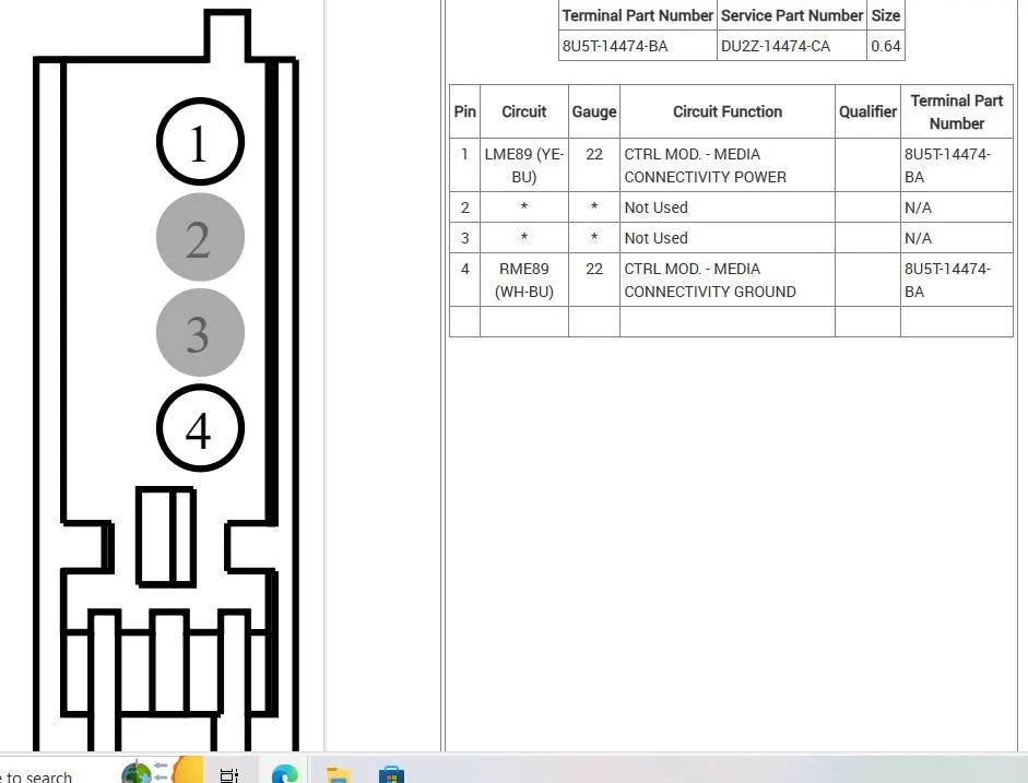

A easy way to check the Ground, without pulling the APIM out is to check the Ground at the USB Hub connector.
Using Ohms scale
I would check it (3) ways - Pin #4 to Ground and then Check Pin #4 to the Ground Point G200
see if you have a resistance difference between the 2 readings. Should be about 3 Ohms.
To ensure you have a verified ground check, disconnect ground point G200 and direct wire check the ground wire G200 to Pin #4
If all 3 show 3 Ohms, its good, possibly give the wire harness a few light tugs and shakes to ensure wire integrity of the ground and make sure your Ohm reading remains constant.
With the Hub Connector, disconnected it would be a good idea to check voltage at Pin #1
Ignition On (should be reading your current battery voltage)
Between Pins 1 & 4
Switch Ambient Lighting (ON) and (OFF) see if the voltage changes. (It should not alter)
Note: Pin #4 goes to the APIM Pin # 38, the (unseen in the diagram) as I I stated.
This should be a direct feed to ground via Pin # 37
Note it has a splice, so the G200 point may be good, but bad at the splice.

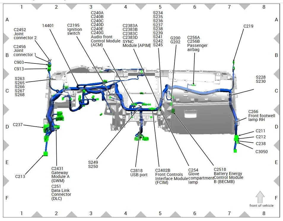

G200 Location (By Glovebox)
