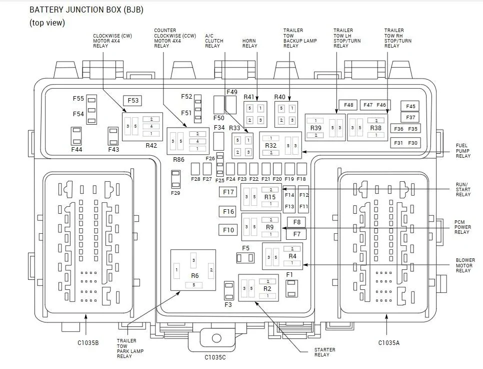

This is what I think should happen if you pull fuse 28 in the BJB
It should shut down the engine. if it is running
Not confirmed as of yet. (This is accurate)
Unless it still sees power from another source - shorted power source
Plus, with a scan tool - live data pid's should show this switch position (ISP-R) - On/Off
If I am correct, this data pid will always show (on)

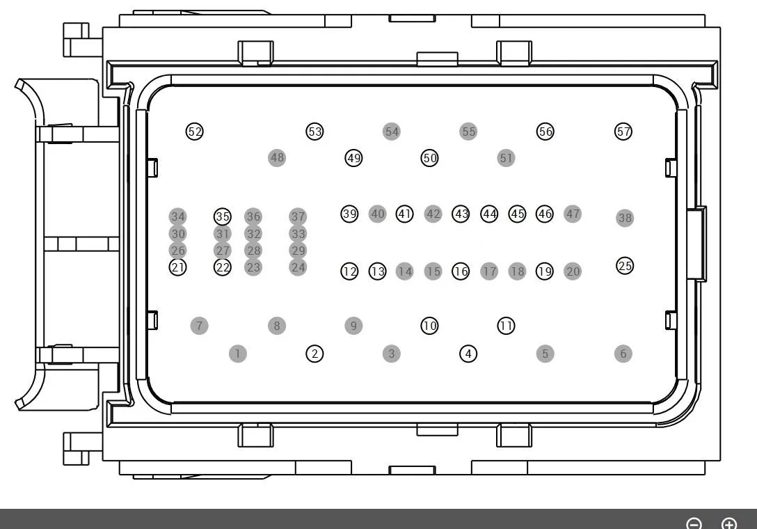

The BJB Connector C1035B - is on the left (as you are facing it) (Inboard side of engine bay)
This is the Pinout:
Pin 43 Goes to PCM Connector C175B Pin 82 - Brown Wire w Green Stripe
Pin 41 Goes to PCM Connector C175B Pin 64 - Grey Wire w Violet Stripe

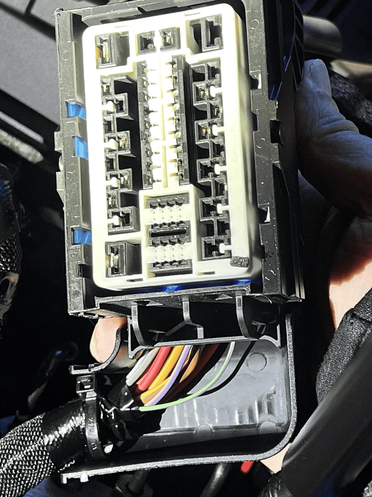

The PCM is buried under the BJB and the BJB has to be removed to get to it.
The PCM has 2 main connectors going to it
C175B - will be the most forward connector (To the front of the truck)
I cannot visually see how the C1035B harness routes down, as its buried.
The harness is wrapped in protective loom and tape.
You may get lucky and find damaged wires at the BJB Connector (there is a protective cover on the connector)
The harness run, from the BJB connector follow it down to a possible branch out of wires going to the PCM connector.
If no visible damage to the harness, then you are going to have to rip apart the protective loom.
You could also have the short inside the BJB box itself or the PCM Itself
But I have a strong feeling its just wiring

I’ve decided there’s a short somewhere in the battery junction box. Pulling fuses 32 (fuel pump), 86 (4wd) and 42 (4wd) make the not cutting engine issue go away. Pulling 86 and 42 make all the problems go away except “4x4 fault”. Dealer rush ordered the part for me. I’m taking the truck in with a box of donuts. Will update everybody soon.
If it’s not actually this issue, well I don’t care, I’ve decided this is the issue and that’s that. I’m not picking up the truck until it runs like a 3 year old 33k mile union made truck should.

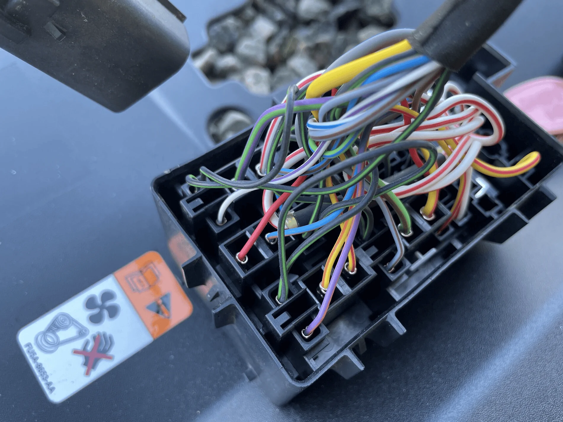

The issue connector is the BJB (Left) side as you are facing it. C1035B
You may try, disconnecting and inspecting this connector (pins) look for moisture / water or any Dis-Colorization on them.
Moisture in this connector could possibility create the same issues you are having with moisture being the conductor.
If you have some electrical contact cleaner, spray the connector down, let it dry and reconnect.
It is possible the cross short is at this point.
When the truck shifted into 4WD Lo - The original starting point for all this:
Was it Raining? or had you recently driven through a heavy rainstorm? or Car Wash - Engine Bay?
If YES, then I would lean more on the BJB or Connectors to it, as getting wet and creating the issues you are having.
From this connection, the harness routes down towards the PCM
This is where it gets difficult (for access) The PCM is mounted under the BJB, so the only way to access it - is to remove the BJB or possibly remove the battery to access the PCM connector (C175B)
The BJB connector harness should have a (branch out) of wires going to the PCM connector (C175B)
PCM Connector - C175B - should be the forward connector in the mounted position,

Disconnect it and match pin BJB Connector Pin #22 to the BJB Box (Integral Connector)
NOTE: Pin #22 - should be a Grey Wire w Orange Stripe
Repeat Test as above using the (BJB) Box Integral Connector that matches Pin #22

Example of where I suspect problem lies:
Exposed Wires under the cover
The unknown is does the BJB have a wired run like the Aux Relay Box or is it a printed circuit board?
Thus far it appears the BJB is a SEALED box, as reported by another member.
If it is like the Aux Box below
Then you may be able to get the BJB apart and check for damaged wiring
If so (BE VERY CAREFULL - Pulling it Apart)
These 2 locations would be a fairly quick check, without a meter or wiring checks.
