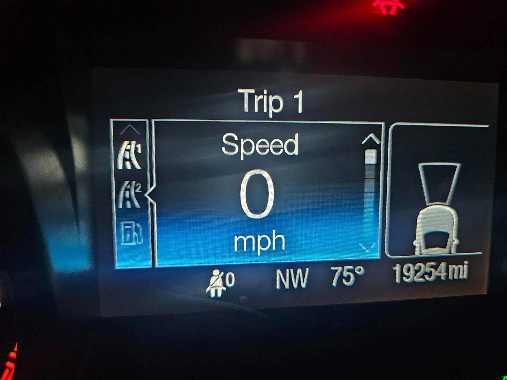

My ambient temperature sensor is lying to me. It is about 94 degrees right now and it is stuck reading 75 degrees. I just went through an automatic car wash and noticed on the way home. Is there any way to reset it?

Mine does that too when going through the car wash. It'll square itself away soon enough. Mine does.

Thanks Chris! Never happened before.

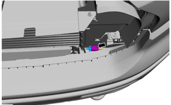

If it does not reset on its own, there is a Scan Tool (Reset) for it, IDK for sure if Forscan has it but I believe it does - It will be a quick link tab to it.

Thanks, it did reset but I may drag my laptop out and see if Forscan has it.

Typically in front of the radiator behind the grill or bumper. Ford has been putting them there for 30 years. No idea for our truck. Haven’t torn that deep into this one just yet.

Location - Below Driver's side headlamp assembly, not sure about the multi button reset - none of the Ranger manuals call for that, they only state the Scan Tool method.
