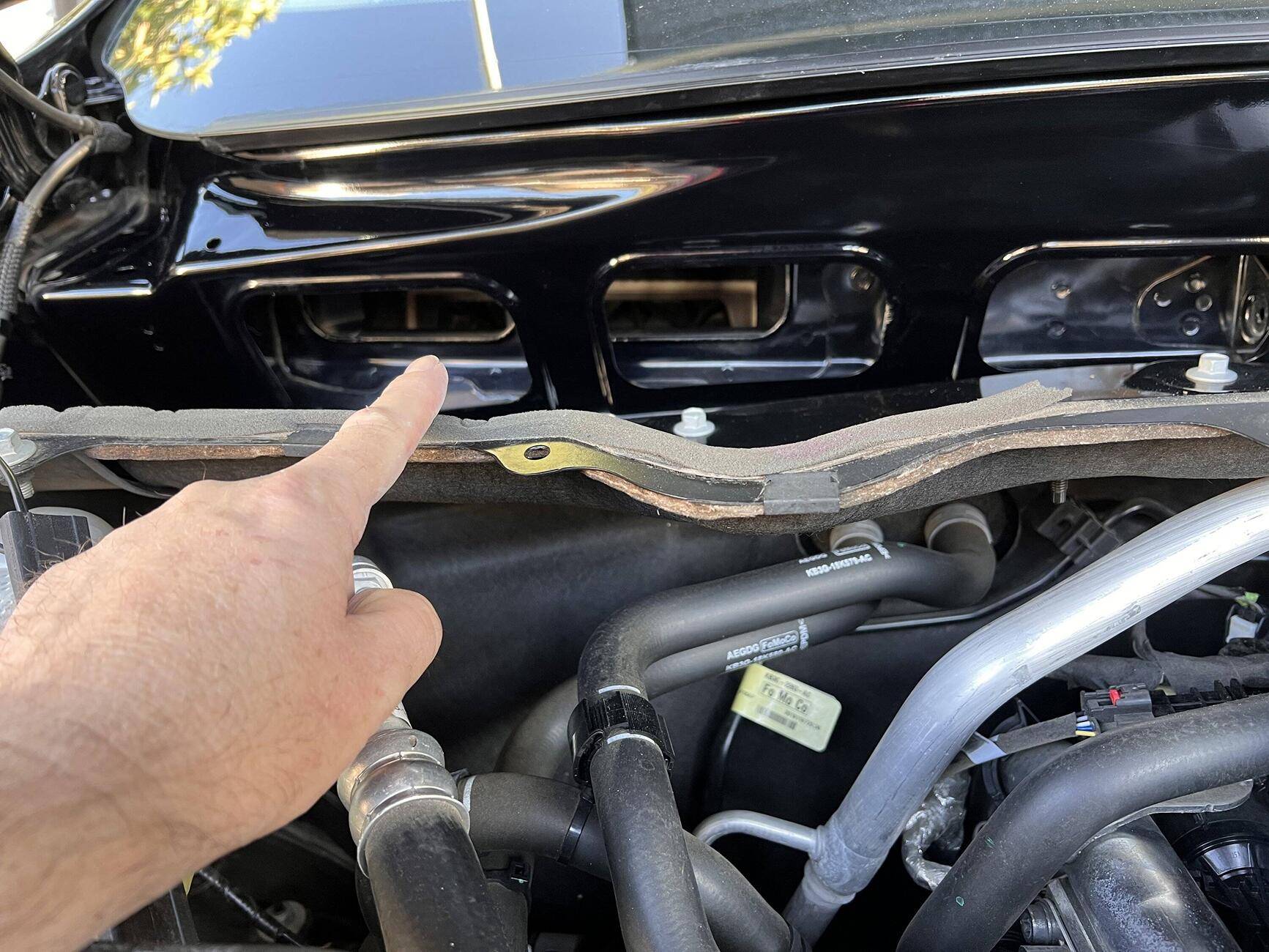

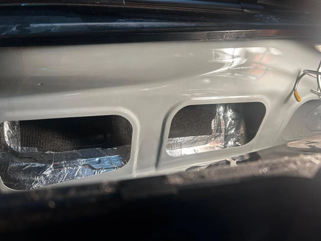

Yes, it appears that if you do not have the (added) inlet screen to help prevent mice entry leaves and associated debris find can be found on top of the filter, due to the design of the filter housing when you pull it sideways to remove the filter anything sitting on top of it gets knocked off and it drops down into the squirrel cage.
The extra screen stops / blocks that from happening and only the dust can make its way down to the top of the filter.
Ref: added screen, various screens have been used for this, I am using drywall sanding screen and (Speed Tape)
I'm trying to orient myself to figure out where you've put that screen. I should do that. Do you have a pic from farther away that would show me where I can install that screen? That's a great idea!
Here is a better pic, its under the Passenger Side plastic cowling , below the windshield.
The inner inlet ports feeds the (Air Inlet Door) for the Climate Control
ere
ere
Perfect, thank you! Will check it out this weekend. Now I wonder if I can put a shop vac down there and suck up anything that's made its way down there since the filter was changed....
