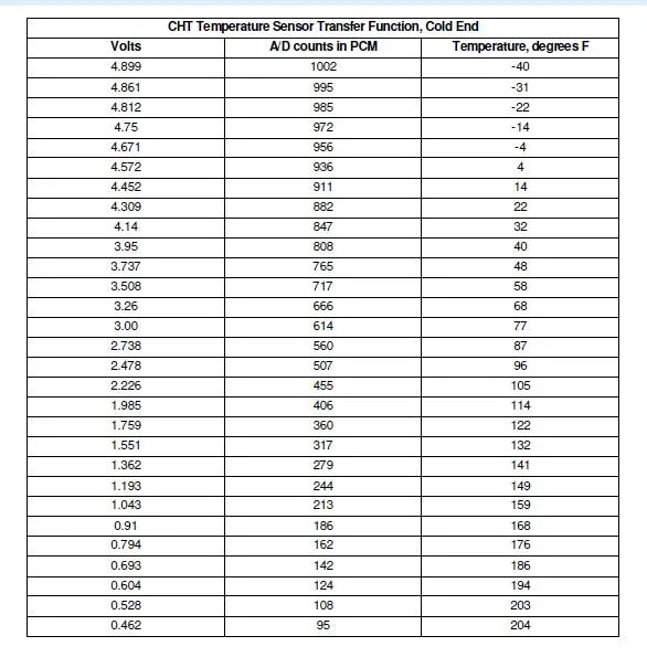

In a Ford Ranger, the engine coolant temperature (ECT) sensor typically outputs a voltage that varies with temperature, providing a signal to the Powertrain Control Module (PCM) to regulate various engine functions. Normal operating temperatures usually fall between 195°F and 220°F (90°C to 105°C), with corresponding voltage readings around 0.75V to 0.04V. If the voltage reading is outside this range or if the temperature gauge reads incorrectly, it could indicate a problem with the sensor, wiring, or the PCM itself.
If I am understanding what I am seeing your ETC is out of range.
For ref: 38 Deg (C) = 100.4 Deg F
Here is a voltage / temp ref chart - so the voltage of 2.273 is normal.

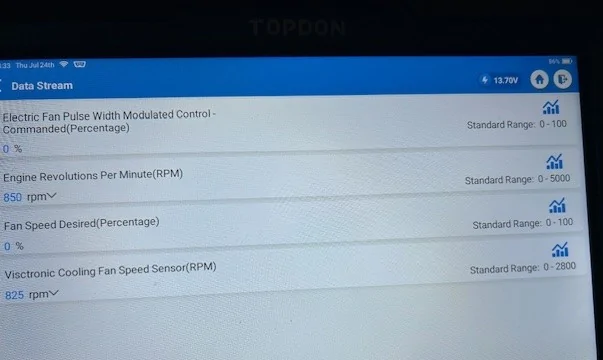

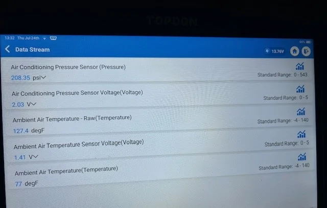

I hooked up my scan tool and verified that yes, the Raw & Filtered can be displayed showing a mismatch.
Note: I had been idling for a long period to simulate what you would see.
Also noted that my Fan Speed never increased as the PCM did not command the Desired Speed above the engine RPM while at idle and engine at operating temp
Note: 0% Desired = Engine RPM, if the PCM determines that a greater fan speed is needed for (Engine Parameters / Load Etc) it sends a PWM signal to the fan to increase its speed viewed as a percentage (Desired) and RPM for the fan speed.

Cool, hopefully it cures the issue.

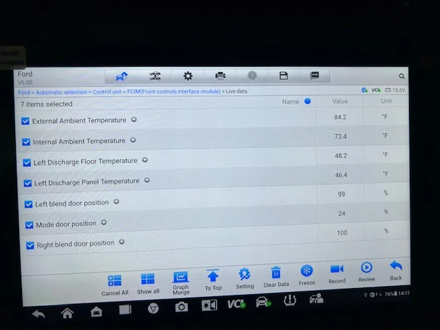

Here is a screenshot of my idling for a long period and what I can get (Temperature Output) from the temperature sensors.
General Output - is approximately 35-40 Degrees below ambient for a properly operating system.
