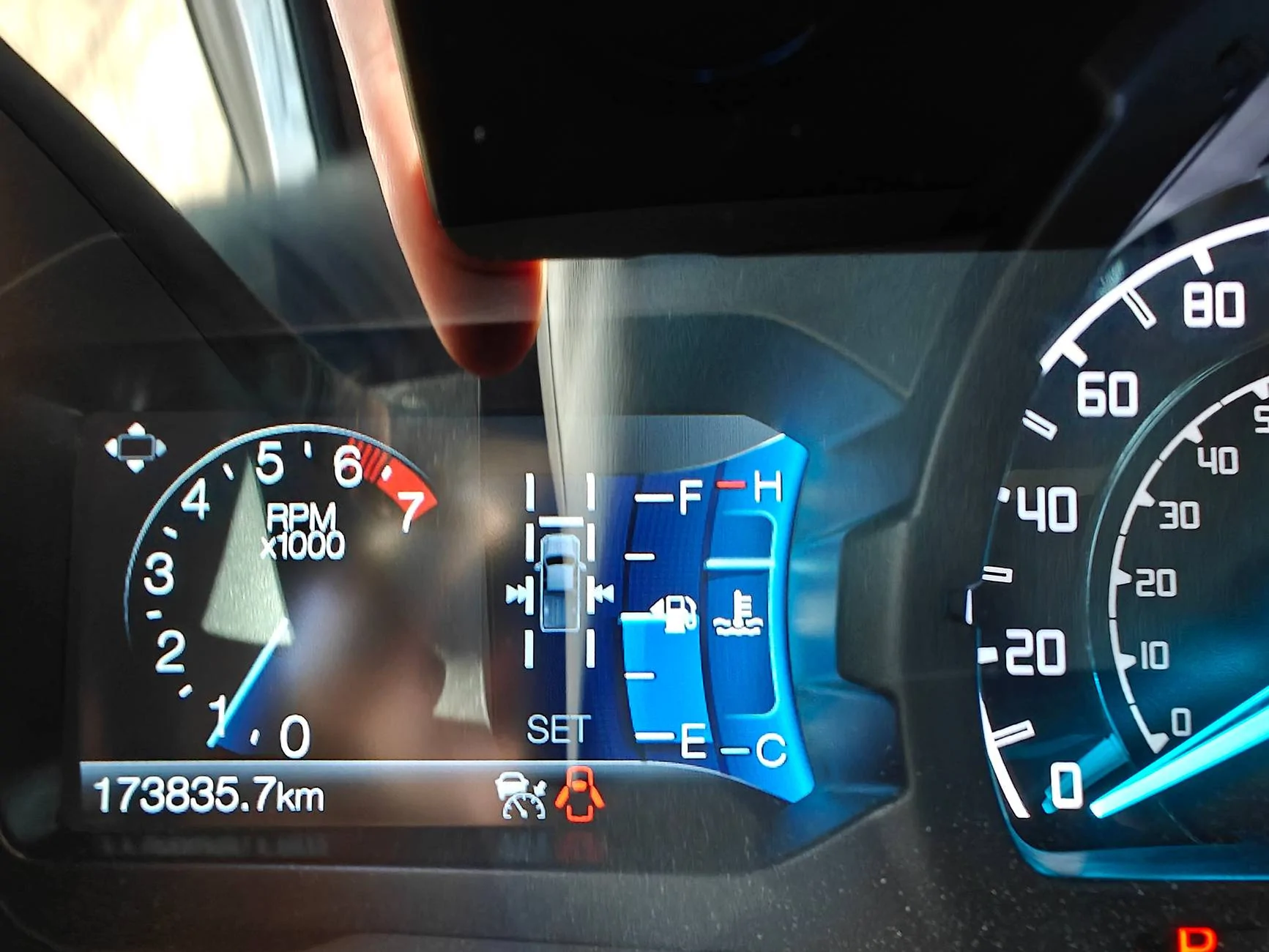

Yes the AC condenser was checked and radiator is clean. Picture shows the gauge after 40mins with ac on, outside temp at 24C. It will go higher but that's when I either keep the gas pressed if I need to keep idling when my tools are being powered or turn the engine off.

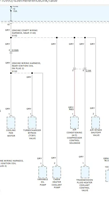

To tie both issues together, I suspect a possibility that since AC is not working and the fan control issues may be tied together.
I suspect a voltage drop @ idle and the fan is not receiving proper voltage.
Does the AC work when driving ? or does it only go inop when @ idle?
Either way, the power circuit ties in off of Fuse #12, Its a shot in the dark here, but this is a possible area to check.
Something on the circuit is pulling down power and its more noted @ idle (Low RPM) when the wonderful BMS system is down to 12.2 volts, it may be dropping lower than that on this circuit and the fan does not have the voltage available to power.
Wire checks will confirm, and has the support tube for the fan been damaged and or the harness to it.
I will need to put together a T-Shoot (connector) diagrams for both the Fan and AC Solenoid.
The solenoid is C1110 but its location is not clear, I was wanting to suggest disconnect that connector to see if the Fan started operating normally.

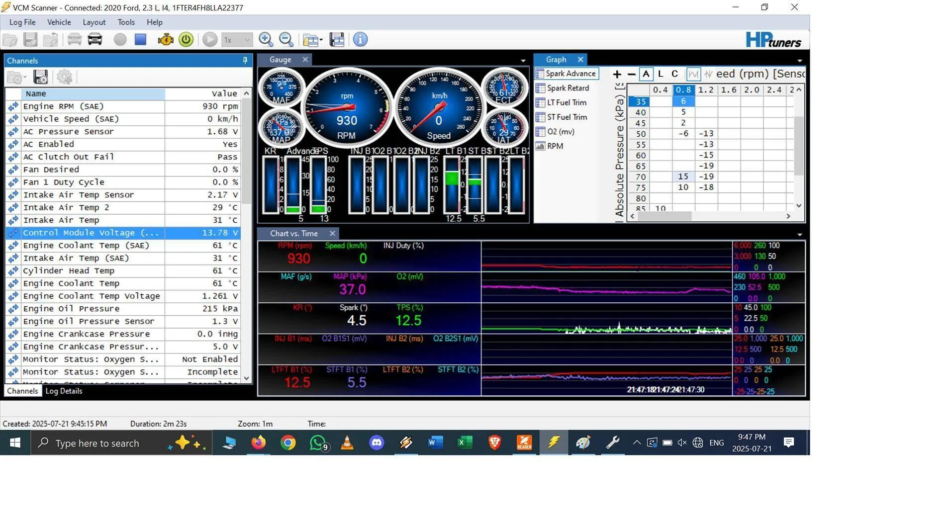

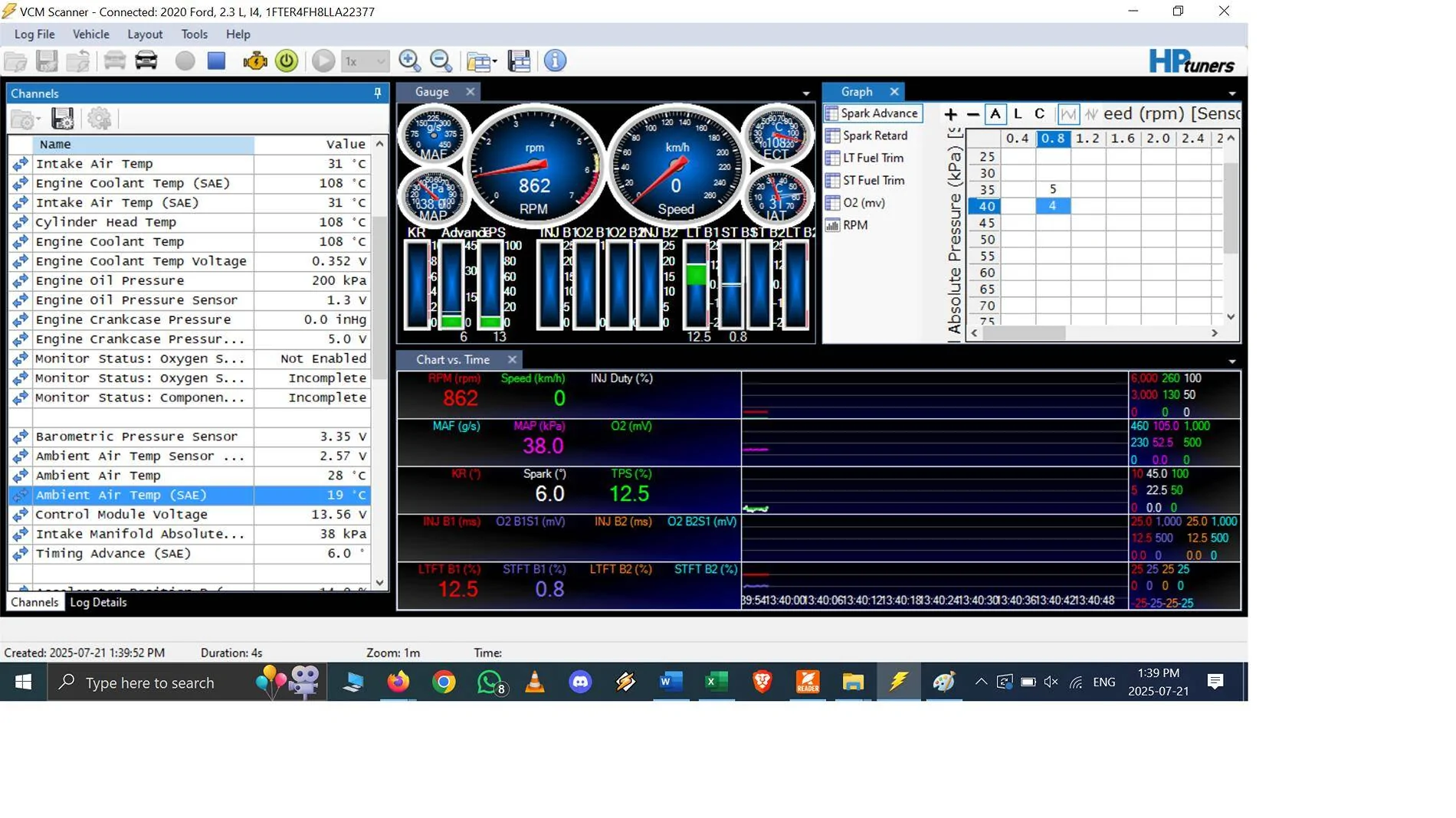

I know you said to test on cold engine, I will do that later tonight when I get home but when it started overheaating today ect and cht were the same, not sure what voltage I should be seeing for some those values here though. And why ambient temp is 10c different then ambient SAE temp.
Never had an issue with the battery and voltage is around 13.6-13.8v when when it's overheating.

here are values with engine off and cold
Not sure what control module voltage is reading. Do you have a battery voltage PID that you can monitor? I see that Fan 1 duty cycle is 0%, so that would indicate a slow fan speed commanded.

There are 2ea PID displays for Ambient Temp - Raw and Filtered
I am going to ASSUME that HP Tuners is calling Filtered data (SAE)
Raw Data is a direct read of the Ambient Sensor and Filtered is what is displayed on the IPC and Sync screens it uses a algorithm to filter out heat soak.
The most important thing for that sensor - is after driving for a few miles - does it match actual outside temp (as parked) it is picking up engine bay heat and sun beating down on the hood etc.
I think that they should be close to the same reading (Raw and Filtered) - I would have to hook up scanner and check to be sure and see what kind of mismatch they have.
I would also have to check for Fan Operation - Fan Desired and Duty Cycle and actual Fan Speed- to see what is normal PID readings, I have looked at that before but forgot what was displayed.

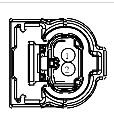

Then we need to verify that the Fan and AC Solenoid are receiving that same battery voltage.
So with Key On Engine Off - check battery voltage @ battery
Then disconnect the fan connector and check pin #1 to ground and then check AC Solenoid connector pin #1 to ground.
Do they both measure - the same voltage readings as the battery voltage?
You want them to be the same or very close.
I do not think this is the issue, but you can eliminate this circuit with a simple voltage test with meter.
I STRONGLY feel that if you have not physically checked the area between the Condenser and Radiator - you will find leaves etc - blocking the airflow, causing both issues.
This makes the most logical T-Shoot sense - if everything operates normally when driving as the temp sensors may not be reading the correct temperature, radiator surface area is holding the temperature at a higher temp than the CHT and ECT measure, thus improper fan speed control.
Fan Connector
AC Control Solenoid (Mounted) on the back side of the AC Compressor
