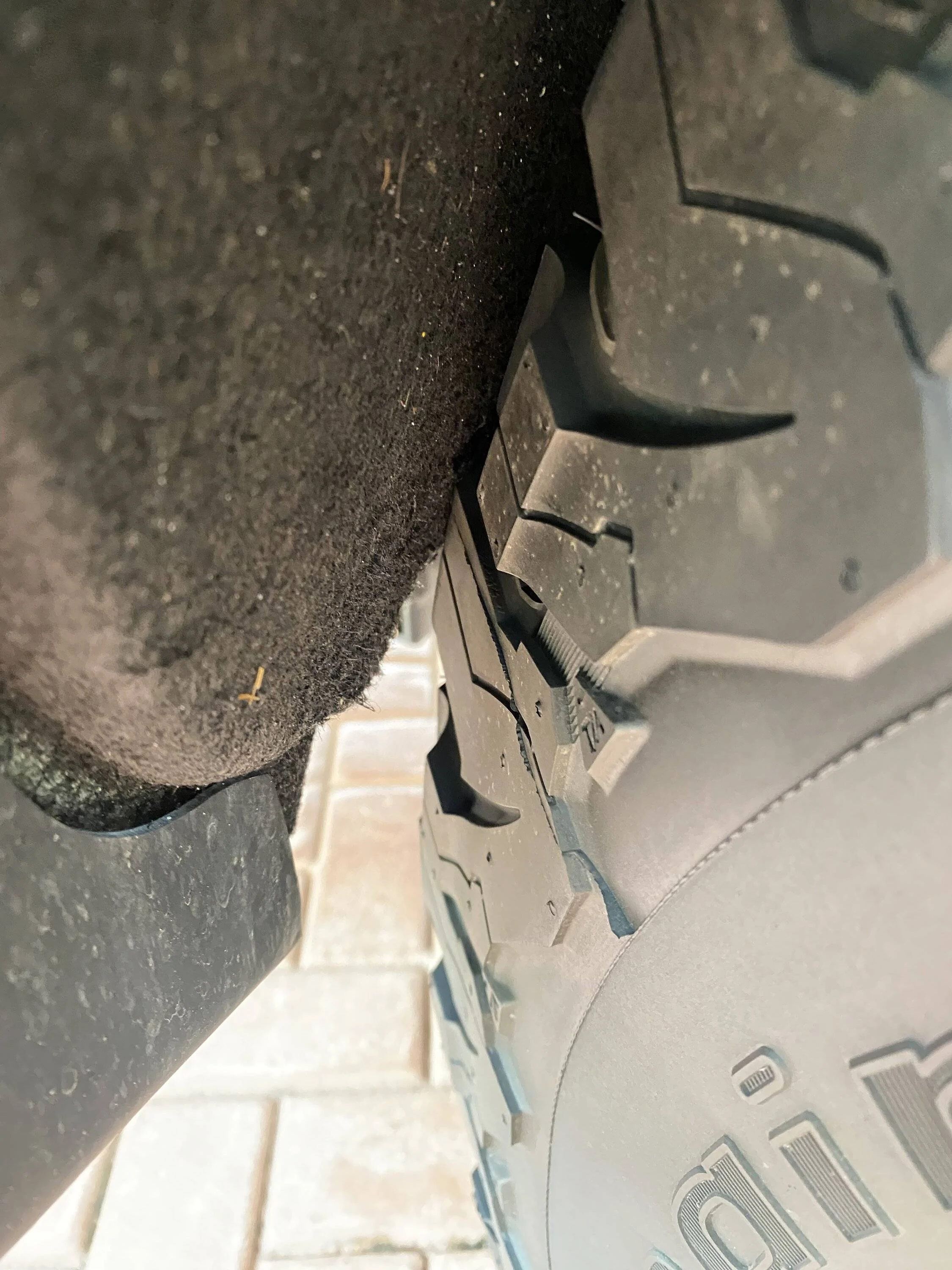

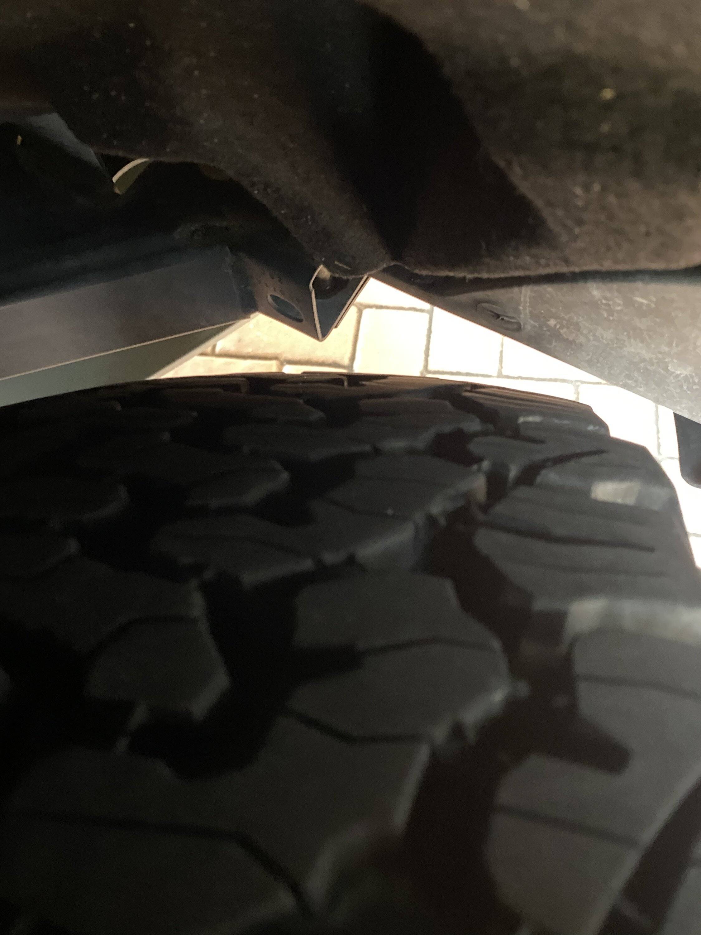

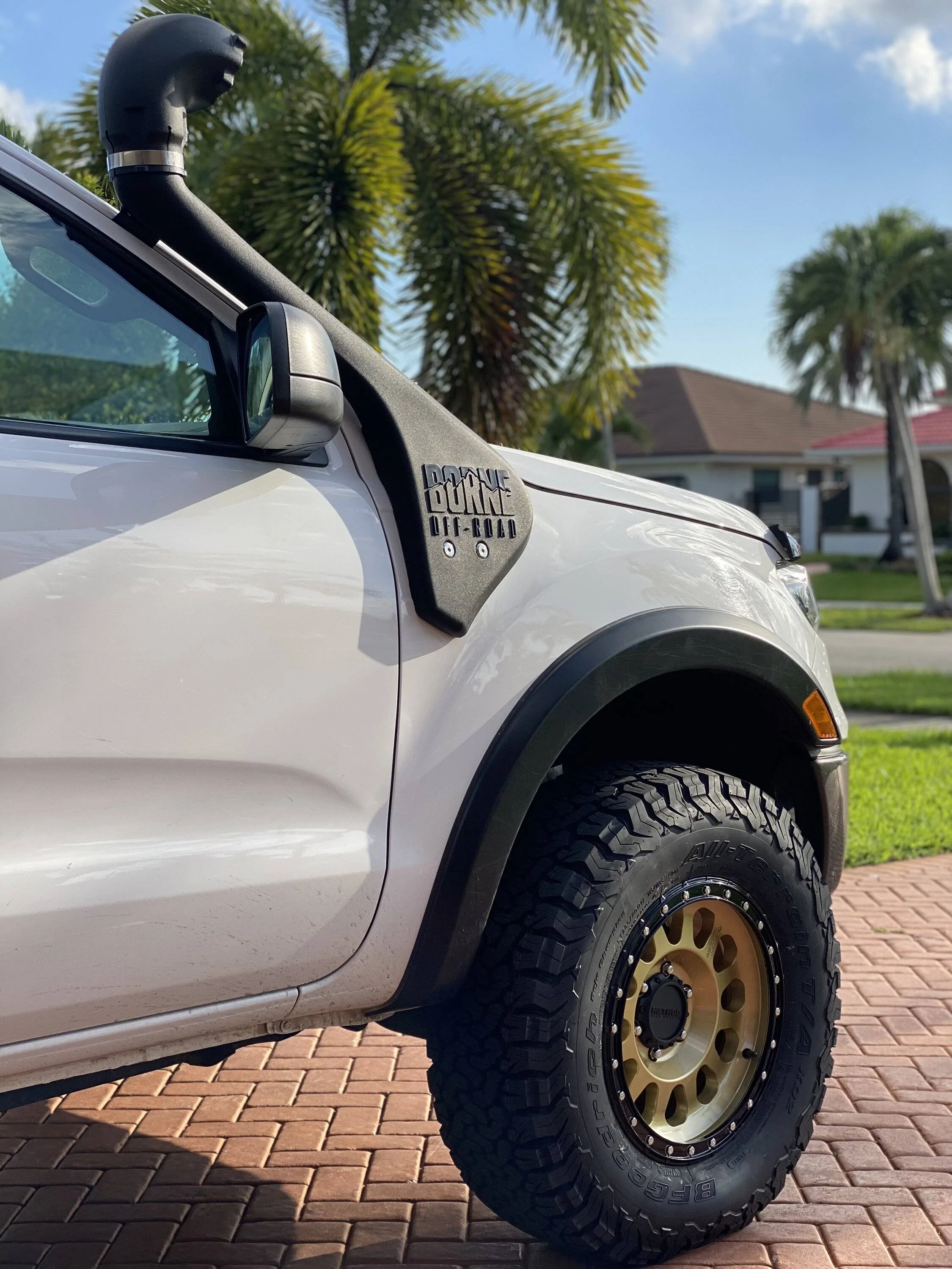

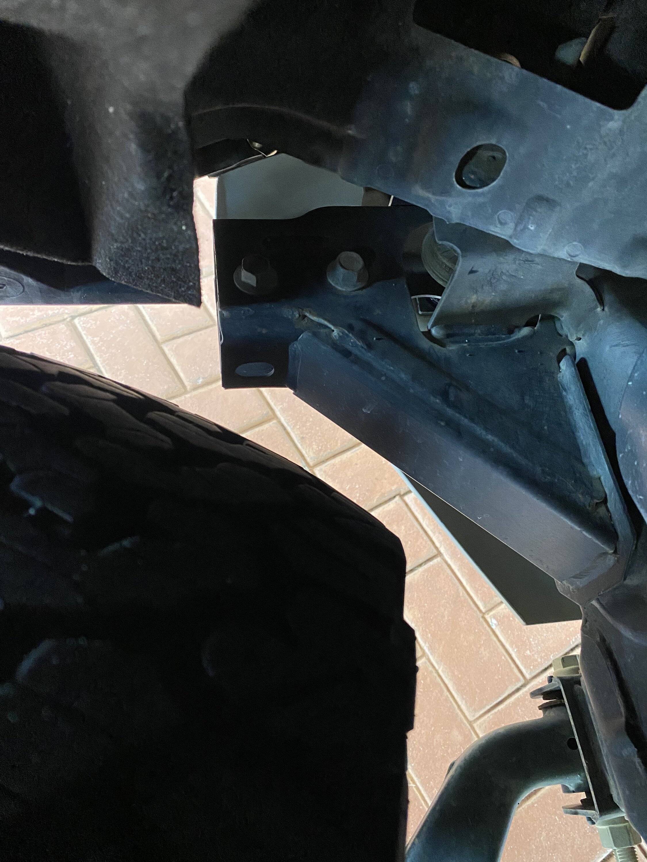

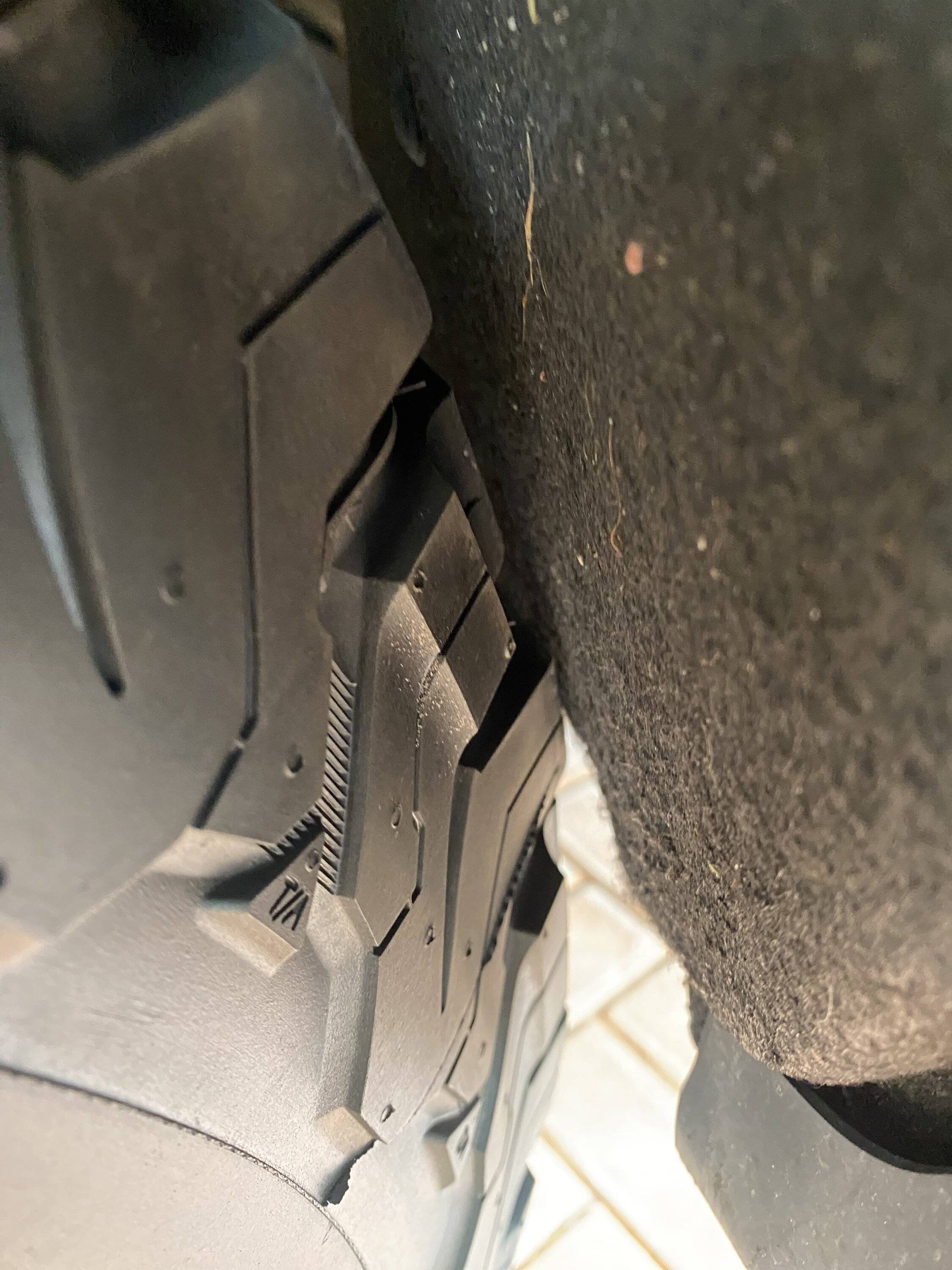

I’m currently running MR315 in the same specs with BFG KO2 in 285/70/17 as well. I’m running @Fordrangerlifts.com 2.5” level and have the crash bars removed. I do have rubbing at full lock on the street, but have yet to try out offroad.

Hey Joel, Ranger looks great.
Do you know what they’re rubbing on? Fog light, air dam, wheel well trim?

Sitting parked you can see that at full lock my tires rub on the fabric-like wheel well trim. No issues with the front, but that’s parked. I’m sure once I hit the trails I’m going to get a whole lot more rubbing.
Hope the previous photos helped. If you need any other views let me know.

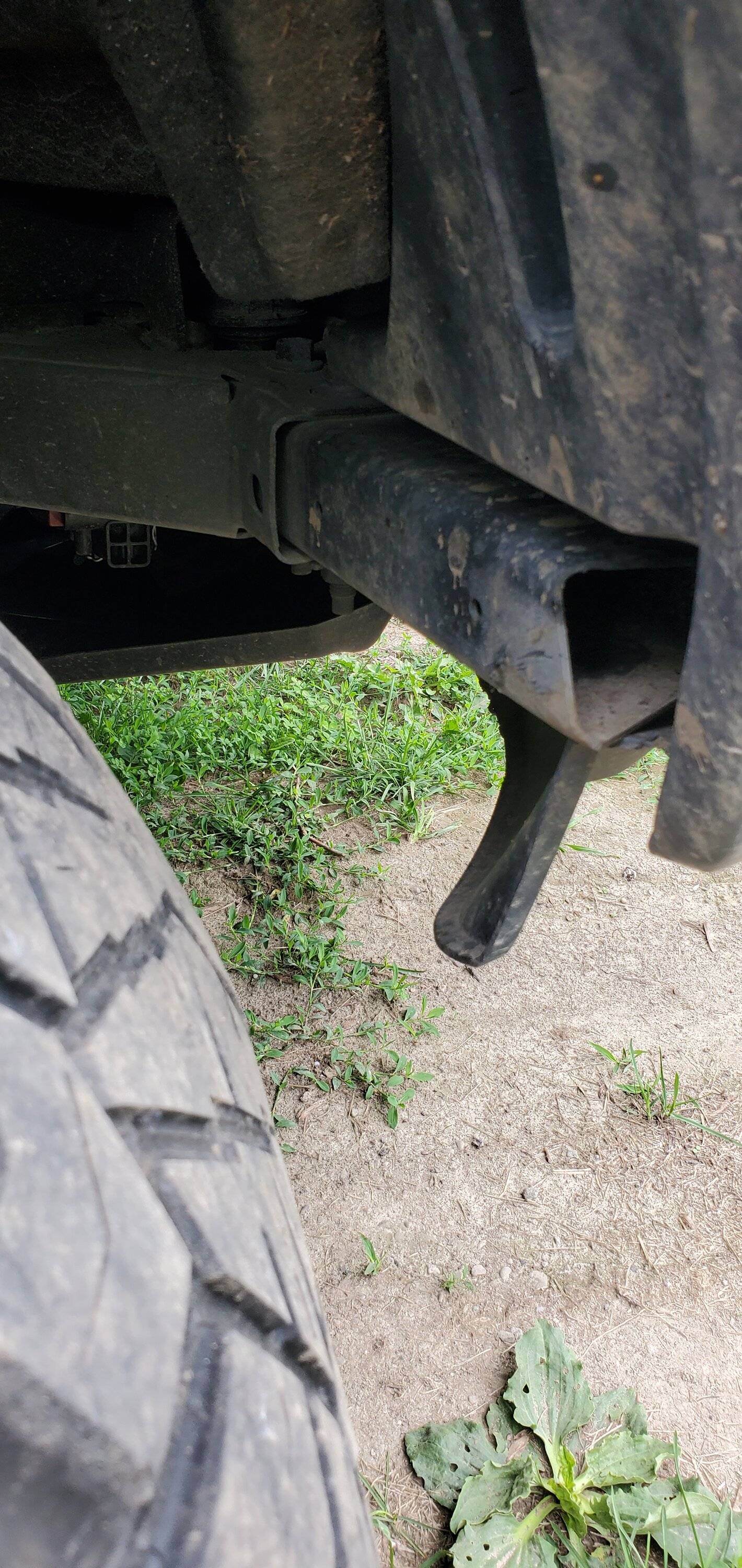

Those will help most folks out - you can see where the liner would need trimming and how the crash bars would have been in the way if you hadn’t removed them.

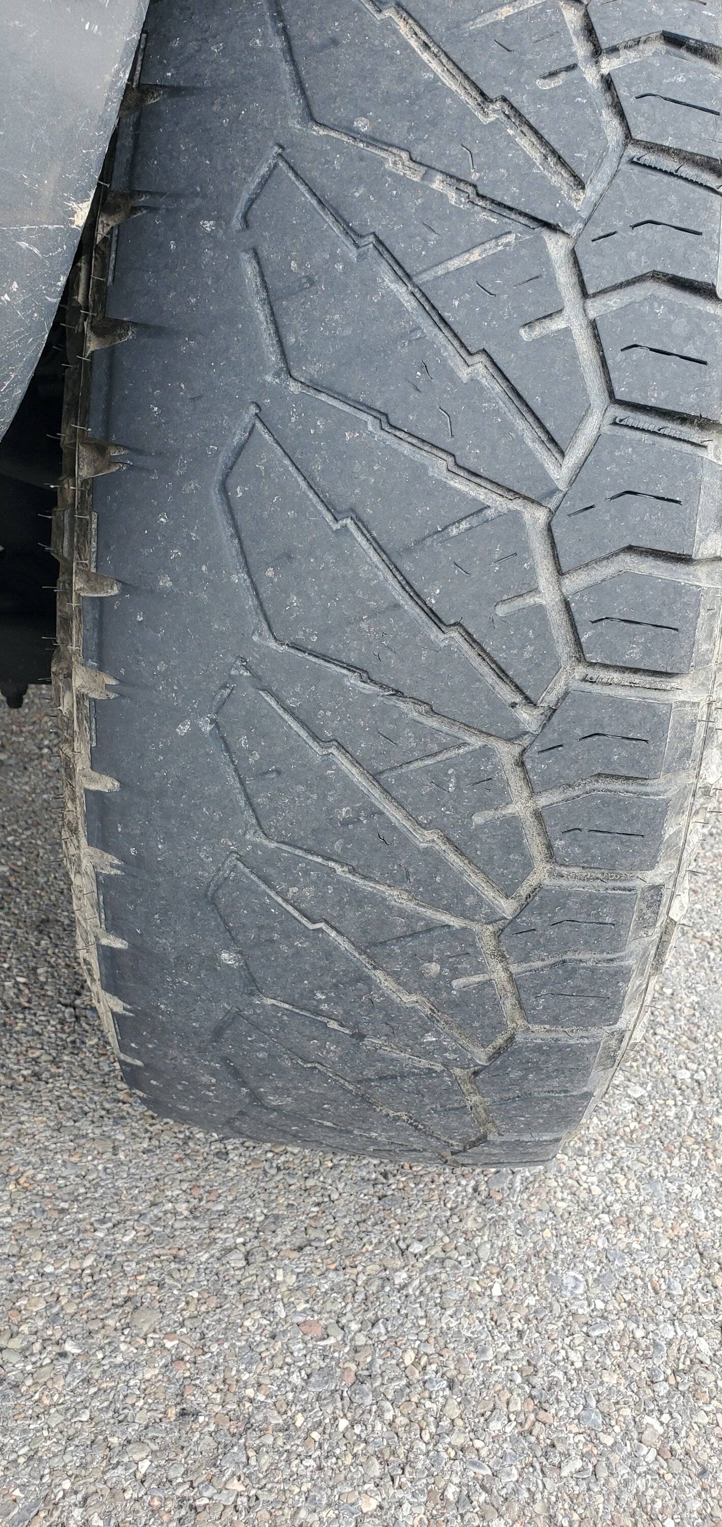

285/70/17 Ridge Grappler, on Roush Rims

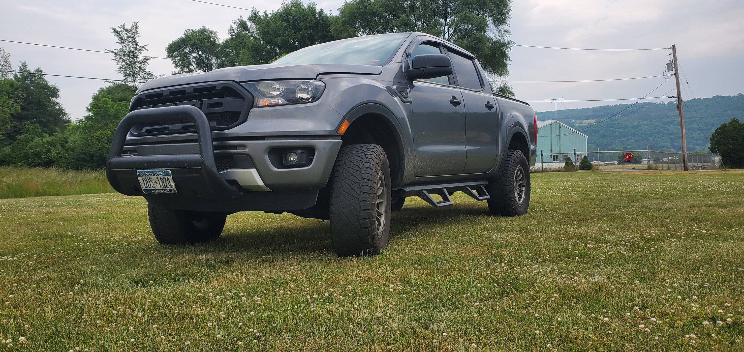

as you can see from the wear, next time I am going with WildPeak!
didnt remove anything
