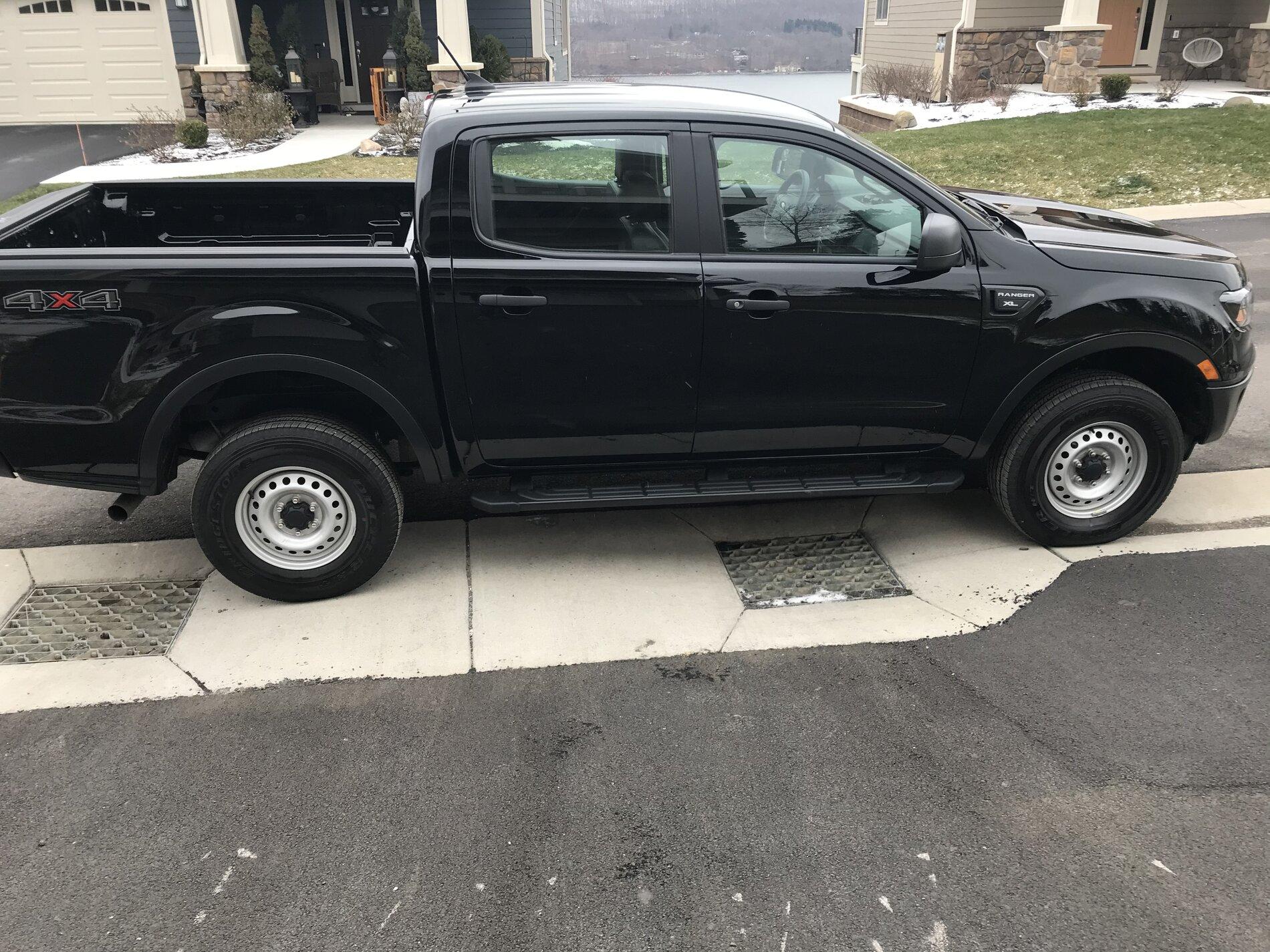

Ok everybody, bought a 2020 Ford Ranger XL and it’s my first truck. I can’t tell you how happy I am with the truck... it’s my first brand new vehicle and I’m on a pink cloud right now.
It’s the truck I wanted but not the wheels I wanted. So I’m attempting to order some new wheels instead of the steel ones. I want to order new wheels but want to keep the same tires.
Don't judge me haha, but all of the measurements and offset, etc. is really making me paranoid about purchasing ones that will fit these tires. My tires are 255 70 R16. Can someone please point me in the right direction on what wheels will fit these tires? Obviously they have to be 16”, and ones that would fit the model, but is that all I would need to know? Thanks everybody for the help! Awesome forum here.

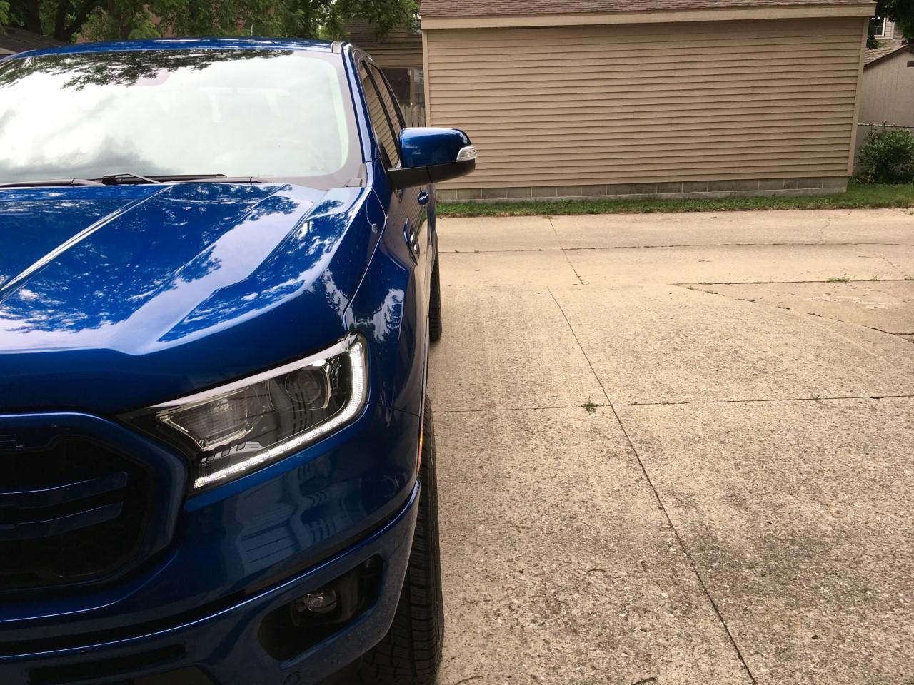

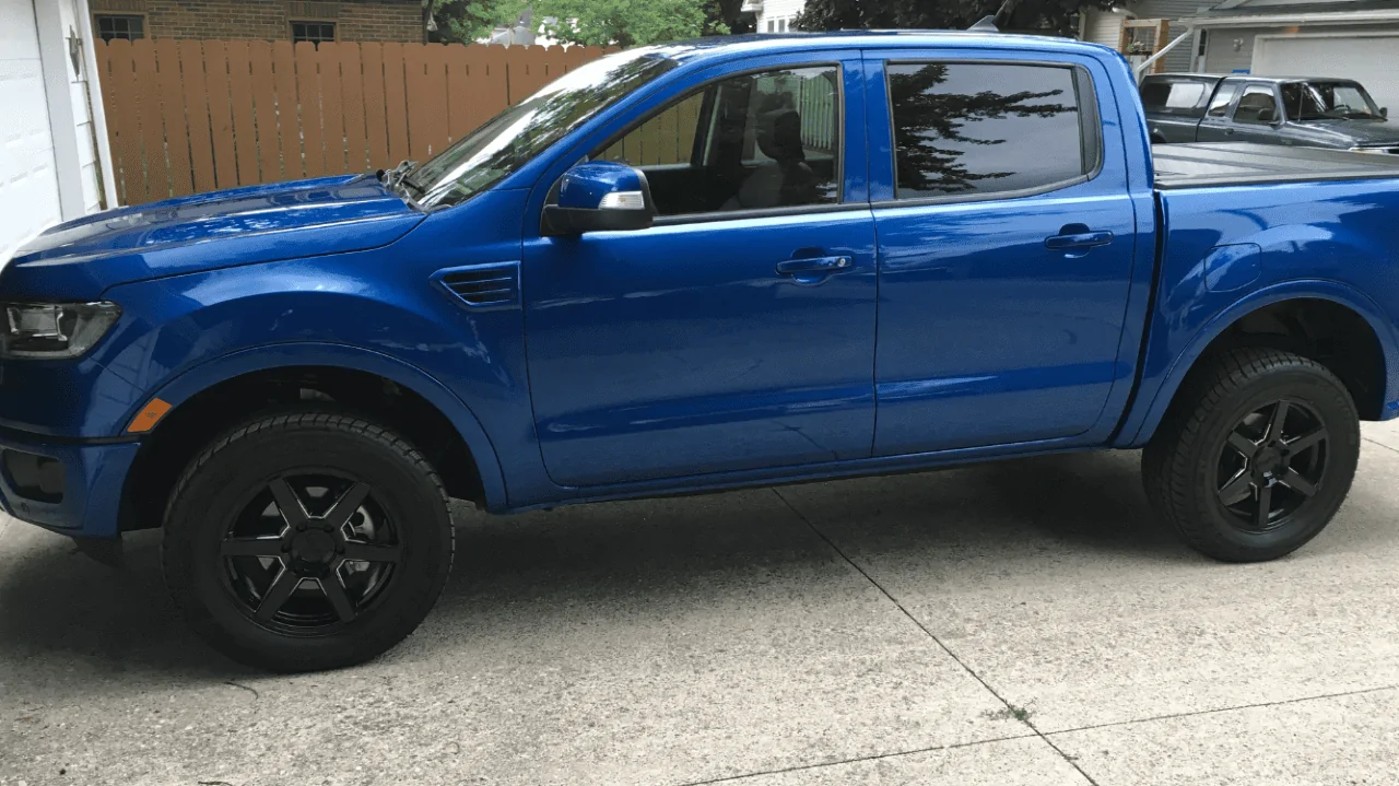

Here is a pic of mine with +35 offset. It's only ~3/4" difference, but the tires are now almost flush with the fender vs being slightly tucked in. You can go with any of the stock sizes of tires and wheels that our trucks come with from the factory without having to worry about correcting the speedometer.
