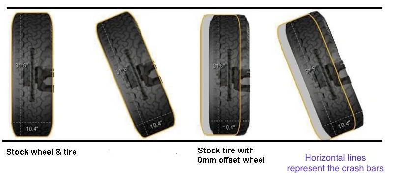

Wow without sticking a flare over them to cover what was sticking out, those wheels would get you a ticket in every state and territory in Australia. Not to mention making a hell of a mess up the side of your truck in the mud. I'd also worry about the increased leverage on things like the wheel bearings and spindle.

You have more than my combined offset...you will need a set of flares, lift to at least 2.5" and get rid of both front and rear bars...
