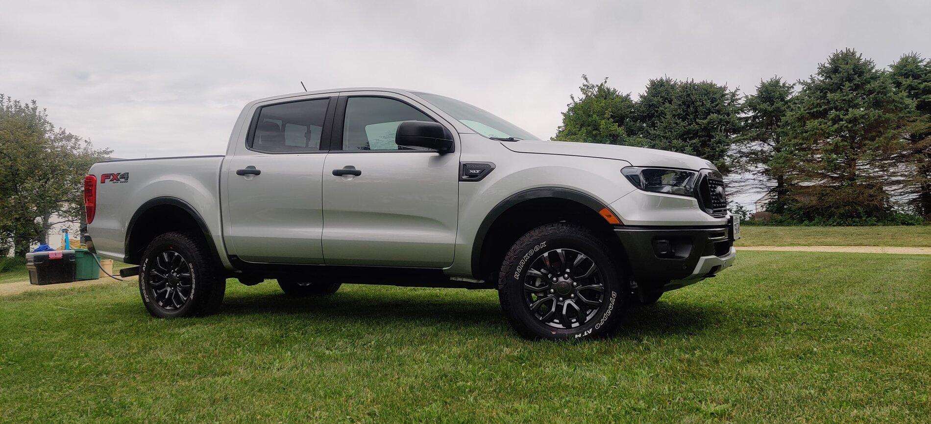

I have the Bushwacker covers and can say that the install is pretty easy. Peeling the film off the tape was kind of a pita but nothing terrible. This isn't the greatest picture but you can see where the pinch weld is hidden. The covers are tapped directly to the pinch welds. They have held up really well through my first winter with the truck. I did drill some small holes in the bottom of the covers in case of water getting in there and applied a small bead of RTV silicone to the all the seams (basically unnoticeable). I honestly don't think water will ever get in there if the tape is installed properly and the holes are probably unnecessary.

Chris,
Thanks for the picture and the great tips on installation. This helps me a lot with my decision. Your truck looks great!

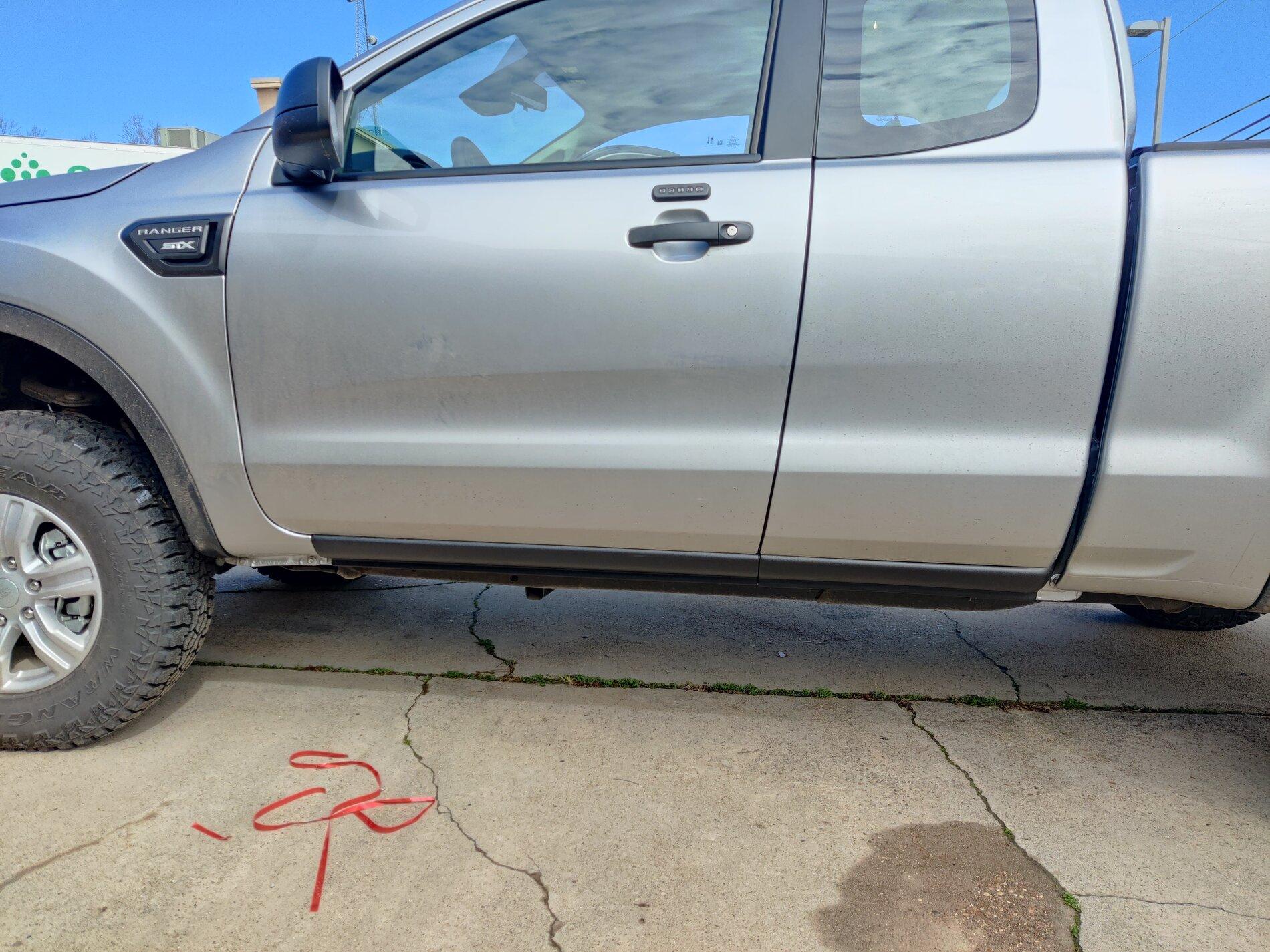

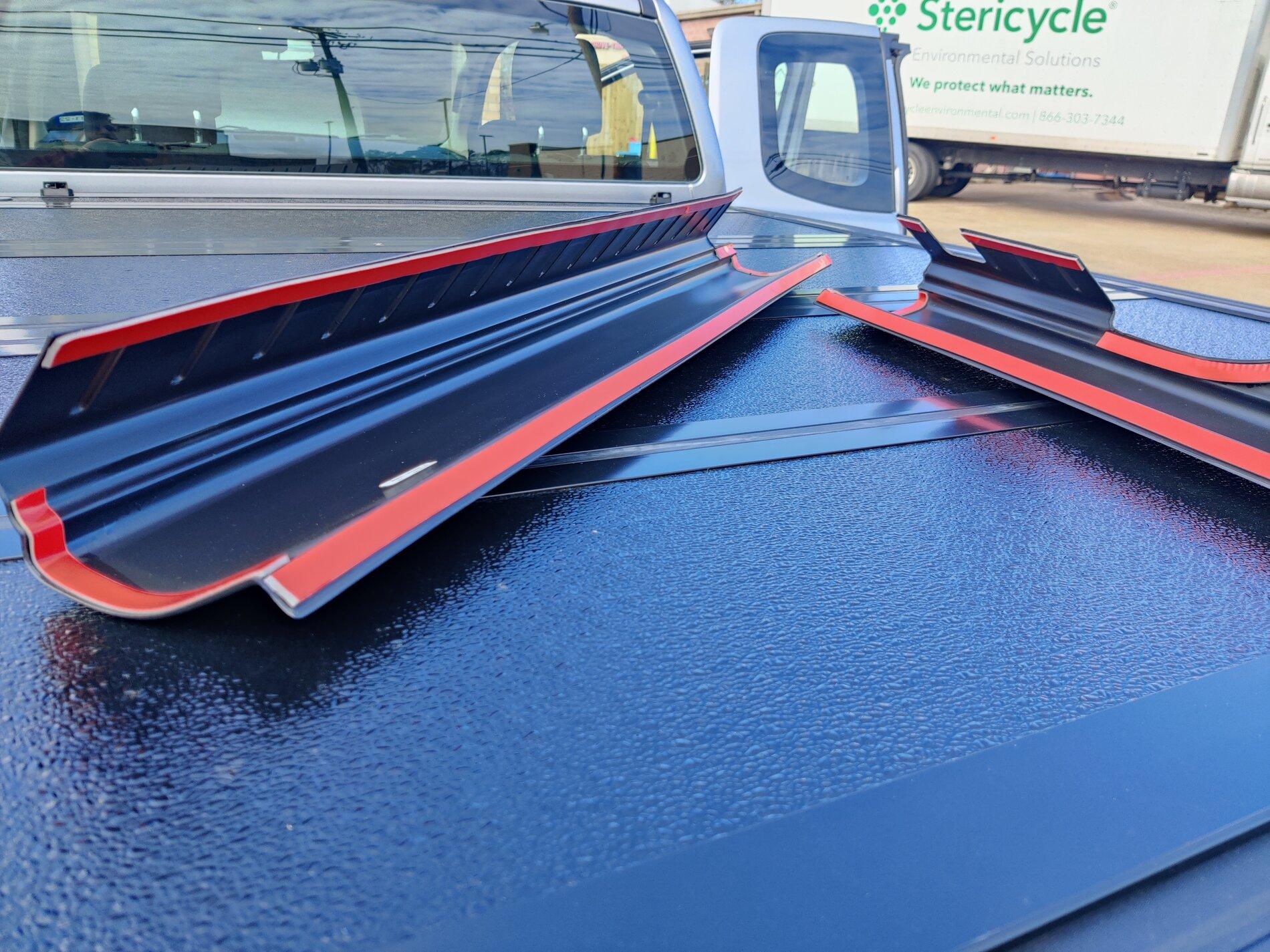

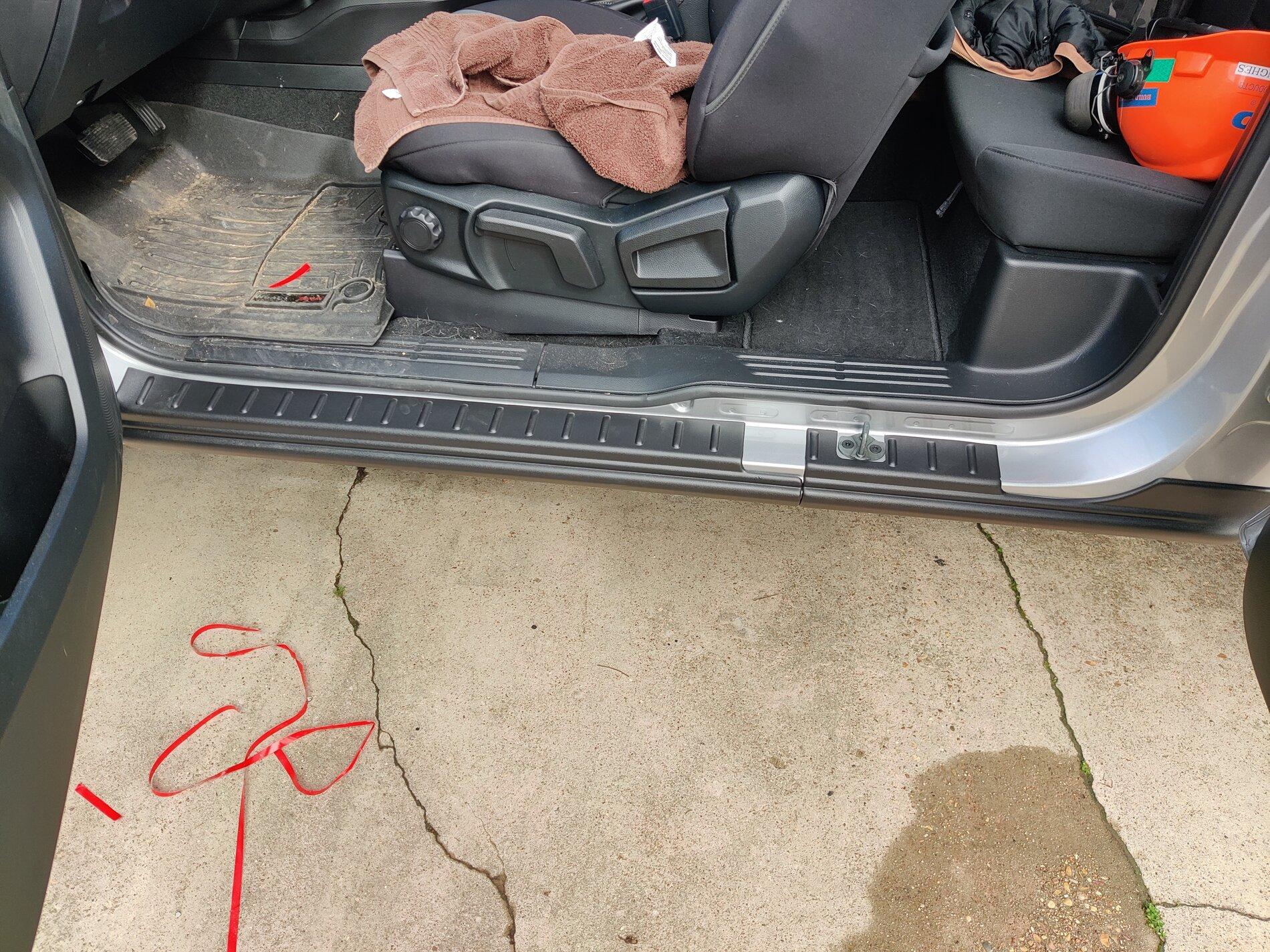

I installed my free bushwackers..
There is a gap between the front panel and the rear panel, but it lines up with thr door gap.
I wish they kicked up the front fender like they do on the rear.
My passenger rear cab corner panel needed a little heat to help soften the plastic to get curve to fit right.
There is a couple spots on the pinch weld that either need to be hammered flat or file the gaurds to fit.
I like the coverage. Time will tell how well they will hold up.. i expect to have to add more trim tape at some point

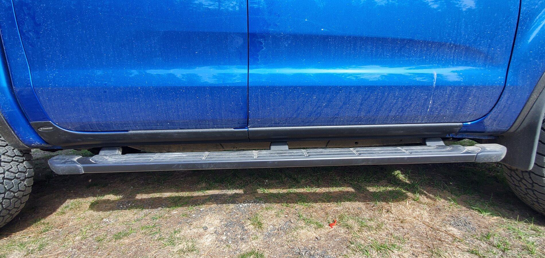

I got the Ford version. I had difficulty getting them tight enough for the pinch seam tape to stick but they are not going anywhere. On to the pics:
Nice job. Good to see on the super cab. Thanks!

I installed my Bushwacker trail armor last weekend. The reason you have a gap between the front and rear is that you installed the fronts first. Do not follow the junk instructions. Start with the rears 1st, then you can slide the fronts back to tighten up that gap. Mine turned out flawless. Got the full set off Amazon for my SuperCrew for $159.
