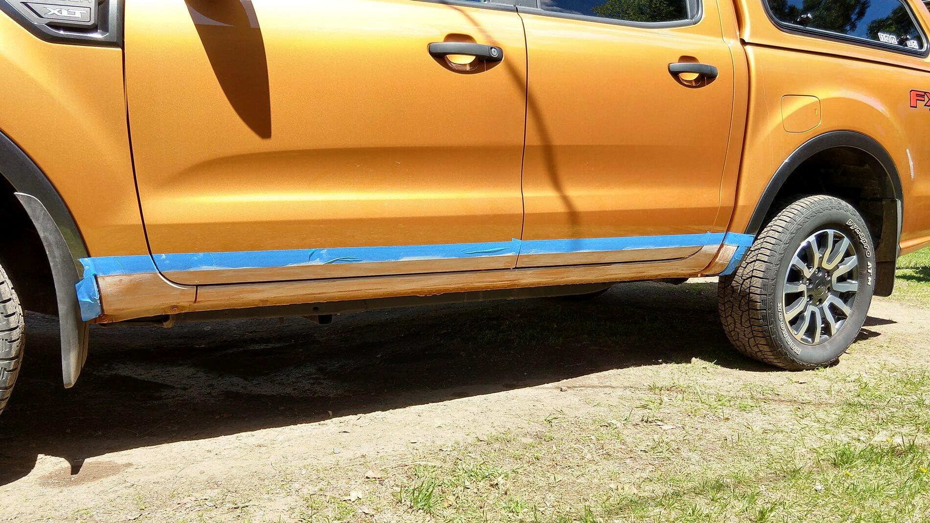

I'll try and reignite this thread by asking if anyone has tried doing some bedliner (or the like) protection along their rocker panels? This is an area that always starts to rust so soon, and just happens to also be an area where American auto makers usually think they don't need protection (one of my biggest issues and frustrations). Anyways, I was wondering if anyone has done this since this thread was started. I have the magnetic sport trim, so a dark gray application would hopefully match better and look less out of place than the usual black.

I ended up doing it a couple months ago. Didn't color match the saber, but rather attempted to color match the magnetic sport trim. Definitely very happy with the results!
J Wilson
jack
Oct 6, 2019
52
What color and what brand of paint did you use?

I have mudflaps as well and they only do so much. Had planned on putting running boards on as well to protect even more, still might haven't decided yet, but I wanted to put the bedliner on first. Because I'd have to take them off to do this work anyways.
I was hoping there would be something better out there available, but the Bushwacker covers will end up being worse in the long run like you mentioned. Every vehicle I've ever owned without built in protection has started rusting from the rocker panels within the first half dozen years. So in my mind, what I did seems like the best, if not only, good option without having to repair it every single year. That's what I had to do with my Focus and it was a lot of work, especially since it's the same exact work in the same spot every year. And after awhile it became so extensive I just couldn't keep up. I'm really hoping what I did to mine will at least give me a few extra years. Especially for less than $100 for the whole thing.
