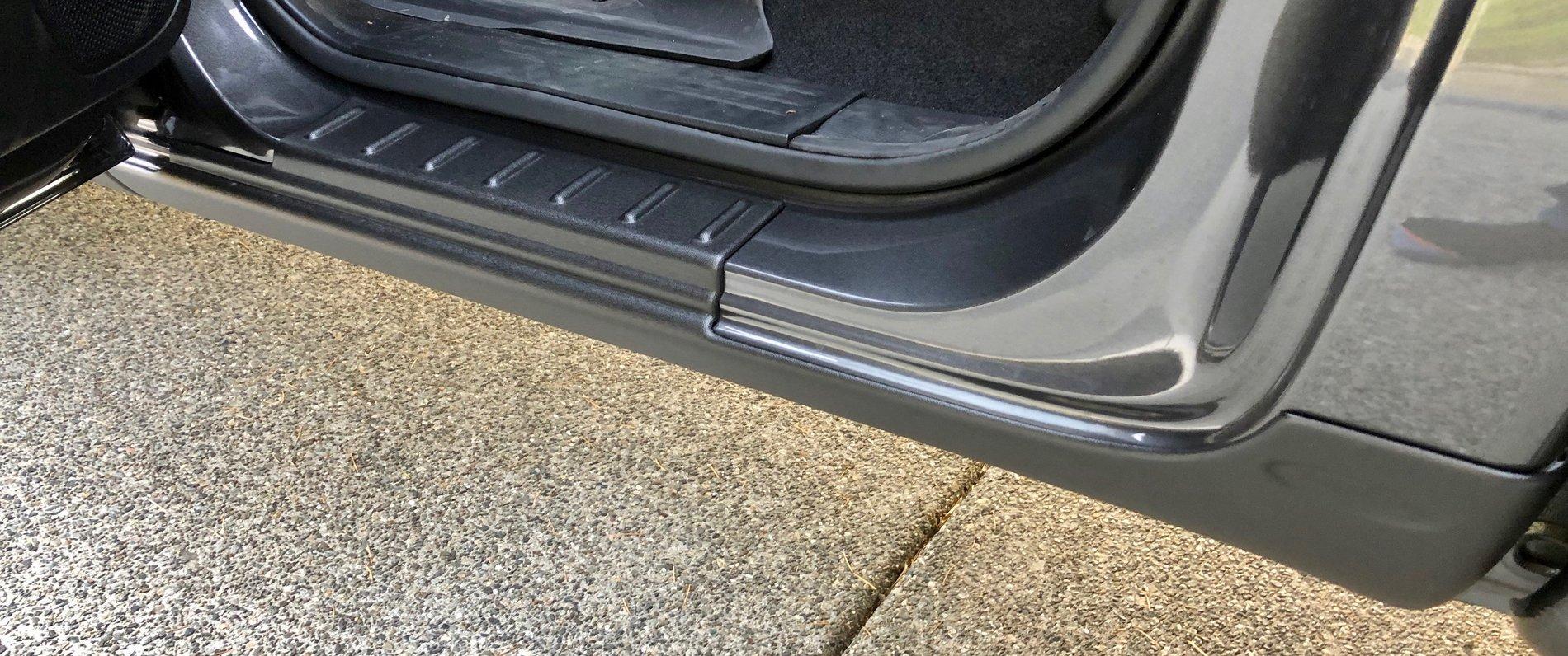

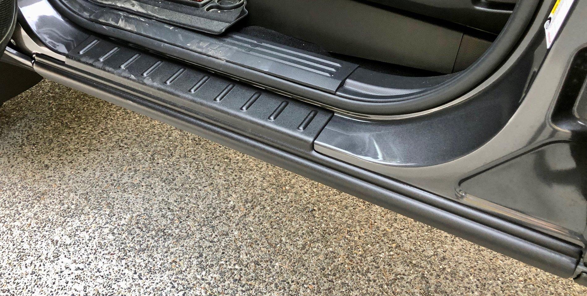

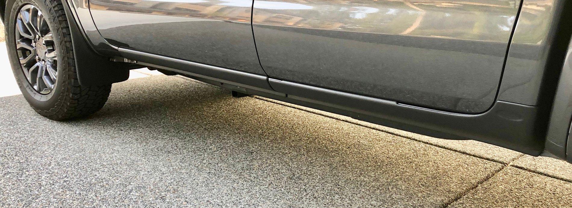

Got the Bushwacker Trail Armor on Friday and installed over the weekend. These are also listed in the Ford Accessories catalog...but my dealer said they are not yet available through them.
Trail Armor wraps around the underside of rocker panels...hard to see in the pix.
Four parts with pre-placed double-sided tape. If you get these, follow the instructions, as the tape cover needs to be peeled back part way in multiple places before you install. Tape covers also need to be pulled off in numerical order as you do the final placement.

Any worries about retaining water ? If they don't already have them, I would probably drill some 3/16" holes along the bottom side.

Any regrets getting these? Do you have any concerns with dirt and moisture collecting inside the rocker portion and being difficult to flush out?

I've had mine a couple of months now and don't see any issues with crap collecting underneath. After a long dusty offroad trip everything seemed to wash off fine.

Looks like they don't cover all the way to the front fender, nor do they cover the bed portion like Todd was saying. Seems like it'd be nice if they went all the way.
I was actually thinking of doing a bedliner type protection for my rocker panels. Be more expensive I'm sure, but wouldn't allow water/debris/salt to be trapped inside and would cover up/protect any damage/scratched/chips that I've already incurred. Still trying to think it over though.

Just for the cab eh?, I find the lower front of the box takes the majority if abuse from gravel roads, wish they had something similar to put on there.
I'd go to a shop that installs the Clear Film protection and have them custom cut some pieces to fit the front of the box edge. That stuff protects well and wouldn't break the bank.

not sure about yours, my truck has spray on bedliner type material but same color as the truck along the bottom of the panels. Seems pretty tough. As for the ppl worried about these holding debris, A bead of good silicone around the inside edge when installing would prevent that.

I do have that sort of protection along the bottom of the rocker panel, but I'd like if it went up around the radius further and basically to the bottom of the doors. Since I've already noticed some chips in the paint in that area. And I do have mudflaps on. I think I just want to get as much protection as I can since I have dealt with rust a lot (living in Michigan and now Minnesota, both high salt using states) and want to keep this truck for a long time.
I agree that a bead of silicon would probably work just fine. But I still want to panel to run the full length fore/aft and cover the bed portion too.
